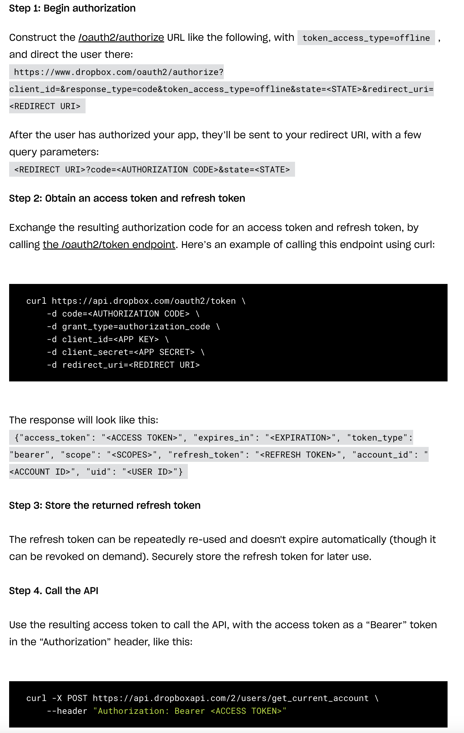

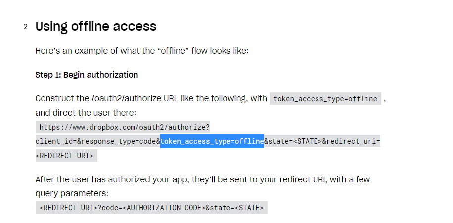

From Dropbox: "Apps can still get long-term access by requesting "offline" access though, in which case the app receives a "refresh token" that can be used to retrieve new short-lived access tokens as needed"

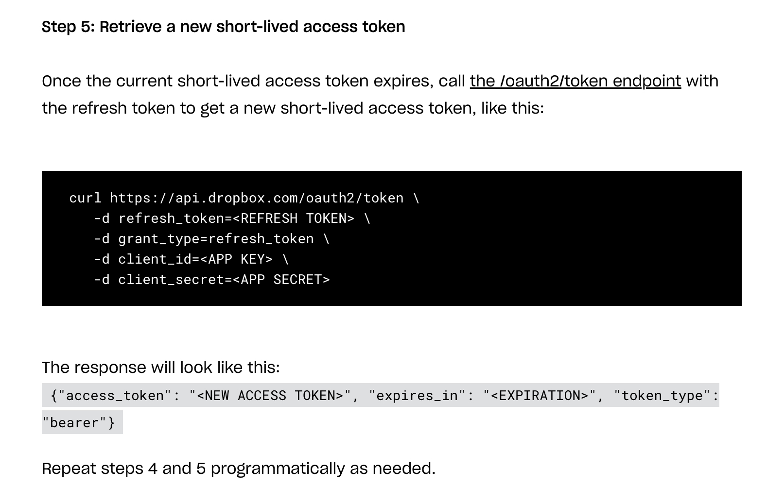

7. Retrieve a new short-lived access token whenever needed like this, e.g., using curl on the command line: (plug in the refresh token from step 5 in place of "REFRESHTOKENHERE", the app key in place of "APPKEYHERE", and the app secret in place of "APPSECRETHERE")
curl https://api.dropbox.com/oauth2/token \
-d refresh_token=REFRESHTOKENHERE \
-d grant_type=refresh_token \
-d client_id=APPKEYHERE \
-d client_secret=APPSECRETHERE
8. Use the returned short-lived access token to make API calls until it expires. For example, here's how a call to get the connected user information would look like: (plug in the new access token from step 7 in place of "ACCESSTOKENHERE")
curl -X POST https://api.dropboxapi.com/2/users/get_current_account \
--header "Authorization: Bearer ACCESSTOKENHERE"

However is there a way for PABBLY to handle getting the refreshed token or is there a better way to achieve this?
You can refer to the following developer's guide on how you can manage the refresh token in your integration.

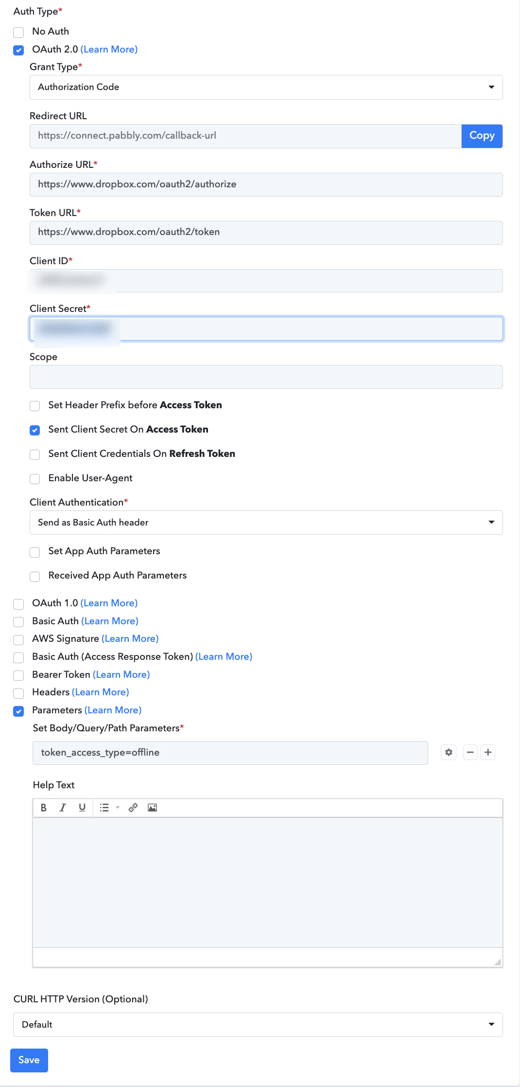

Hello - so I do have this all working - and it does work and correctly uploads the text file to dropbox. But then it tells us after a few hours that it has expired.
"error_summary": "expired_access_token/...",
"error > .tag": "expired_access_token"
If we reconnect it works again - but I'm pretty sure this has to do with dropbox requiring the 'app' to request a short-lived access token?
So I'm guessing our app will need to request a refresh token and store that as part of a step - and then use that as the bearer token for the actual task?
I have attached how I have it setup right now - any advice would be appreciated!

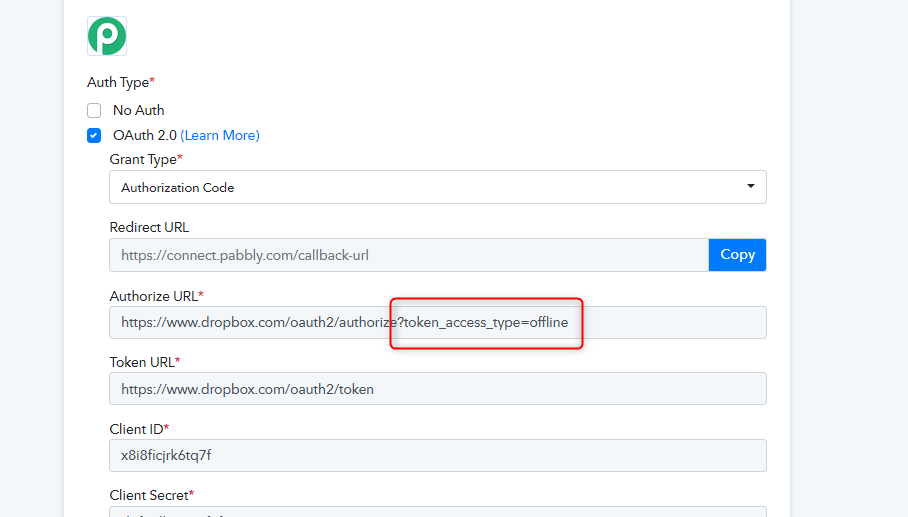

Hey @MasterMagic!
You need not have to pass the "token_access_type=offline" in the Parameter field instead of this kindly pass the query parameter in the Authorize URL field itself.

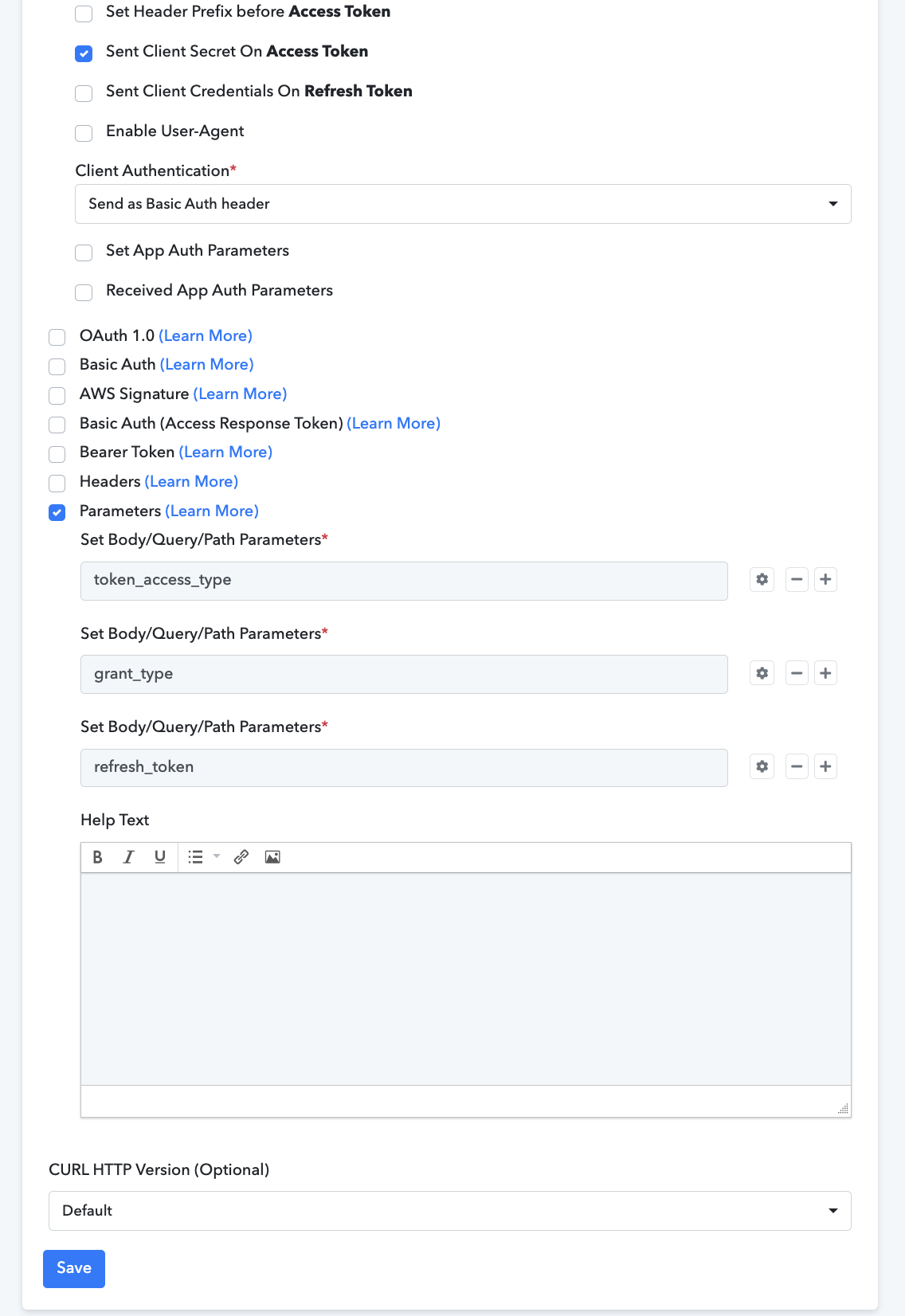

Thanks - I totally forgot I had actually tried this too. Here is my last attempt... That also did not seem to stay permanent... I also tried passing parameters for this:
token_access_type
grant_type
refresh_token
It all takes but then still shows as expired after 4 hours.

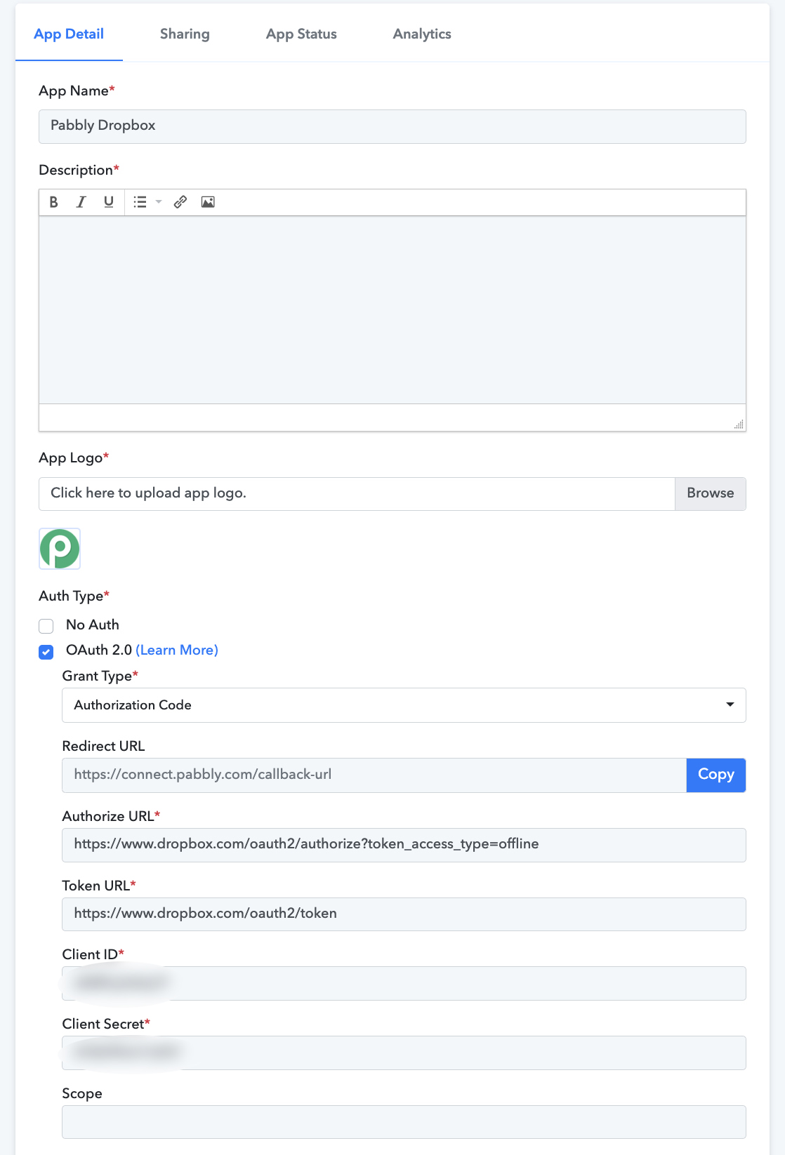

Supreme
Hey @MasterMagic
We have made a slight change from our end and it should work now. Also, make sure you are using a new connection to use the application.
