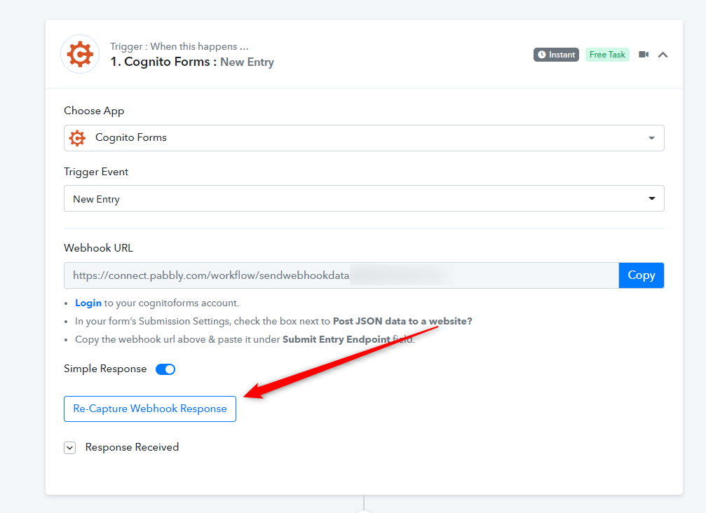

If you feel that your Webhook trigger is not capturing the webhook data from your form then kindly re-capture the webhook response once and then try again.

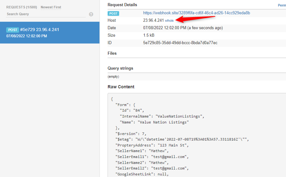

Here is the easy way to find the issue, whether it is from pabbly connect side or cognito forms -
Basically if you're not receiving data on webhook.site's webhook URL also, then issue is from form builder. But if you are receiving data on webhook.site's webhook URL then issue is on pabbly side.
mtorres6739

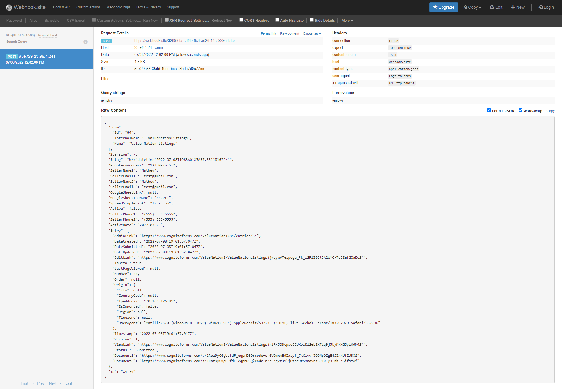

yes, I ran a test and webhook.site is receive the webhook, but pabbly is not.

We have whitelisted the IP address 23.96.4.241 as shown in your webhook.site screenshot.
If you can contact CognitoForms forms and ask if they have any other IP sending the webhooks, we can whitelist the IP address at our end.
mtorres6739
This worked! Thank you VERY much for your help. I am reaching out to cognito forms to see if there are any other IP addresses they are using. Thank you again for your help!
