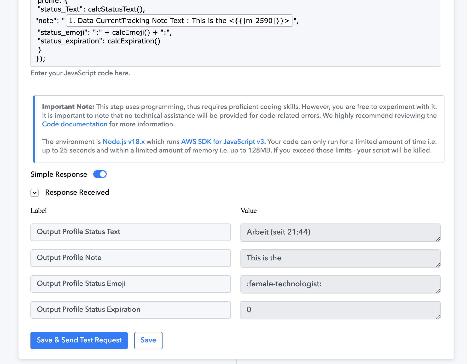

I've searched for similar problems but it didn't come up with anything. Here's the thing: I get back an API response with a string – literally it's "This is the <{{|m|2590|}}>".
When using this in Javascript code, it'll just blank it out.
- I've tried leaving out the quotes in the return statement – this fails.
- the issue is resolved if the string is "This is the {{|m|2590|}}", so I'm thinking it's the < and > here.

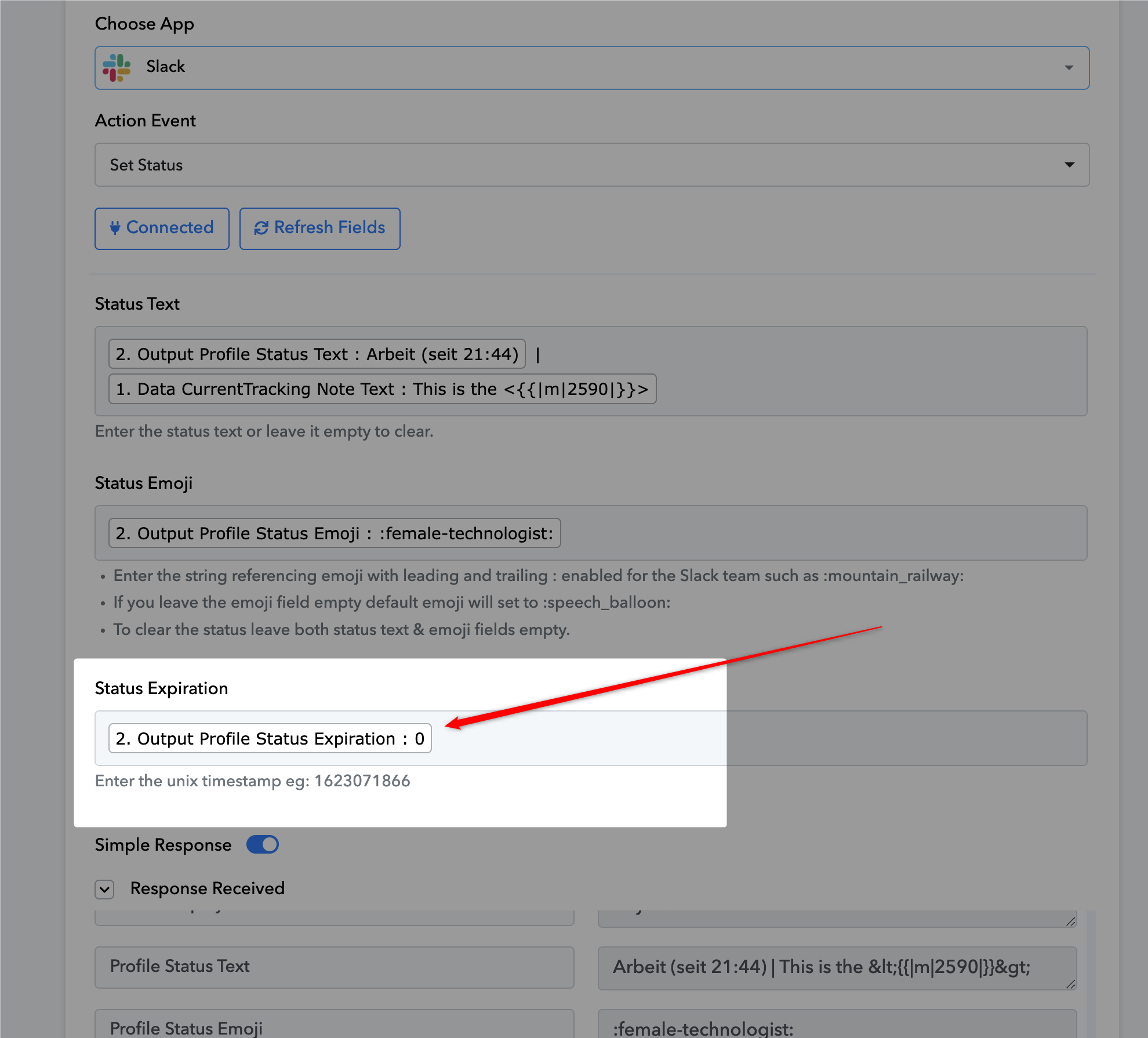

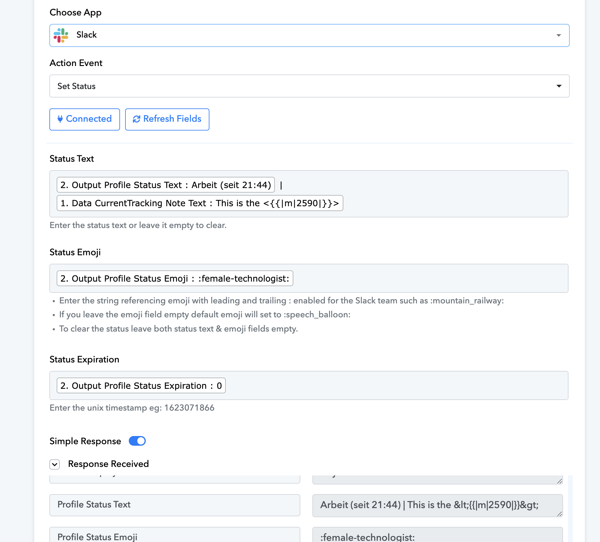

Further proving the point of the JavaScript module being the problem, here we have what happens if the value is passed as a field straight into another step:
As you can see in the line "Profile Status Text", it renders as "This is the &It;{{|m|2590|}}&gt;".

Further, in the "Set Status" action step kindly pass the time in the timestamp format.
I'm kindly pointing you towards the Slack documentation where a non-expiring status is set by passing 0.

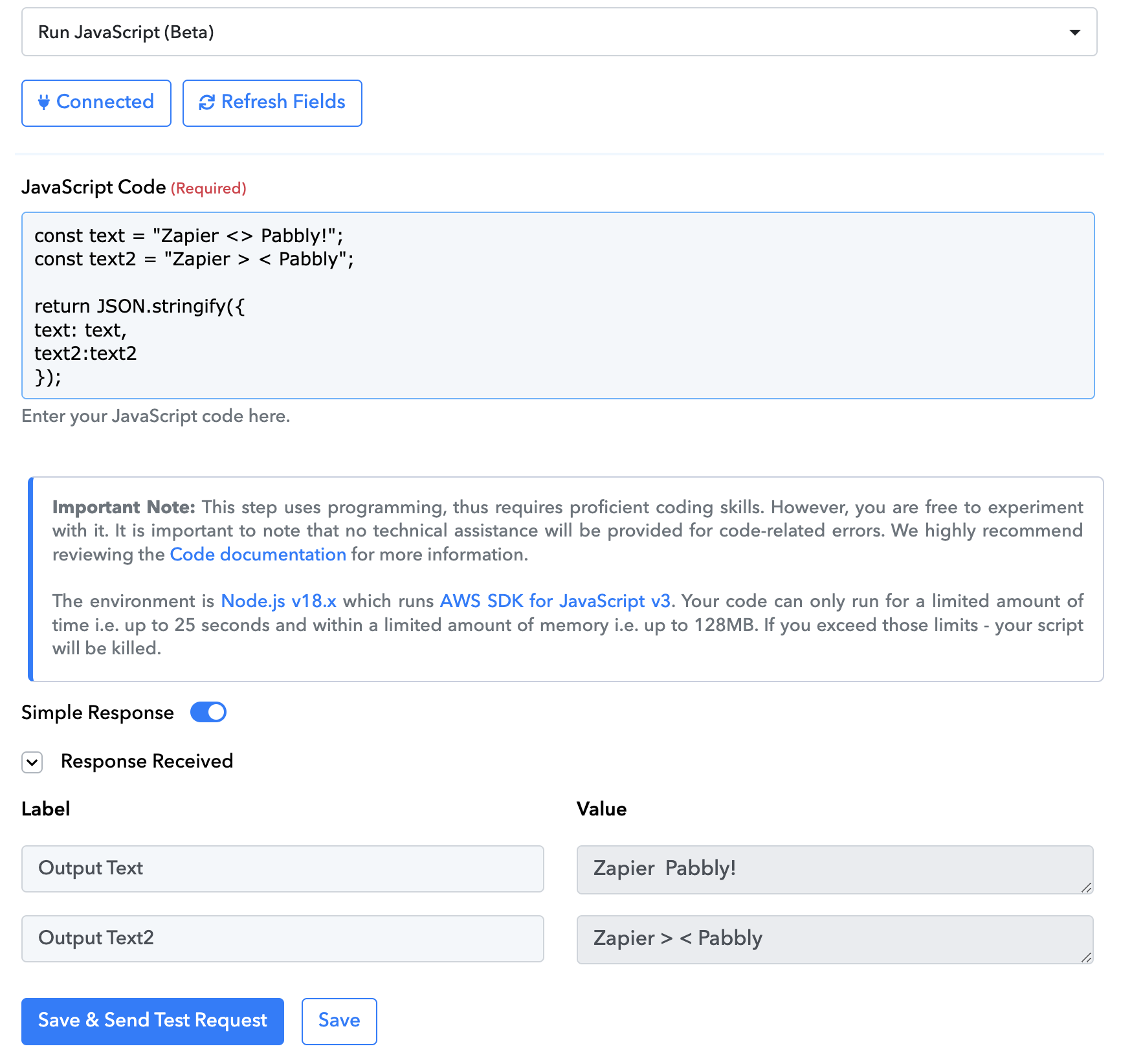

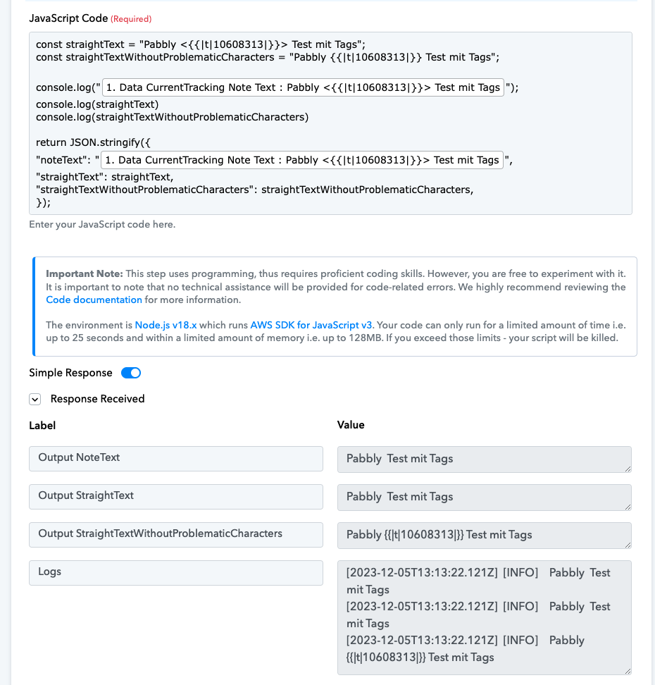

Here's the isolated problem: even if you have straight text, everything between <> gets filtered out by the JavaScript code module, even though this behaviour cannot be replicated when running it otherwise in NodeJS. I can't replace the < and > either, because as soon as it's in the module, there seems to be some value processing that prevents it from being treated as straight text.
JavaScript:
const straightText = "Pabbly <{{|t|10608313|}}> Test mit Tags";
const straightTextWithoutProblematicCharacters = "Pabbly {{|t|10608313|}} Test mit Tags";
console.log("1. Data CurrentTracking Note Text : Pabbly <{{|t|10608313|}}> Test mit Tags");
console.log(straightText)
console.log(straightTextWithoutProblematicCharacters)
return JSON.stringify({
"noteText": "1. Data CurrentTracking Note Text : Pabbly <{{|t|10608313|}}> Test mit Tags",
"straightText": straightText,
"straightTextWithoutProblematicCharacters": straightTextWithoutProblematicCharacters,
Addition: I'm aware that the fields have to be sanitized for HTML tags before use in code. However, that's not a Html tag. Do I really have to run TWO replace-modules (one for < and one for >) so this clears?
