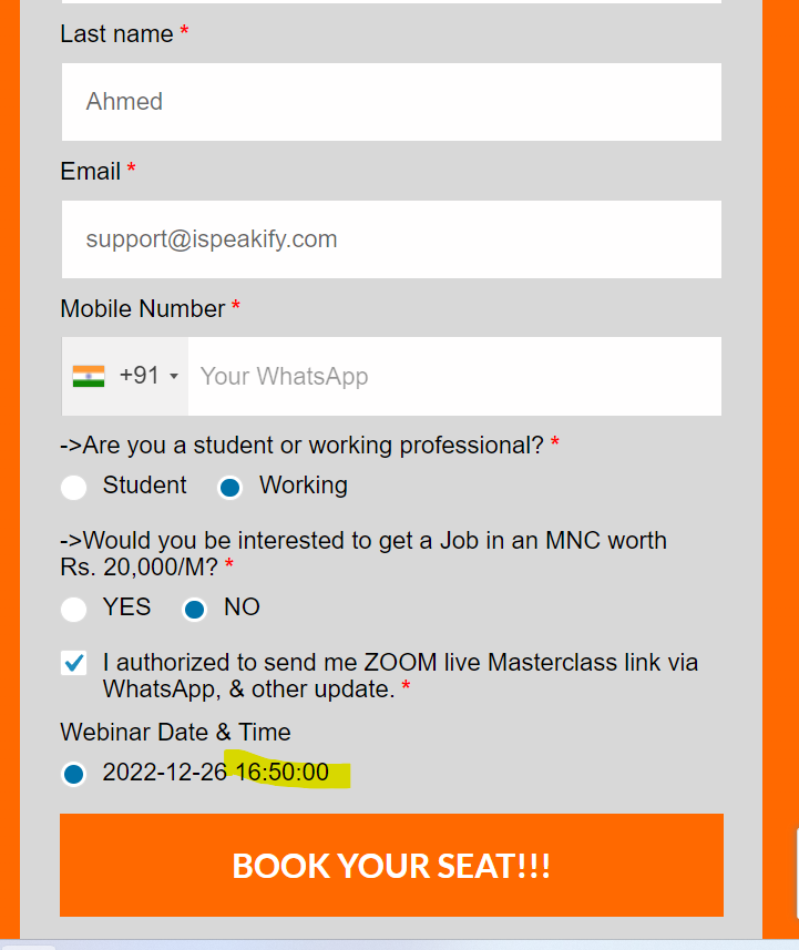

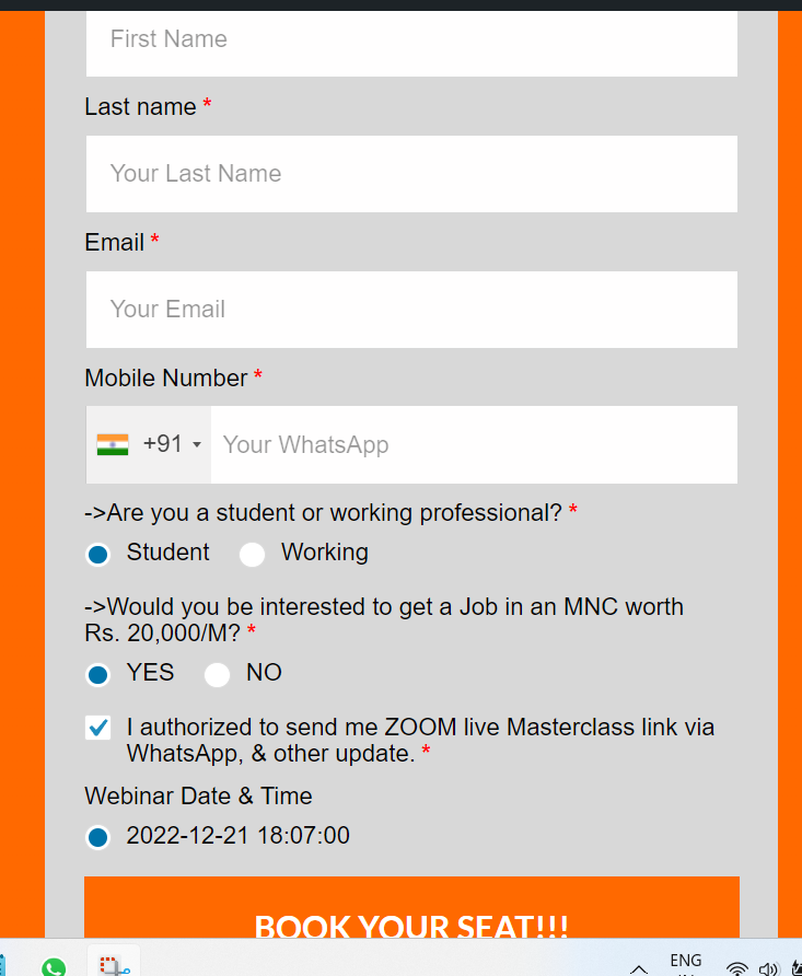

Thank you for sharing this video, I am able to do delay and sent whatsapp msg, but I am able to activate time based. Like webinar is 31 Dec 2022 4PM, so on that date based I need to run WA msg automation, I saw another video to do this found date formatter is used to changed date and -1 (A day before Meeting a msg is sent whats what I want), but my webinar date is coming optin form, and I have put extactly the right date formate there, I have shown in attachment. So what is the solution for that when I am already getting right format in webhook data transfer, let me if date fromatter substract/add is right option, but date is the issue , totally lost or suggest me if any other way.
Hey @zaheer1001
If you are getting the date time in UTC format in the trigger response then you can simply ignore the Time Formatter action step to change the timezone Before the Delay Until action step.

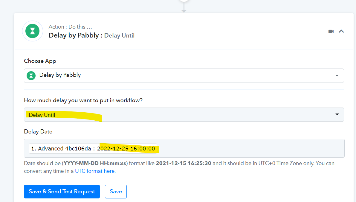

Yeah, that's what i did but it not giving me and option trigger msg before 3 days, 2 days, 1 one day, how to set this up, I already mentioned that I am able to run delayed automation, but delayed automation as per date of webinar. Hope I am clear that I am not asking how to delay but delay as per perticular date. an only delay section is not showing or I am not able to do, how to set up 1 day before 2 days like that.
zaheer1001
Kinldy look at the attachment... showing delay until date and date is selected, what how to trigger msg 1 day before.
Hey @zaheer1001
To send set the date time in the Delay until 1 day before then kindly use the "Add/Subtract Time" action step first then pass the converted time in the Delay Until.
Ensure that the DateTime is in the UTC format.

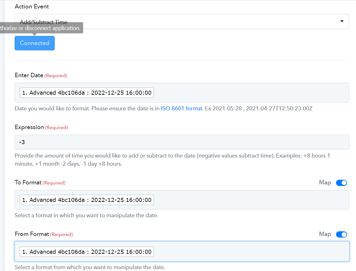

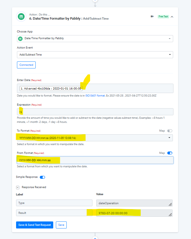

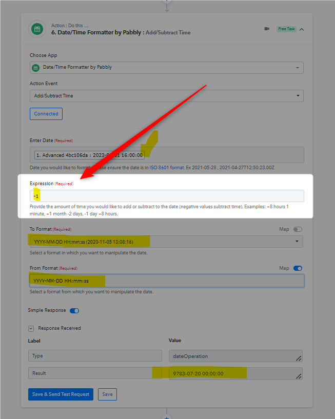

I exactly used the same things shown in images, but why my reslut is diffrent, Can you plzzz suggest the best why it happned. See the attchment for review.
Hey @zaheer1001
Please pass the correct expression on the "Add/Subtract Time" action step as mentioned in the help text and then try again.
zaheer1001
Thanks for this information, it worked, however I set delay as per time, but I notice that when form is summited all all whatsapp delayed are being fired, including Instant msg. I think it required conditional too to stop this, what you do suggest how. make this fire as instructed. Plzz help me very important. Thanks for bringing me til here it is a big success to me just because of your help...

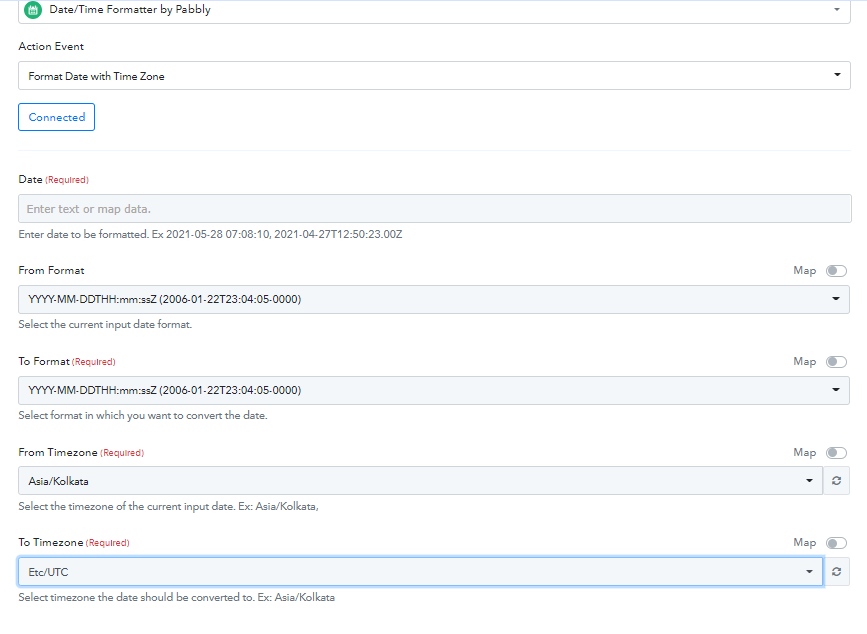

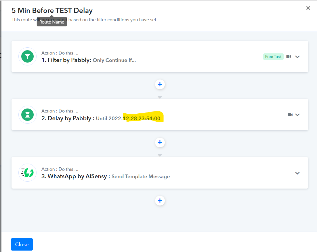

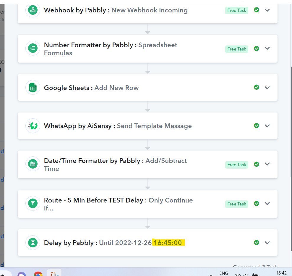

Hi @Supreme, Finally I found one video, wherer after Date/time formatter Router is used, and I created the same formation, everything is working fine, like Time is getting substracted from Webinar date, then used router where used condition then delayed time is used then WA msg... all the data is is coming correctly top to down... but even WorkFlow ID showes Delay is 5 min from before... but not firing not sending WA msg... I don't know what's wrong only last sept is not working however last WA msg test is success in test and save last step is firing. Now it seems some Teach Glich earlier I was making mistake and using wrong things... It was -5 minute TEST Plzz have a look attachments. How i did and FlowID is ---
As we have already stated that you need to pass the DateTime in the UTC format but as we can see form your workflow you are still passing the datetime in the IST format.
Please convert the time with the "Format Date with TimeZone" action step.
zaheer1001
Thank you!!! Thank you!!! Thank you!!! Thank you!!! Thank you!!! Thank you!!! Thank you!!! Finally I got the result I wanted to. Thanks.

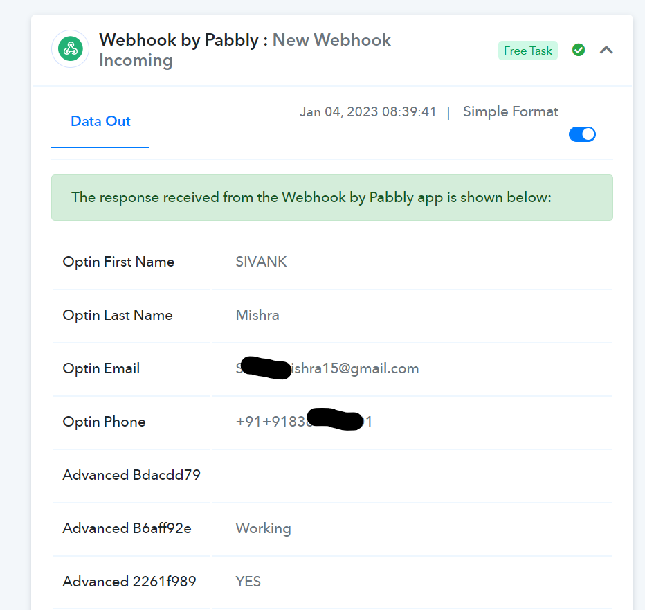

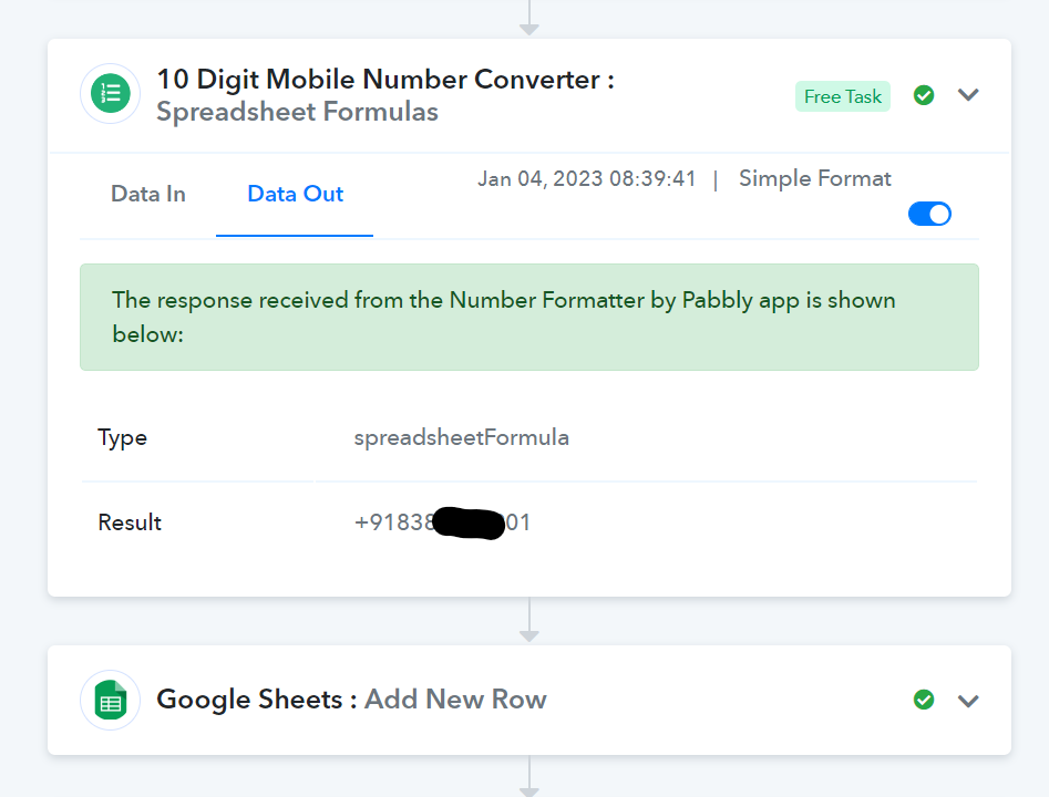

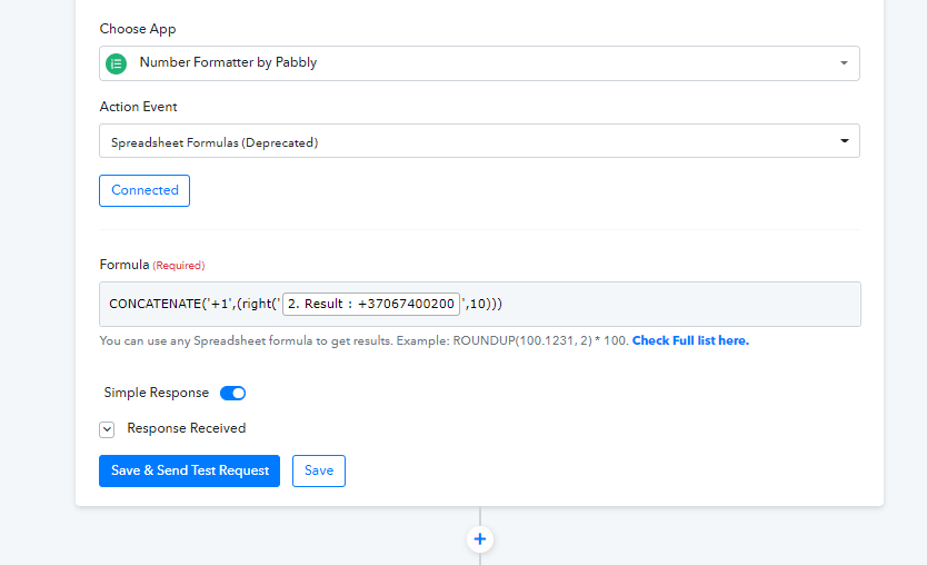

Question#1 - I am using Number formatter formula this to get only 10 digits mobile number that is coming form my optin, how ever in optin 11 nunber cannot be accepted, still 91+10 digits are allowed, (on the hand by defalut option is adding +91,). let's say if some one is typing only 10 digits number and by default +91 is added so I am able to remove +91 Using the formula this Spreadsheet formula in pabbly nummber formatter
(RIGHT('webhook Mobile Number result',LEN('webhook Mobile Number result')-3), but if someone put 91+10 digits then it becomes +91+91+10 digits, this formula removes first +91 and send the data in google sheet like 91+10 digits, however i want only 10 digits in this case Text Msgs are failed it only works on 10 digits number in workflow automation. Hope you understand what I mean. So is there any other fromulat that can work.
zaheer1001
Below given ex of whne someone type 91+10digits, but optin already ad +91 so result comes like +91+91+10 digits, but formula only removes first +91 and keep second +91 in number hence Text Msg failed

Hey @zaheer1001
Regarding your concern, you can use the "Number formatted" action step to control the phone number in live execution to limit the number of digits.
