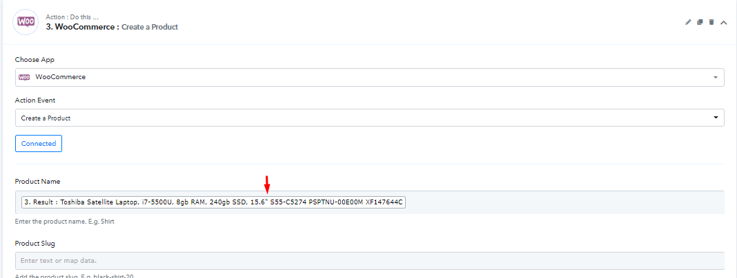

Hi, I have a task that creates a woocommerce product. It did work fine before with the deprecated woocommerce connection. I have replaced it with the new woocommerce connection, and it fails to create the product. please see task
IjU3NjYwNTZmMDYzMjA0MzE1MjY0NTUzNTUxMzE1MTYyNTQzMSI_3D_pc
Before, i did have this and i solved it by using the text formatter to do an Html to markdown process on the title and the desciption and this worked fine. but for some reason either the new connection app is a bit different or i have messed up something. thanks!

On checking upon workflow, for "WooCommerce : Create a Product" step, we can see that the quotes was breaking the structure, which you have mapped-
So, we have corrected this issue for you and now it is working.
Kindly check on it and let us know if this works for you now.
dataforge
fyi, what you did worked, but what I think you did was put in a text replacement and changed the " to <blank>. This removes the " which is not good as the text does need the " in it. So I changed the text replacement to be from " to \" and this seems to have worked, and it also keeps the " in the text.
