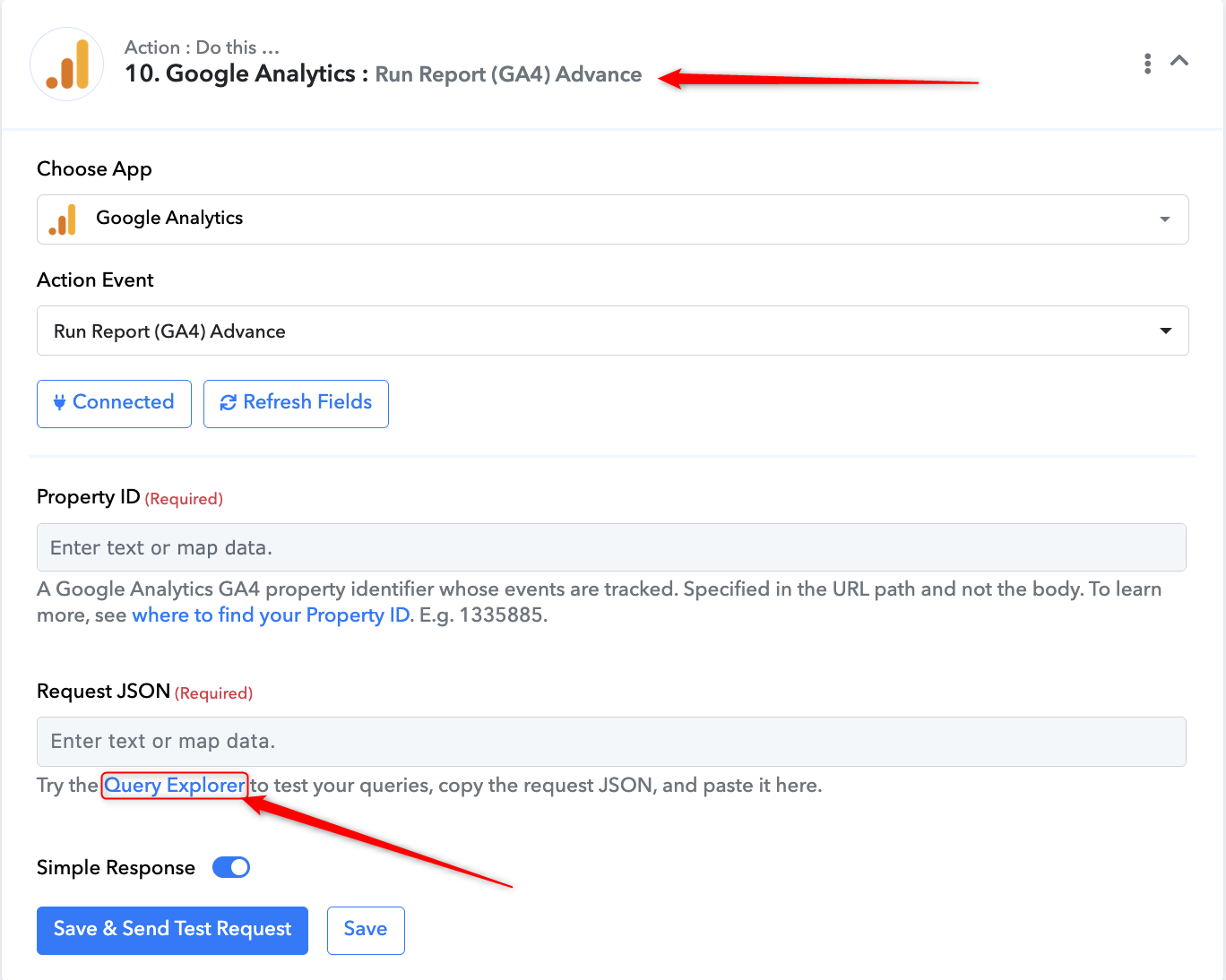

Soumya Tripathi — Reply ·
You can refer to the video at
youtube.com/watch v=jpAierpnPw0
, starting from the 5:00 minute mark. It will help you configure the "Google Analytics: Run Report (GA4)" action step.
If this doesn’t resolve your concern, please let us know the specific issue you're facing — we’ll be happy to assist you further.
Hello @serwar24554
We are currently looking into whether it is possible to retrieve post-level metrics from Google Analytics and whether this use case can be achieved through the available options. Please allow us sometime.
