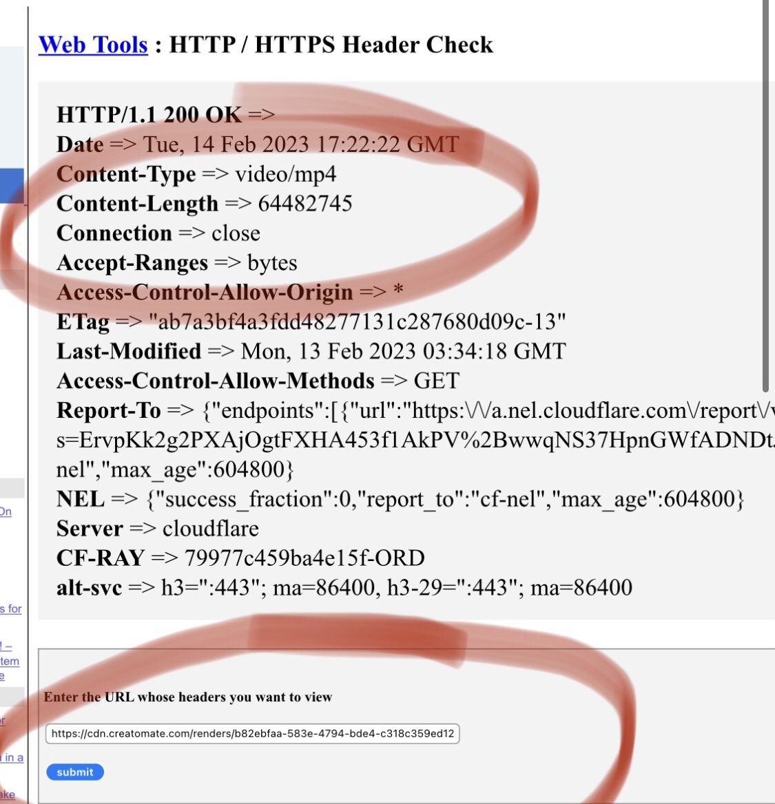

We’ve been over this before. I even included a link to the old conversation. The content length IS being sent with the URL. Why do you keep saying it isn’t?
Look at the header info right here. I can’t keep losing time waiting for a reply with no fix if you aren’t even checking things. Did you test the URL I shared to check if the content-length info was present or not? It is clearly present.

I just made a test workflow again. Same problem. Video URL headers definitely include Content-Length as shown above. Please fix this. It's only 64 MB not even close to 400MB.

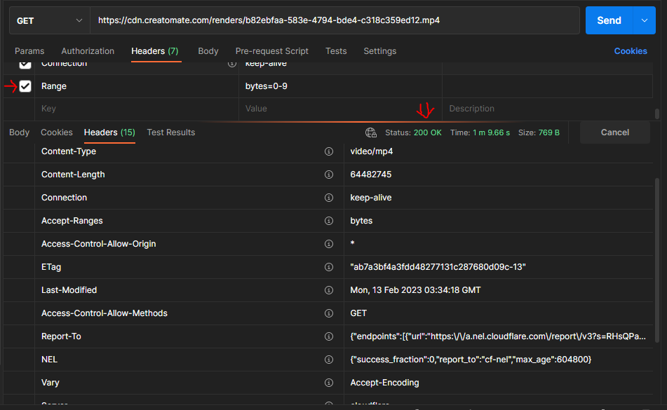

But, now we are noticing that a URL may not respond to request's "Content-Range" header even if it returns "Content-Length". This is what happening with cdn.creatomate.com domain. There is no workaround to make this kind of URLs compatible with part-by-part download.

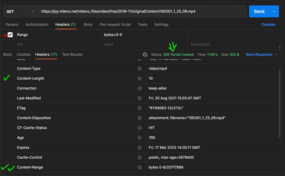

This is a sample video URL that will work for part by part download because it includes both the headers. Content-Length and Content-Range.
This will not work for part by part download because it does not have Content-Range header apart from Content-Length.
For large video uploads, Content-Range headers are also required in the headers of the file.
If Content-Range header is available when we make a GET request with "Range" header, our API will be able to upload large files.
