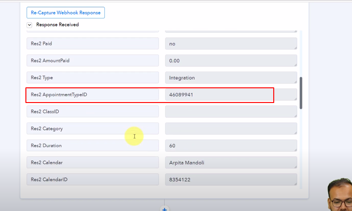

I can see that when I use Zapier I'm able to only have an automation run if it is a particular type of meeting.
Is there a way to do that same thing in pabbly?
For example:
When Client books follow up meeting type ONLY then Look up Lead in CJ and map the data from the meeting to that record in CJ.
Because you can have different forms with different types of meetings in Acuity the mapping is not always going to match what I've set up for an Intake meeting vs a Follow up meeting.
Fagun Shah
You can use filter as 2nd step with Appointment TypeId(you receive this in step 1, New Appointment trigger)
