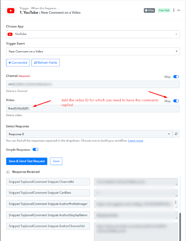

Hi, I am trying to automate replies to comments on my YouTube channel. The channel only consists of shorts. I can connect to the channel and detect a new video and then successfully post the link to my FB page. However, I cannot detect new comments on my channel, the response is always 0. Any help would be greatly appreciated.

Do make sure that the video which you have added to fetch the data for in the response has an existing comment in it.

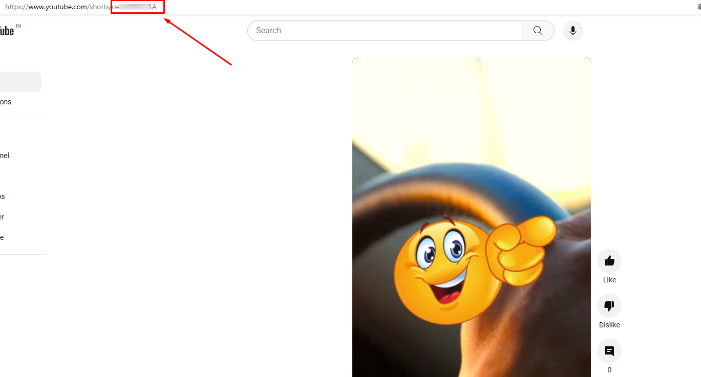

Hey @affex !
Kindly check on the image below-
You can get the video ID from the URL of the shorts you want to have the comments from-
This will work for you to get the response and then further you can proceed with the workflow setup.
Do check and let us know about it.

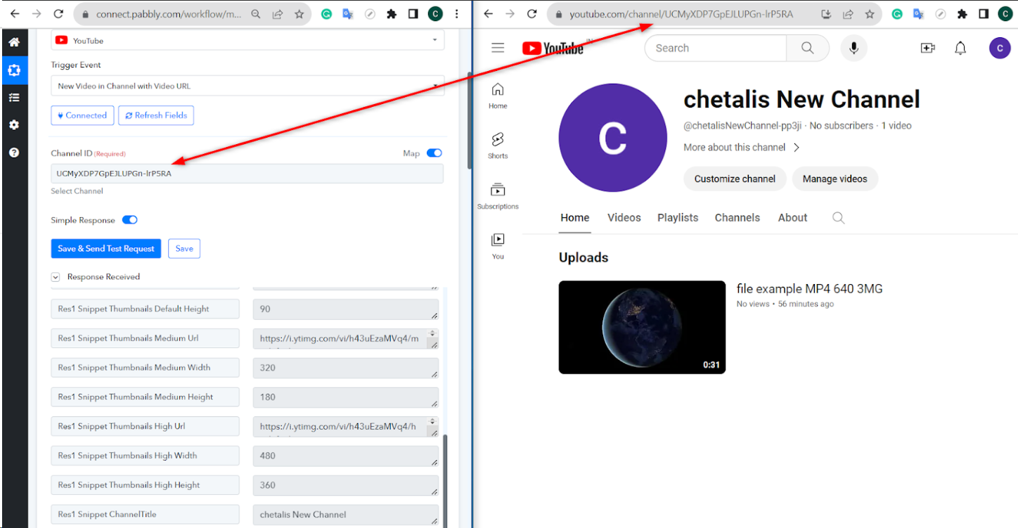

Hey @affex !
We have conducted thorough testing to replicate the reported error using a dummy YouTube account. During this testing, we created a new channel under the primary account, and it has come to our attention that YouTube does not permit the listing of this channel in the YouTube trigger event. To address this issue, we have identified a viable workaround. We recommend utilizing the YouTube connection associated with your primary account and mapping the respective channel ID from your Channel Page .-
This will help you to comment from your channel itself.
Kindly give it a try and see if this works for you.
