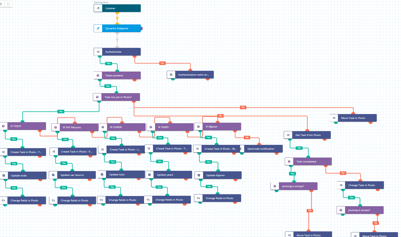

You mean something like this:
That would be great, but very hard to realize because its a main restructuring of the process. This is a workflow in Flexie, in Flexie I can drag actions. But all actions should be code manual.
In Pabbly fields are draggable. But yes, I would be very happy if something like this would be possible.

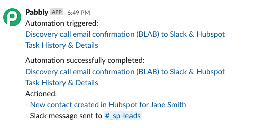

Ummm I guess.. essentially I'm looking for a way to do debugging with Pabbly..
The best way of doing this within the current limitations I think is to include:
  1. A step (e.g. confirmation message in Slack) immediately after the trigger that links to both the automation URL & the automation history URL
  2. A final step (e.g. another confirmation message in Slack) once an automation is completed which details which actions have been completed
Jonathan Baillie Strong — Reply ·
Here's an example:
