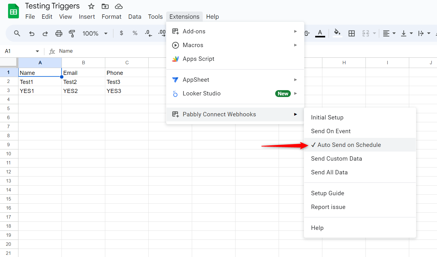

Enable "Auto send on schedule" in your Google sheet.
Please try enabling the 'Auto Send on Schedule' feature in your Google Sheets spreadsheet and see if that fixes your issue.
Note: If the data is added to your Google Sheets automatically, it may take upto 1 hour for your workflow to get triggered.

While setting up the Google Sheets, if you are getting the data from a third-party application then you might need to select "Auto Send On Schedule" and "Send on Schedule" which will take exactly 1 hour to forward it.

Yes, to reduce the trigger interval time from 1 hour to 1 minute, you'll need to add an App Script to your Google Sheet. This script will change the triggering frequency accordingly.
Please refer to the following threads to learn how to set up the App Script in your Google Sheet to trigger it every 1 minute:
Here is the App Script:
https://forum.pabbly.com/threads/google-sheets-1-minute-trigger.12927/
You can read this document to understand how you can add the app script to your Google Sheets.
https://forum.pabbly.com/threads/google-sheets-1-minute-trigger-send-new-rows-in-every-1-minute.12954/
I hope this can be helpful for you. Also, if you use this app script, remember to opt out of the "Send On Event" and "Auto Send On Scheduled" options".
