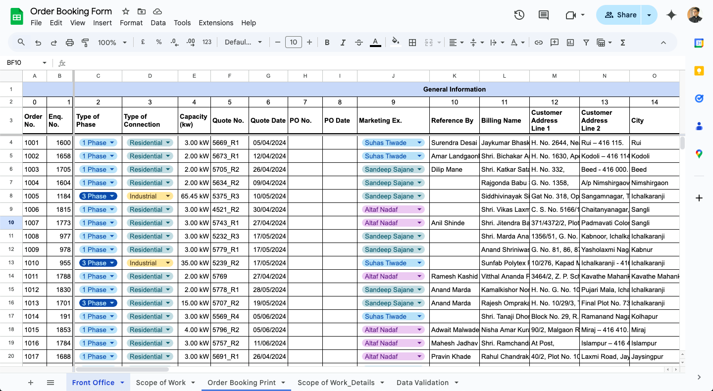

Can data directly from row 4 of google sheets be connected while doing the initial set up for connecting google sheet to pabbly connect?
In the first row I have the category title of the information. In the second row I have column numbers which I have used in the formula in the other sheet of the same google sheet. The main header for the data is in row 3 and the data starts from row 4.

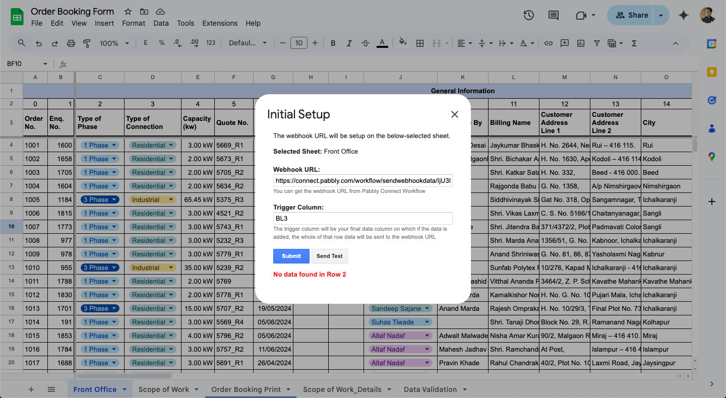

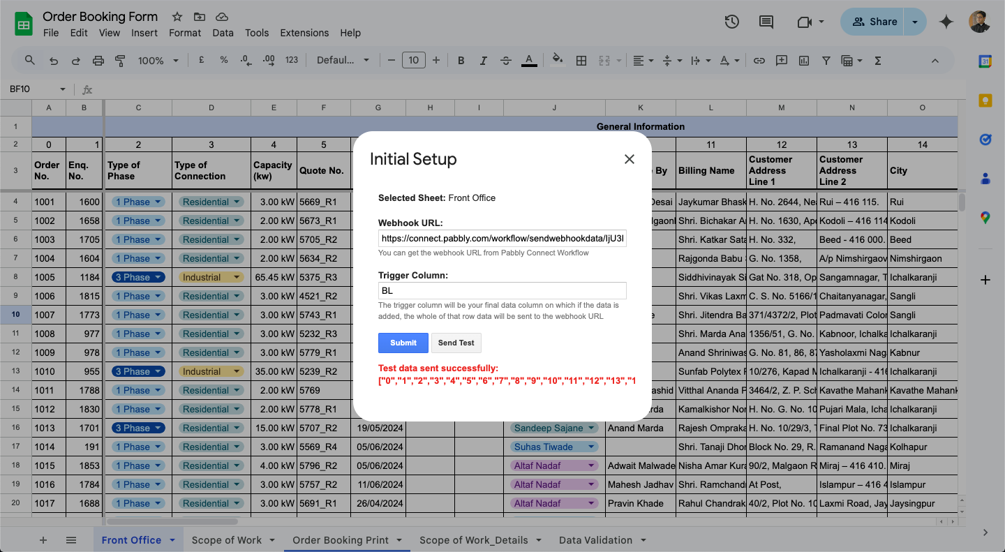

I want to trigger an action using the data from row 4. But during the initial set when I enter the trigger column as BL, then the data sent to the pabbly connect is from row 2 i.e. "Test data sent successfully 0, 1, 2, 3, 4, 5, 6, ..." etc. which are column numbers. If I put enter BL3 then it show error "No data found in row 2".

Hi @Gaurav,
No, the data in the first row of your spreadsheet is treated as the headers of your spreadsheet, and it's not possible to send data from any other row by clicking the 'Send Test' button.
Fagun Shah
Hi @ArshilAhmad,
Thank you for your reply. Is there any way to do it? Because it will be difficult for me to change the data in the sheet.
There is no workaround for this, all automation softwares like pabbly allows only 1-header row without merged cells.
That is how google sheet api works.
