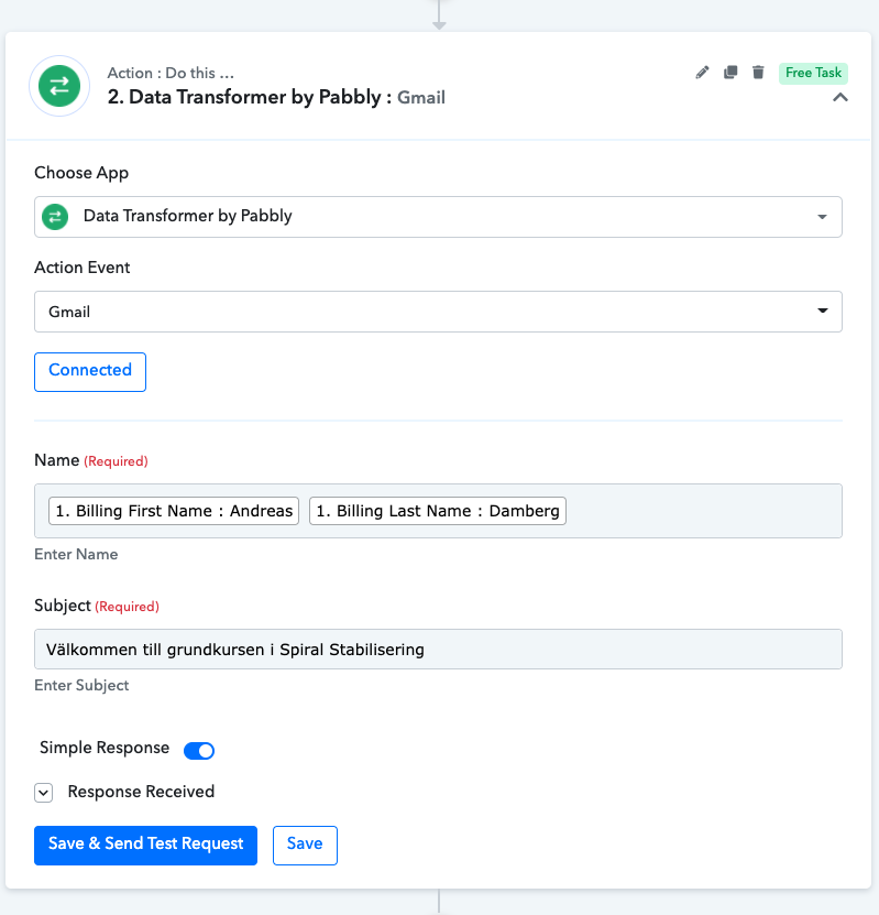

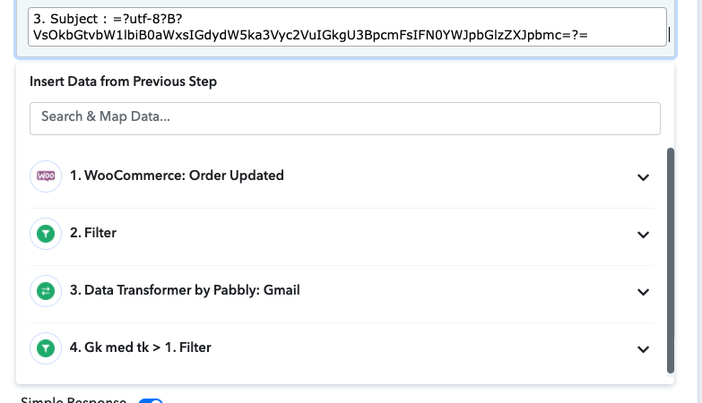

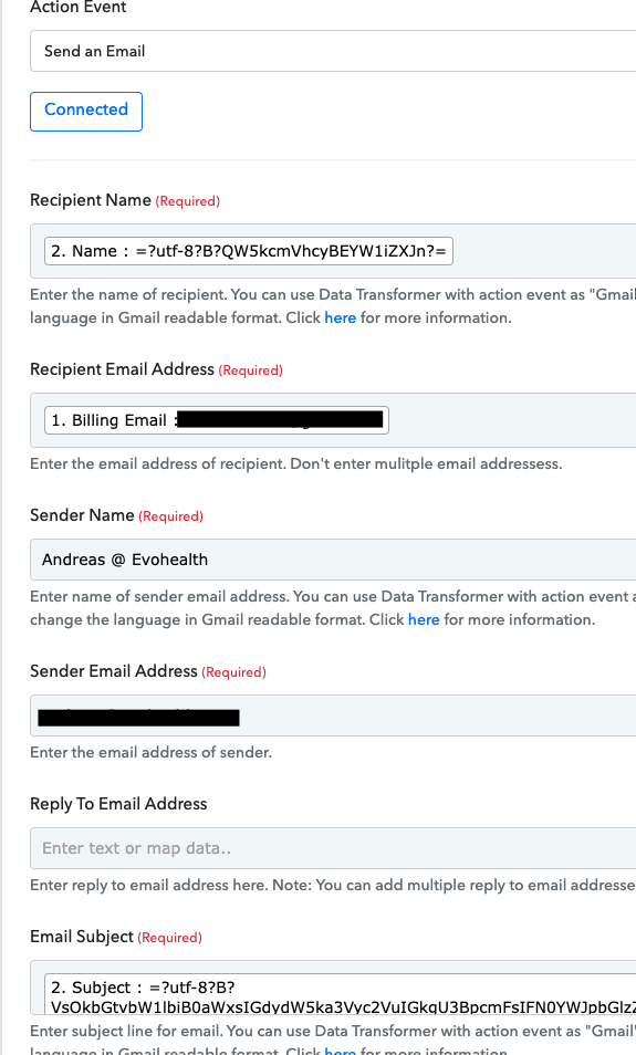

Thank you for your fast response! It seems that the builder has been slightly updated since that post. I got it working but more step by step instructions and an explanation of what it does would help.
As I understand it this transformer changes insert data to UTF-8?
The name entered would be the Recipient Name (it only says name)

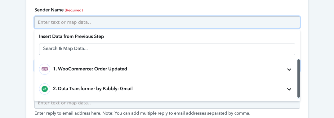

The above worked
At first the Search & map didn't show the transformer but I could find it by searching =. I could replicate this when creating a new Data transformer
