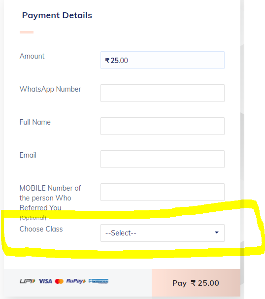

In RazorPay, when choosing a DROPDOWN, the option is not reflected in the WhatsApp message.
Workflow: Razorpay to WhatsApp
All Other tags (Name, Price & Email) show in the whatsApp message - (from the regular text fields) BUT Information from the Dropdown does NOT show.
You will need to do a test at your end to check the same.
This stopped working a few days ago on its own. No idea why!

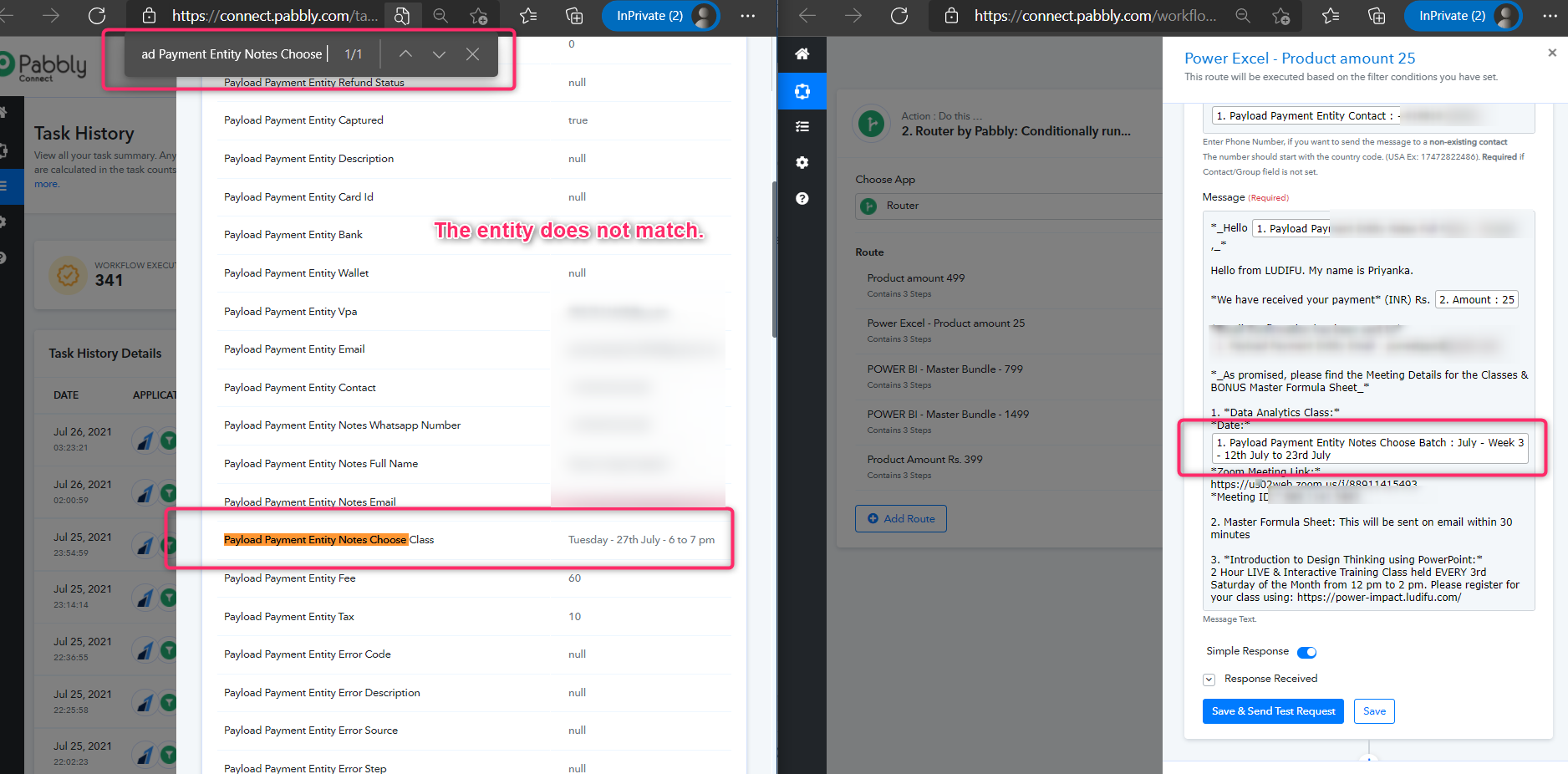

Hey @zest83
We looked over your concern and found that the entity which you have mapped from your Razorpay's response is changed from your end and that's why it. Please check the entity correctly and then re-map the field in the Chat API. Else everything seems working perfectly fine.
Please check out the following screenshot for better understanding -

Hey @zest83
I have started to get the same error again
I have corrected all the requirement fields.
Just today, i re-did the WebHook for Rs. 499 using a test mode payment on Razorpay.
The test message shows the batch information correctly BUT the minute the customer chooses another date in the dropdown (different from the date which was tested)- the Batch part shows as Blank
Please help
URGENT
Hey @zest83
We looked over your concerns and it looks like Razorpay might have changed the label of the batch type which you have mapped in the Chat API action step before.
So, as a solution, we would recommend you to re-capture the response of Razorpay and then re-map the fields. Further, re-map the batch label to this from the response "Payload Payment Entity Notes Choose Class".
[IMG width="688px" alt="2021-07-26_11h19_00.png"]https://forum.pabbly.com/attachments/2021-07-26_11h19_00-png.2419/[/IMG]
Also please do check with the Razorpay team and ask them for your Razorpay account, why the webhook parameters keep on changing automatically.

Hey @zest83
Could you please confirm that you have done the above step? If not, please do that as it is required to be done since the webhook parameters are changed as shown in the screenshot below -

So what you are saying is
Choose Class is being captured in the Webhook
But Choose Batch is being captured when the customer makes the payment
Correct?
