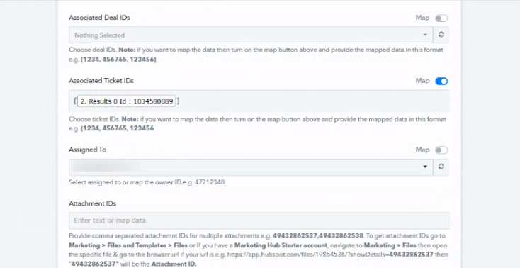

Invalid input JSON on line 1, column 1: Cannot deserialize value of type `com.hubspot.engagements.base.detail.views.EngagementDetailViewWithJson` from Array value (token `JsonToken.START_ARRAY`)
Supreme
Hey @bajglass
In the Associate Ticket IDs field, you need to pass the Id in the square brackets, kindly check the following screenshot.
Further, you could see an error in the action step which occurs when the ticket was already been associated previously.
bajglass
I can't believe it just worked. And mostly I can't believe this Forum worked. Thank you sooo much!!!! I know you all are not in an easy spot to assist and with all the users I cannot even imagine what you all must go through. Thank you again.
