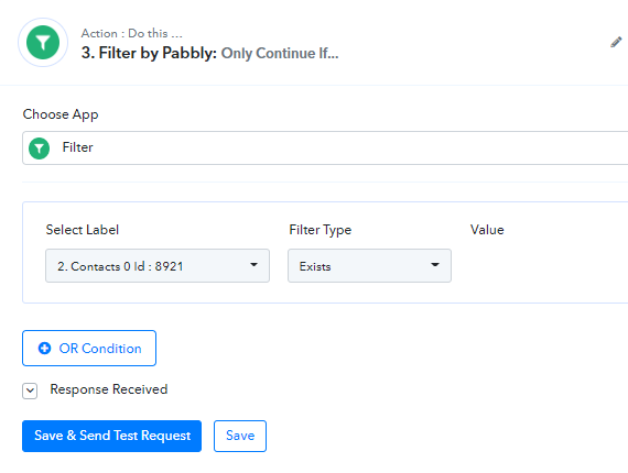

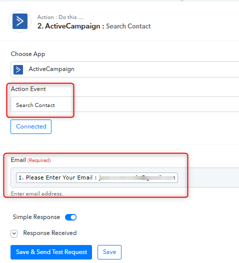

We have checked the workflow and added action step ActiveCampaign - Search contact and searched the contact given by email id and we got the results. Then we have added filter condition in it and checks if id exists then continue else stop the workflow.
Kindly check and let us know if you have any questions or comments.

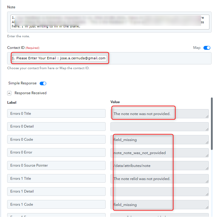

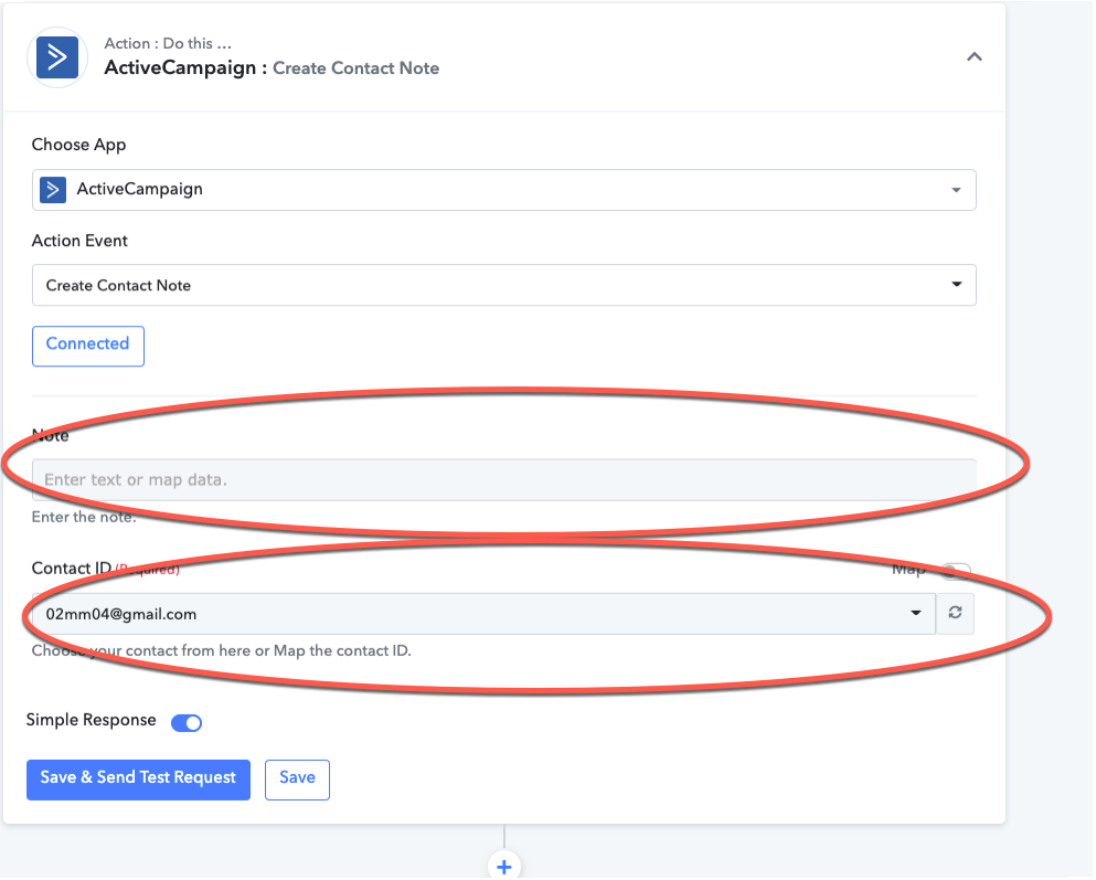

The problem I am encountering happens when you choose "Create Contact Note" you only have 2 fields to fill out. (see below)
I am mapping the 2 pieces of data that are required and getting an error when I do so. These are really the only 2 pieces that should be needed. Activecampaign needs to know which record you want to change (the contact ID) and what field in that record needs to be changed (Note).
The search contact was me trying to figure out a solution unsuccessfully. I should have left the automation alone after asking for help here. I've left it the way I think it's supposed to work now, but obviously, it doesn't work. Please help.

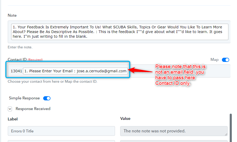

Kindly note that the field Contact ID is not an email field. You need to pass the contact id here only. If you are getting a contact id from Google sheets then you can pass it here. Else you can use the action "Activecampaign - Search Contact" and retrieve the contact Id from there and then map it in action "Activecampaign - Create Contact Note".
Please use the Search Contact action then add a filter to check if the contact already exists and then you can map the contact id in the Create Contact Note action and run your workflow.
