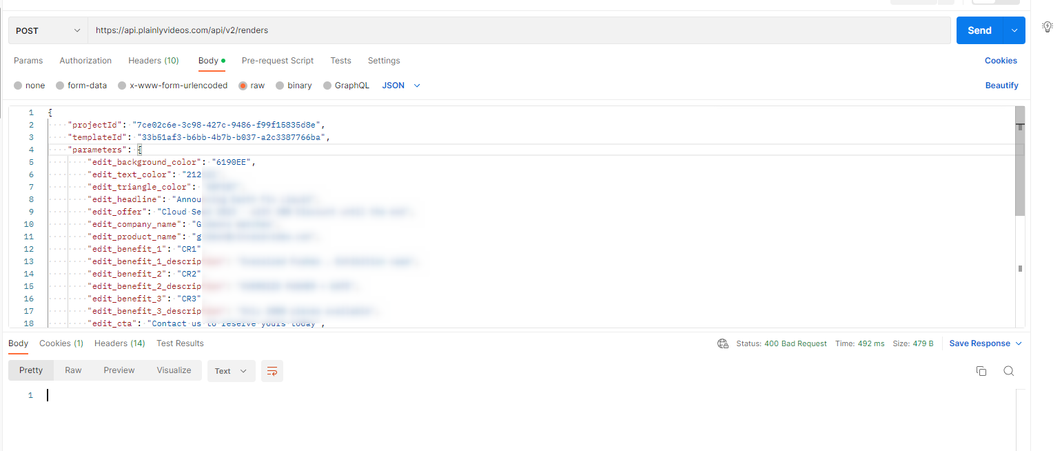

Also regarding the API by Pabbly action step, we have tried the same request on the Postman and it is responding in the same manner.
So, kindly check whether the API request is correct from their API documentation or you can contact the application's support team.
