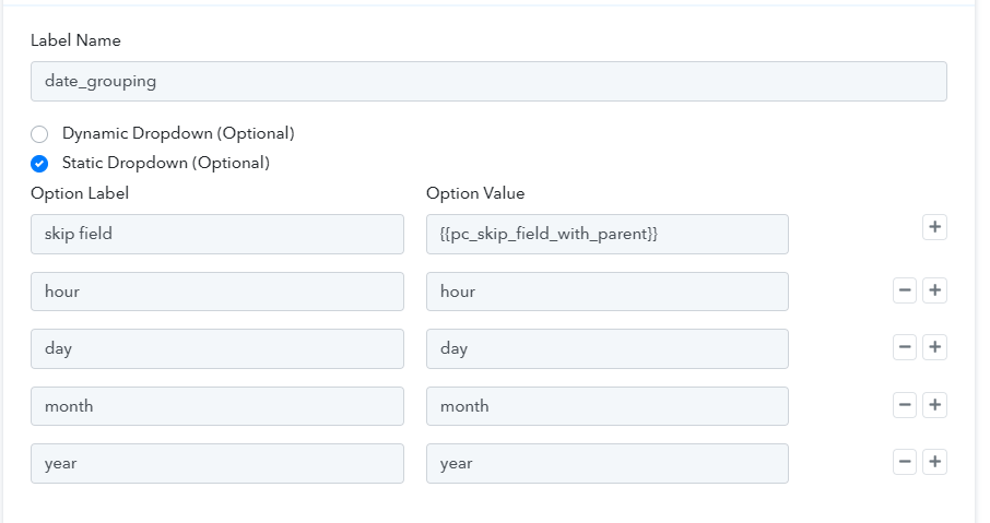

How would I have a list of dropdowns where there is a {{pc_skip_field}} as default (so no data or parameter sent in request) and then if 1 of the dropdowns is selected it sends that data.
I can't see how I can have a dropdown list without having send data as default. Below image is what i am trying to achieve but not having to have a skip field option.

The advanced functions will not be supported in the dropdown fields, you need to pass at least one default value for the dropdown field.
Ahh ok, thanks. So there is no way to have dropdown fields that are optionally sent on the request? If I have dropdowns then the parameter will always be sent?

Yes, for now dropdown field option not support the pc_skip_field or any other advanced function.
