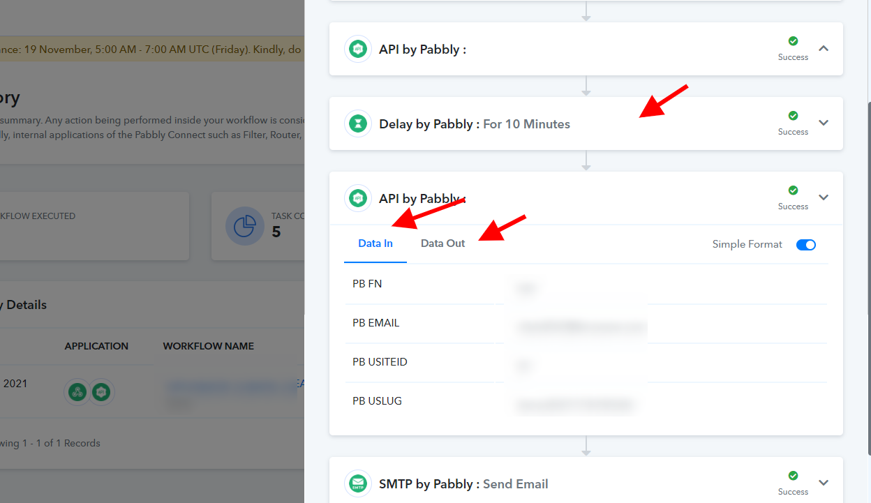

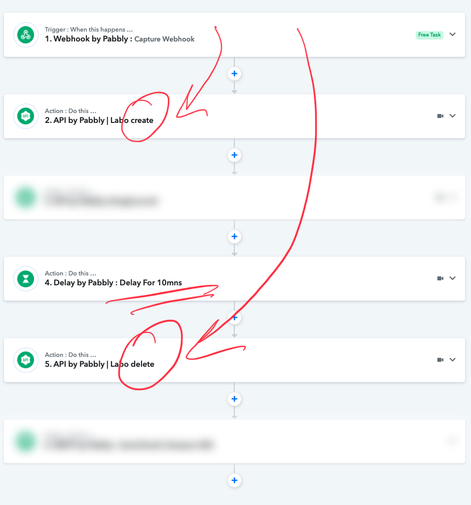

I just tested and so far it works, so I have the impression that I misunderstood myself, maybe with an image it would be clearer, I have attached it. Do you confirm that it's not safe? With 10mns it worked but maybe with 4 weeks it will fail?

The webhook data which will enter at the first step of the workflow will remain the same and will be transferred to other actions steps even after the delay step as provided in the workflow you have setup.
You can test the workflow and monitor the workflow history for better understanding. You can review the data IN and data OUT for each step for this.
