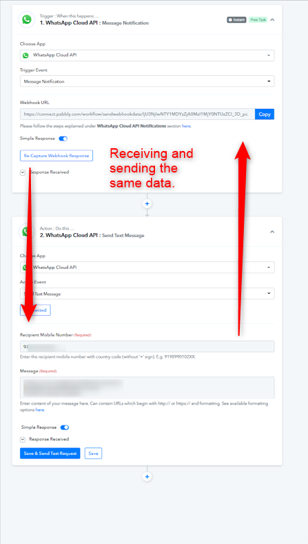

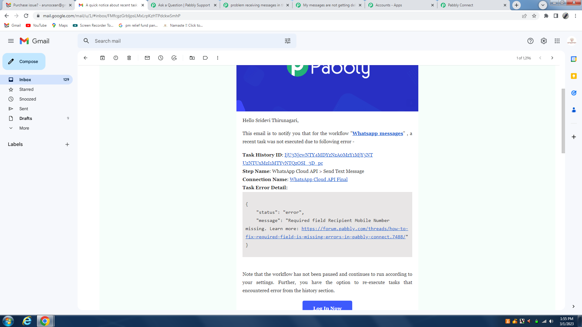

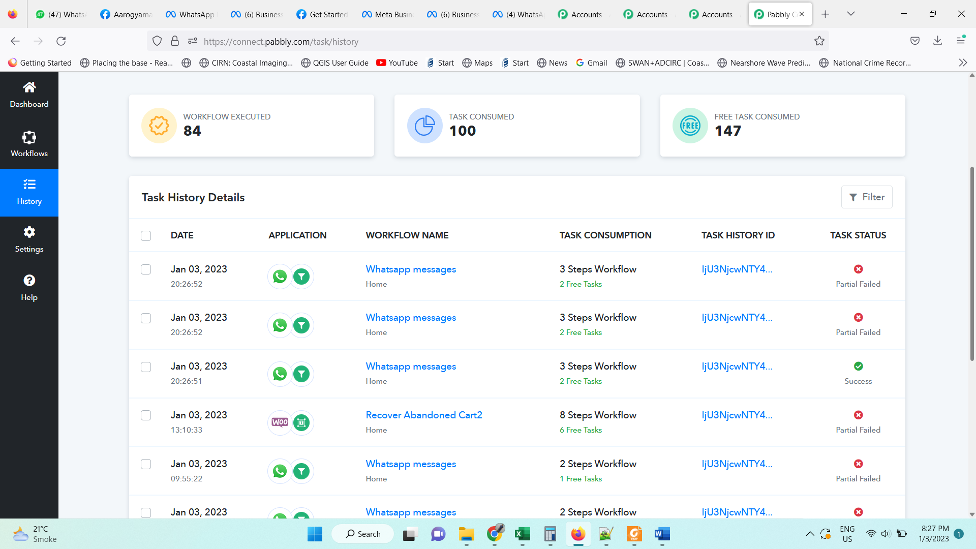

I'm facing problem in sending whatsapp messages through API. Interesting, the sytem is sending the replies as per the templates (at mobile). But in Pabbly, it is showing as error as mentioned in the screen shot. Also, I observed it is repeating the same message again and again and the tasks are being counted.. The below one shows the message, but the user is getting the reply on his/him whatsapp number..
Hey @aarogyam
It appears that you have created a loop in your workflow with WhatsApp Cloud API where you are capturing the same response that you are sending.

No.. I have followed similarly as explained in the tutorial video. I'm getting message from a whatsapp number (e.g. 918200******) to a whatsapp cloud api number (e.g. 916340******). I have put a message in the workflow to reply to the previous number (i.e., 918200******), there is no loop here. the former is receiving the message but in your website it is showing an error.. !!! and continuously executing the same (but the former is receiving the message only once..).. I'm loosing the tasks.. kindly let me know how to solve this.

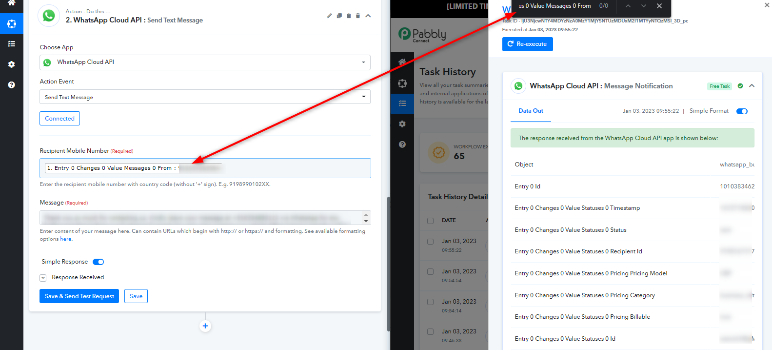

Please check whether or not the phone number label you have mapped in the WhatsApp Cloud API action step is coming in real-time.
As we can see you are getting the phone number in the different data labels.

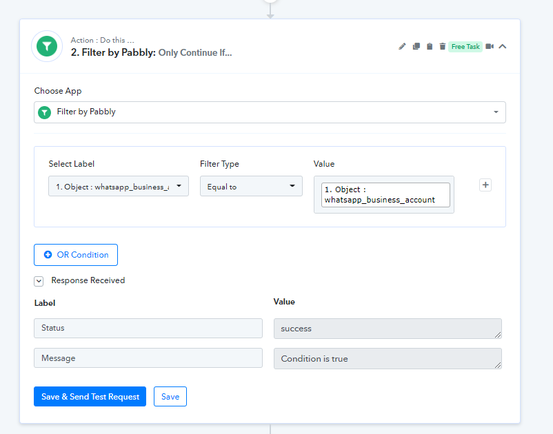

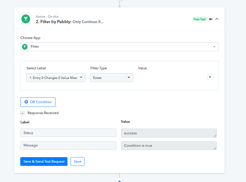

So, as a solution, we recommend using the Filter action step after the trigger event, which will process the workflow only when the phone number is coming from that particular field.

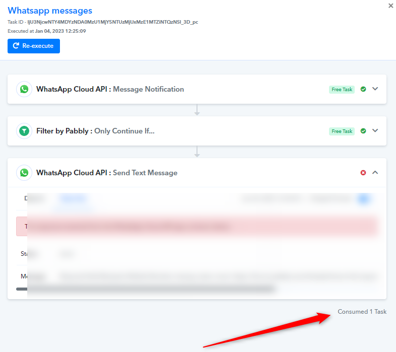

Pls check it has sent the message successfully but it costed me 3 tasks.. why it is happening like this. It should be only one task. Also, why errors are coming like that?

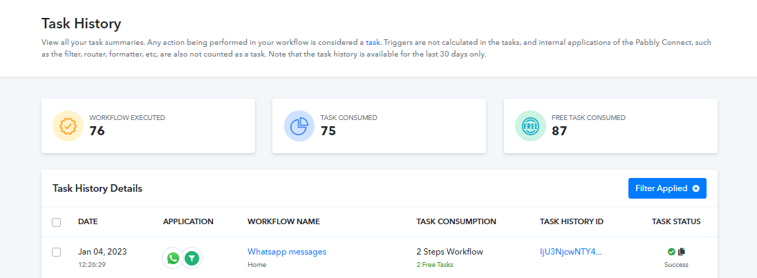

Hey @aarogyam
We have changed the filter condition from your workflow and it should work when the phone comes in that specific field.
Though we have tried the same at our end, it is working fine now.
Moreover, if you can see the particular task, you will see the exact consumed charges in that execution excluded free tasks.
