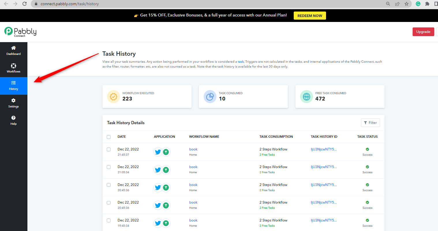

Hey @Nicola
You can check your complete history log once for the failed, partially failed and failed tasks.
