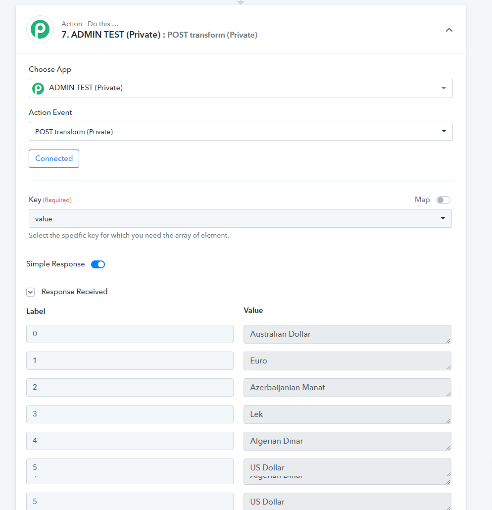

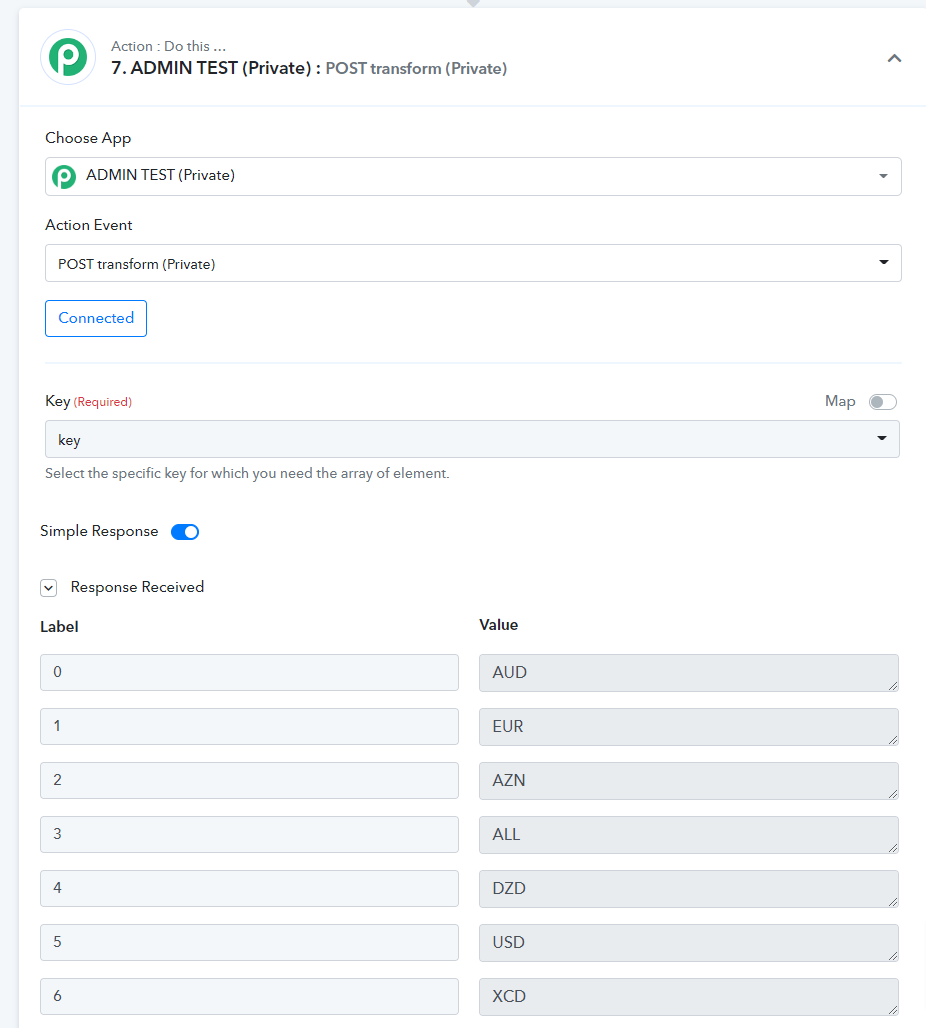

Based on dynamic variables:

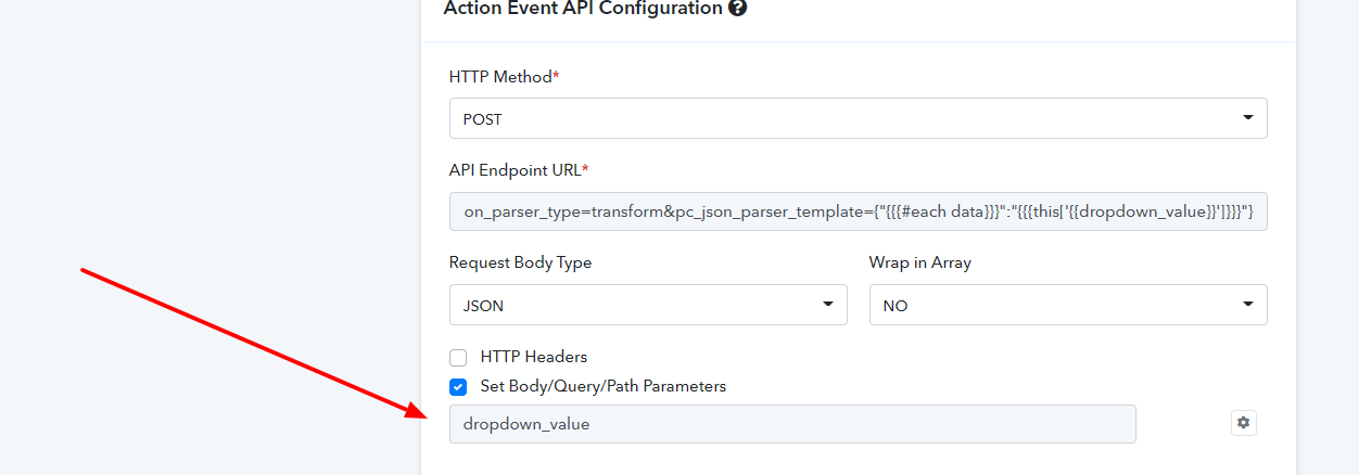

You can even provide a variable also so it will change based on the variable, this can be the dropdown value.
QMOMdNrB0gO0W1pRPL_RIU-I6fweAeLJG85yr4K7sn3YcZ01jZRUDA7RJzXY1YqJDHhcVKm2iww-9xrO4SWezIYZTCgpRulRMyQxbbnePgJTxdVxoTpcReg7oQZ05bRC_XQDj0EDKHDoFbdsj3KgqqVpuD6boruEL80ba9H3_GYeGvOS2Vuxdv-qGkP6gg

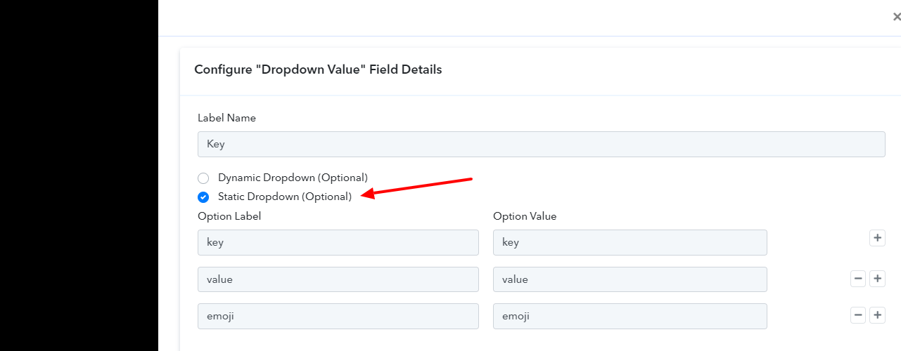

So as you declare the variable as dropdown_value
Which may contain static dropdown values such as emoji, key, value
_AGZmmAWdRQ9b67THkAX6L3XNTP8pL6UCcX7bL9I0aqVZjVWjfC5WNBLuGd3Xnq4E9cZeW8W6FCOzEtNP5sFALh-BPiwDmZhsi4yZNk25aTsnwK5IGX4sG5yVzvaR32Pxs7u4Bh544Jp7TKxgavqSdC1W3S_WM2ZMYQ871dIv2V8n0Xsuhm7spFnpbm02g
If we pass the following template in the parameter then,
JSON:
{"{{{#each data}}}":"{{{this[‘{{dropdown_value}}’]}}}"}
So this will return the following response on selecting keys emoji , key , value respectively.

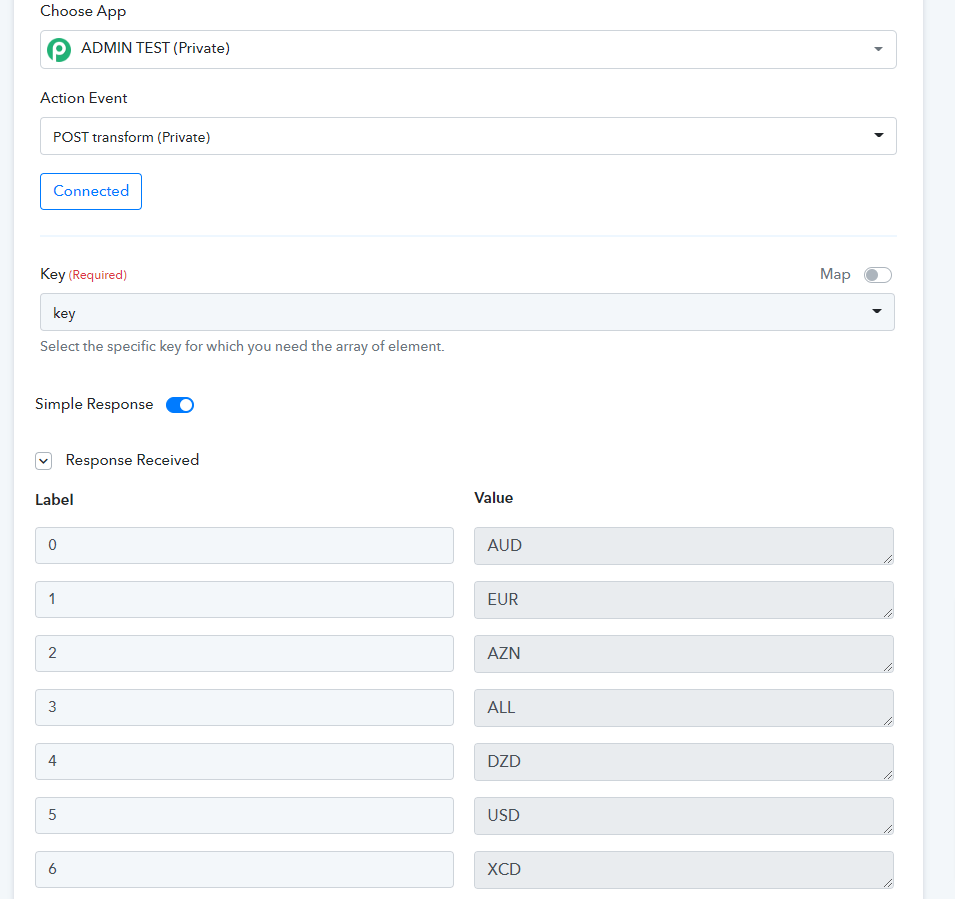

For emoji
Code:
["AUD","EUR","AZN","ALL","DZD","USD","XCD"]

For key
Code:

For value
Code:
["Australian Dollar","Euro","Azerbaijanian Manat","Lek","Algerian Dinar","US Dollar","East Caribbean Dollar"]
