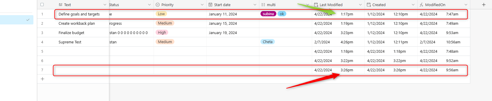

Hey @aaronocampo
Your use case seems to be possible. Kindly click on this link to access the workflow that we have made for the same- https://connect.pabbly.com/workflow...TVmoNGQcDAFYCcQQdBTkAAwB6VBkFNlAZDzwKVFR8B2Y#
Although, you will have to make some changes to set up the workflow.
Also, you will have to connect you own Airtable account and change the Base name and table.
Further, you can set up the Gmail step by following instructions mentioned in this video -
Now for finally deleting the record to which the email is sent, map the ID in the last step.
Kindly make sure that the ID you are deleting should be the same response to which the email is sent, i.e. "Records 0"
Please let us know if you get stuck at any step.
