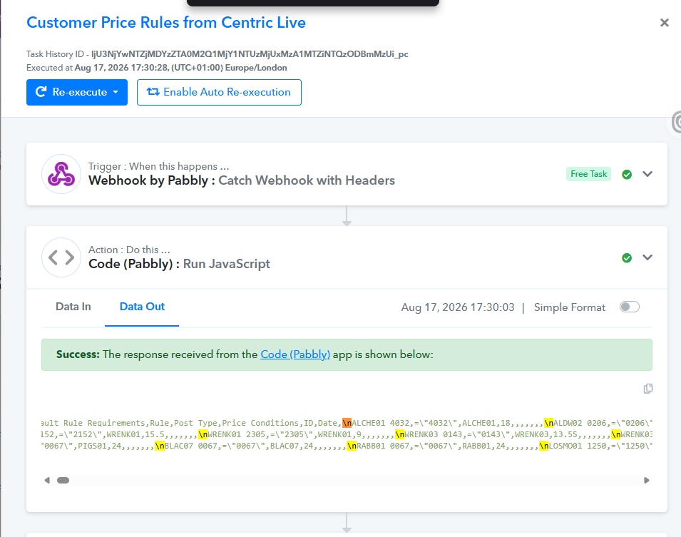

In the output of your Code (Pabbly) step (Run JavaScript), the CsvChunk_1 response string returns literal escaped line break characters (\n) in the JSON payload:
JSON
"output": {
"CsvChunk_1": "Title,Product SKU...\nALCHE01 4032,=\"4032\"...\n"
When this value is mapped into the Google Drive: Update Content in a File step, Google Drive receives \n as literal text rather than actual line breaks, causing the data to print across a single line.

The output has been working perfectly for months...nothing has changed from a workflow perspective - the js task remains the same as ever. Why am I now seeing this glitch? It began on the 20th August along with some other active workflows that have also started to output incorrectly

We inspected the backend execution logs for your workflow (Customer Price Rules from Centric Live) dating back to August 17, 2026.
Upon checking the raw response from the Code (Pabbly): Run JavaScript step, we observed that the JavaScript output object has consistently formatted line breaks as escaped character strings (\n) rather than unescaped newline characters:
When Google Drive receives \n as an escaped string inside the Update Content in a File payload, it writes the character sequence as literal text across a single row rather than interpreting it as a CSV row separator.
