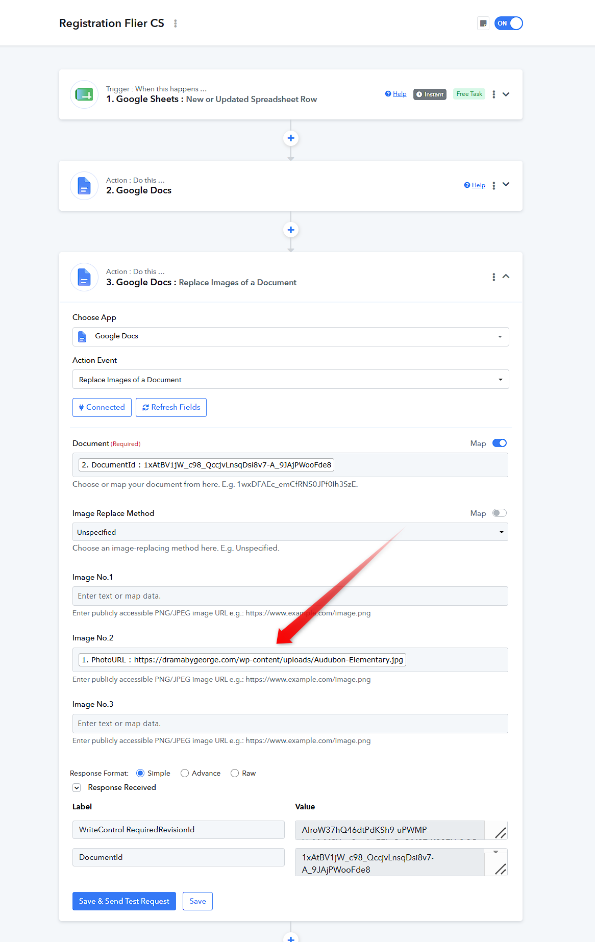

Hi! I have a workflow that has worked successfully in the past which includes replacing an image in a Google Doc.
The action to replace images wasn't executing (it generated an error). In an effort to fix it, I deleted and re-added the action step to Replace Images of a Document.
However, when I reinserted the step, the fields to replace images disappeared! It appears that Pabbly no longer recognizes that there are any images in the document.
I received an initial response from Adeel Akhtar in which he suggested removing and replacing the image in the template. I did that, and unfortunately, I'm still having the same problem.
Can you help me get the workflow to recognize the images in my doc? Thank you! Here is a link to the Google Docs template I'm using: https://docs.google.com/document/d/1VMKk3bmL3cbUNDAxPEBXvx8Jw6jHUHq3yK53LO4QgJw/edit?usp=drive_link

The expected fix for the image-replacement field not appearing is exactly what was suggested earlier — removing and re-adding the image in the Template document, then re-checking whether the field to replace the image appears. Since you've already done that and the fields are still missing, could you confirm is there any kind of mask that you have applied to the document? Cause the real image that you have added as the placeholder is coloured, but when we access it through the document, it shows in black and white.

Hi Adeel, I reinserted the photo without changing it to black and white. (The only change I made in Google Docs was resizing it.) Unfortunately, Pabbly still is not showing any fields for image replacement. I have given you Edit access to the Google Docs template so that you can try a different image yourself if you think it might help! Thanks again for your help and support on this.

We have fixed the template by re-adding all the images. Try not to use Drawing in the template. We added it as an image, and it is now showing in the action step.
