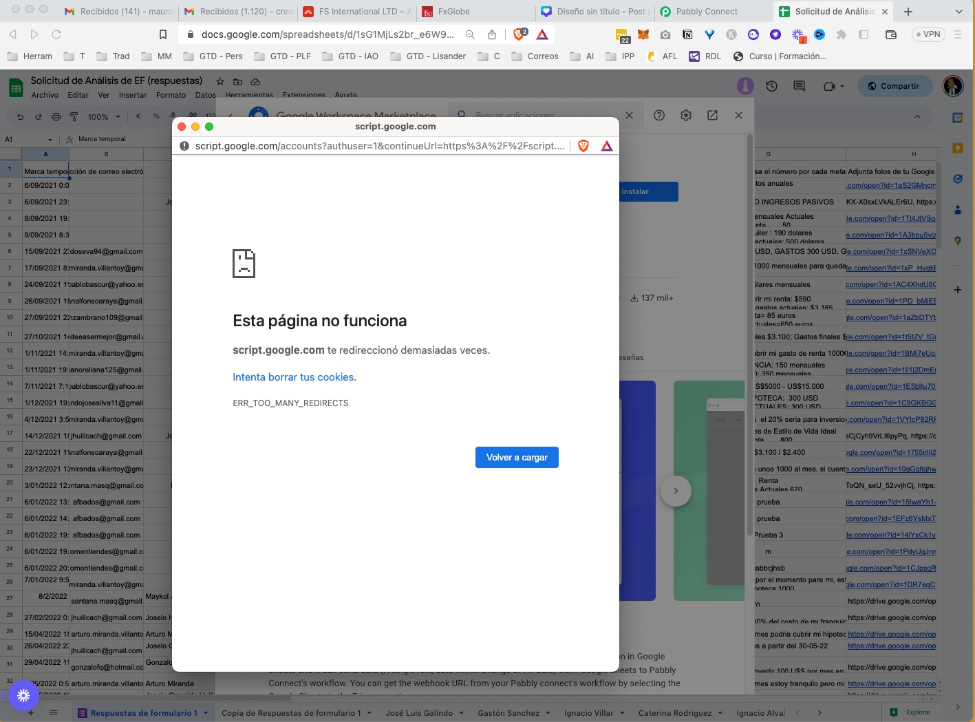

Hi @javiermarcon,
Kindly hard refresh and clear the cache of your browser, and try again. If the issue persists, try using a different browser to install the plugin.
javiermarcon — Reply ·
Thanks but after doing it I have another error. it happens in several browsers.
