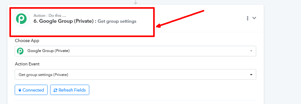

Hi, I would like to add a member to google group. but i require a group key, which i do not have got. please can you assist me how to add one user as a member to a google group
Workflow link: https://connect.pabbly.com/workflow/mapping/IjU3NjUwNTY1MDYzNDA0MzI1MjZhNTUzMzUxMzUi_pc
This is the action block i used.

Getting the "Resource Not Found: groupKey" error in Google Groups API means the API couldn't find the group you specified. Here's why:
- Wrong group key: Double-check the email address or group ID you're using.
- Missing group: The group might not exist at all.
- Permission issues: Your account may not have access to that group.
- API limitations: Free Gmail accounts can't manage groups with Admin Directory API.
To fix it:
- Verify the group key.
- Confirm the group exists.
- Use an admin account with proper permissions.
- Use the Groups API for free accounts (if applicable).
