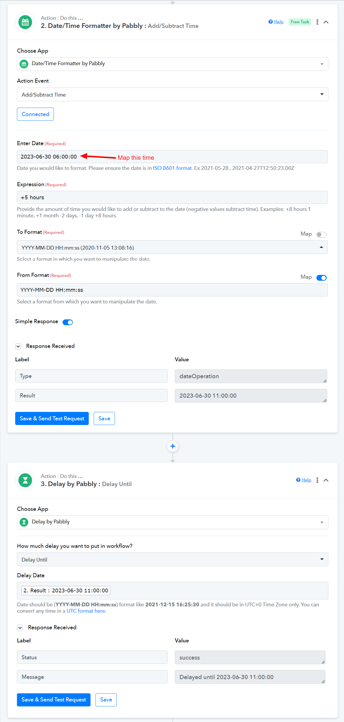

At first glance, the issue appears to be related to your Timezone.
Although we are still looking into this, in the meantime, I would suggest pausing your current workflow and setting up a new one from scratch (without cloning). Additionally, I would recommend adding a Date Time Formatter after the 'Google Sheets: Lookup Spreadsheet Rows' action step in the new workflow to correct the time.

No, you don't have to adjust the time in your entire Google Sheets spreadsheet; the Date Time Formatter will help you with this exact issue.
Let's say you want to activate the Delay at 06:00 as per your timezone (UTC -5, America/Jamaica). So, you will enter the time in your spreadsheet as 06:00, and Pabbly Connect will capture that time from your spreadsheet.
However, the Delay considers the time to be in UTC format, which is 5 hours ahead of your time zone. So, if you directly map the time captured from your spreadsheet, the delay will be executed at 01:00 according to your time zone instead of 06:00.
To prevent this, we will add 5 hours to the captured time using Date Time Formatter, which will make it 11:00. Then, we will map that time in the Delay step. This will ensure that the delay is executed at 06:00 according to your time zone.

We understand your point of concern and the Delay until the action step shares different resources than the account level timezone.
So, to use the Delay Until Action step you would be required to convert the timezone to UTC in the given format.
