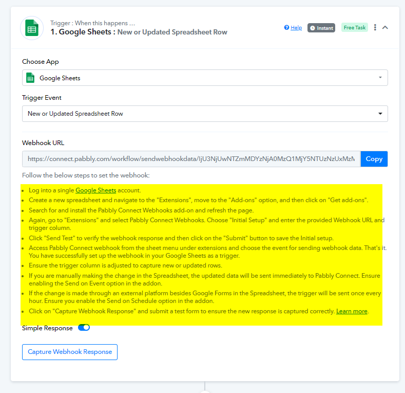

It is mentioned in the help text within the Google Sheet trigger. Please refer to the screenshot below for clarification.
Additionally, we will provide feedback to our team for further updates.
