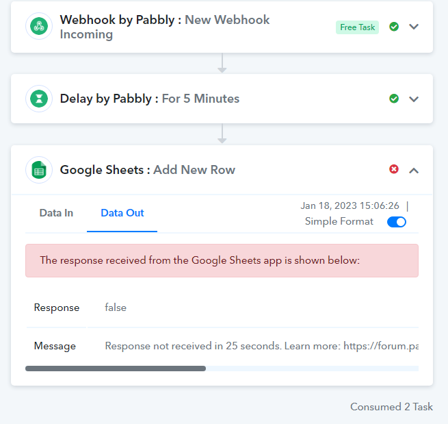

Currently, I'm fetching JSON data from another application to Pabbly Webhook every 3 hours and forwarding the data accordingly to Google Sheets by 'Add New Row' service. The data size is quite small, with only 30 records of data per fetch.
I've followed the suggestion to put 5 minutes delays between the Webhook to Google Sheet 'Add New Row'.
as suggested by Pabbly's team in the Forum :
https://forum.pabbly.com/threads/pa...rror-response-not-received-in-25-seconds.855/

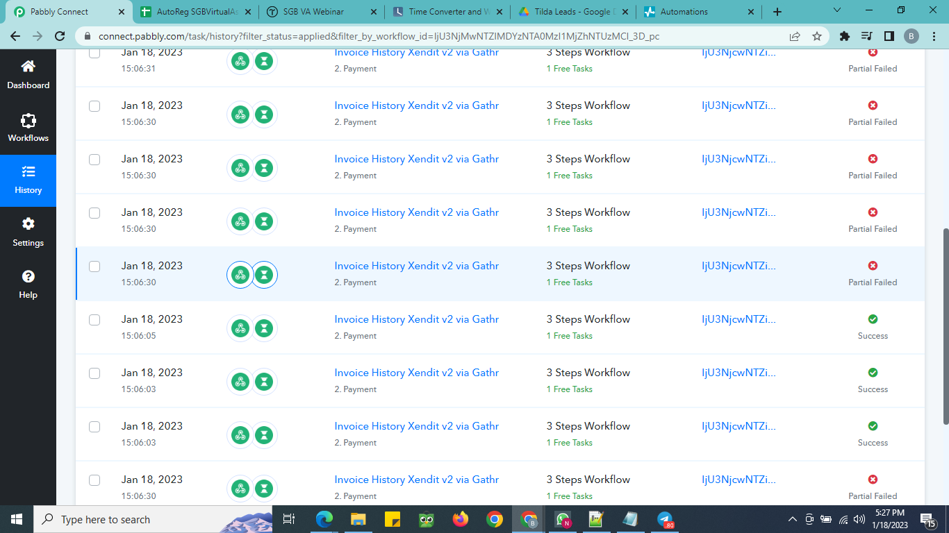

But the success rate is only 75-80%, while 20 - 25% of data always partially failed on the Google sheets step with the error message 'response-not-received-in-25-second'
Here is a few example capture screens:

Hey @Bayu
The API request is legitimate from our end, but since Google Sheets took more than 25 seconds to respond at that time and it worked when we tried again, we can infer that there was a problem with the Google Sheets API. I kindly ask you to get in touch with Google support so they can give you further information. Additionally, it's possible that you're making excessive use of the Google Sheets action step.
