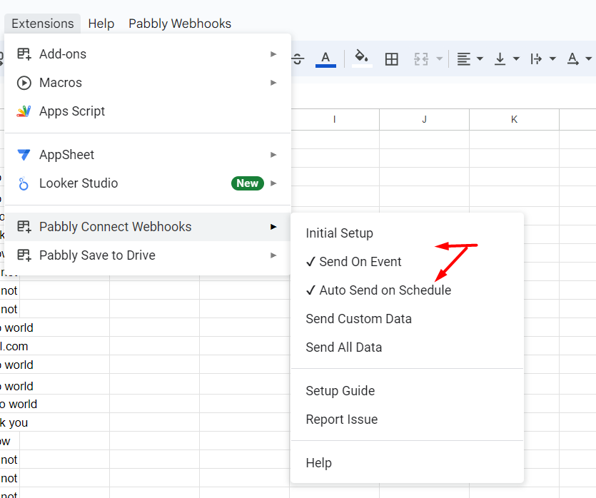

Hey @digitaldivi !
If the data are added inside the Google Sheet through a third-party application, then put a tick on both "Send On Event" and "Auto Send on Schedule" in your Google Sheet add-on-
The data will trigger inside the workflow in a time frame of 1hr, as this is a limitation from Google Sheets when a third party is used to add data.
You can lower the time to 1min by following this forum thread- https://forum.pabbly.com/threads/go...rigger-send-new-rows-in-every-1-minute.12954/
This will work for you further.
