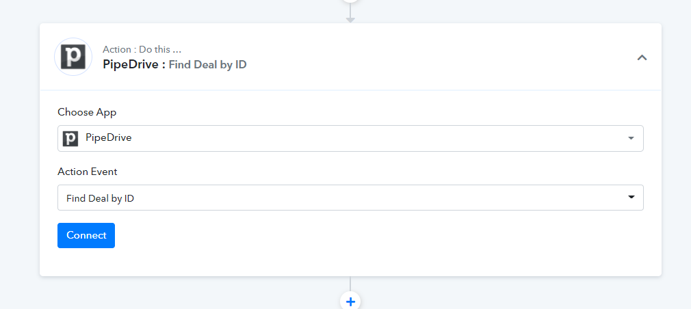

Hey @Fchaves
We have added a new action event "PipeDrive: Find Deal by ID" in Pipedrive integration which will extract the existing deal with the help of Deal Id.

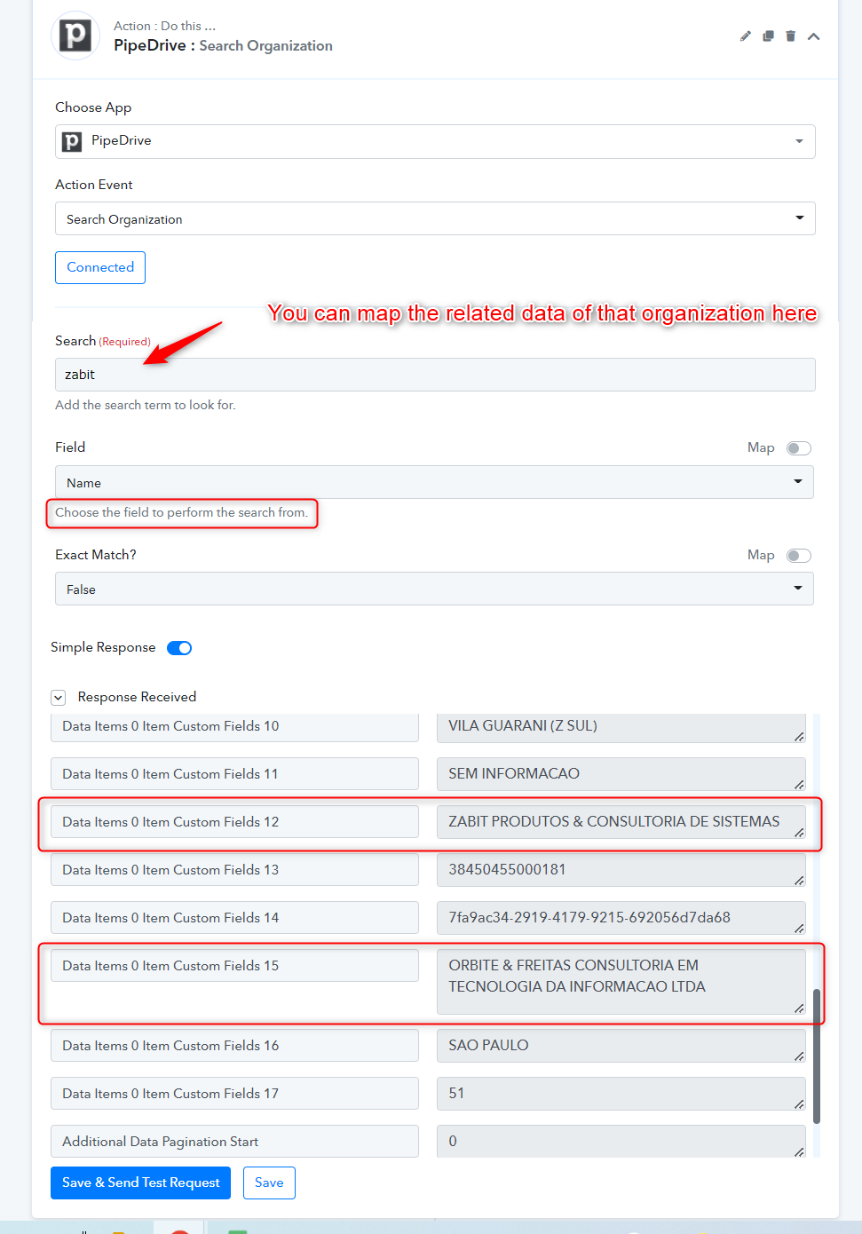

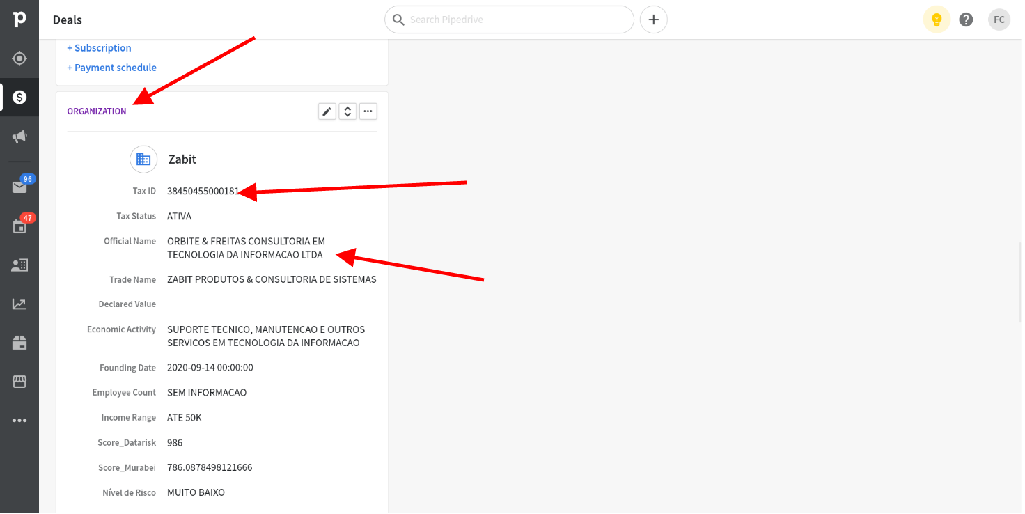

Hey Supreme! I tested it here and works almost perfect! There are some important fields that are missing on the "capture". I don't know how to call them but they are part of "Organization" on my dashboard. Do you know what could I do to capture this data? Thanks a lot.
Hey @Fchaves
Since the Organization data is different from the Deal's, you need to use the "Search Organization" action event to retrieve the data.
Though you are using custom fields in Organization and their values wouldn't come with their custom field name, it will appear as the respective custom fields id.
Kindly try this at your end and let us know if that helps you out.

Almost worked but.... for sure not a Pabbly problem... Happens that sometimes, for apparently no reason, sometimes the "custom" field changes out of the blue... 2 cards created in the same week returns the desired value in different fields :( I'll probably work on "filters" and/or routers to solve this.... it's a pitty but... that's life.
Thanks a lot Supreme. Have a great week my friend!
