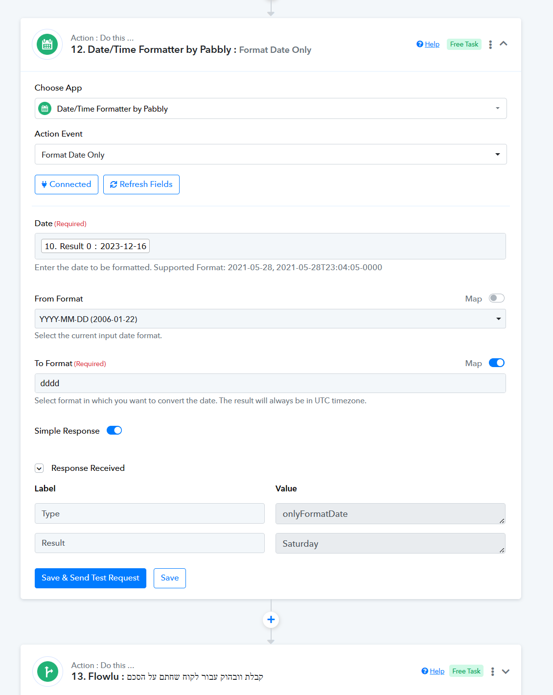

I know that I can schedule a workflow on specific days. However, in this case it doesn't help me. This is because I can only use this step on the first step of the workflow. But I need to capture data via webhook which I can only run on the first step either.
What I want to do is to send a Whatsapp to customers to remind them to reply to a questionnaire. But I don't want to send the Whatsapp on Saturday, which is our day off. So I want to add a delay of one day only when the Whatsapp is supposed to be sent on Saturday. I tried to watch this video
but it looks too complicated to excute this simple task.
Also, I tried to use a router so the Whatsapp will be sent immediately every day except Saturday. And on Saturday it would add a delay of one day. Still, it didn't work. For instance, I got an error when I tried to select a label as this date 16/12/23 and filter by "equal to" Saturday. This condition was supposed to be true as 16/12/23 was Saturday. So, it didn't work for me either.
Can you please guide me on how to run this kind of workflow automation?

Kindly check the 12th step in your workflow which will provide you the day from the particular date which you can later use in your further Router action step accordingly.
Please give it a try and let us know.
