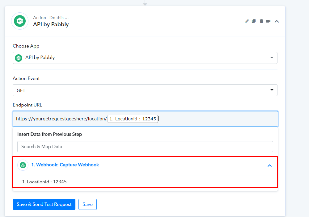

Fagun Shah
When you click in the Endpoint URL field you get options to map values from above steps, if you are not seeing that please refresh the workflow page once -

Fagun Shah

So you need to Turn of the Simple Response for your API step and then click on Save and Send Test Request again. That will give you data in JSON Array format. Which then you can use inside the iterator which basically helps you to loop through each location id and API one by one from JSON Array.
After iterator step you can set filter to only execute action if the location id is matching from step 1.
