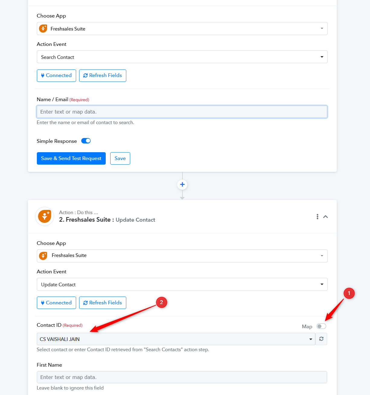

As we can see from your workflow you haven't selected anything in the status field and to update the contacts dynamically for the new contact form entry.
You should begin by searching for the contact with the "Search Contact" action step and then passing its contact ID to the "Update Contact" field. This will ensure dynamic updates for different contacts; otherwise, it will repeatedly update the same selected contact with each execution.

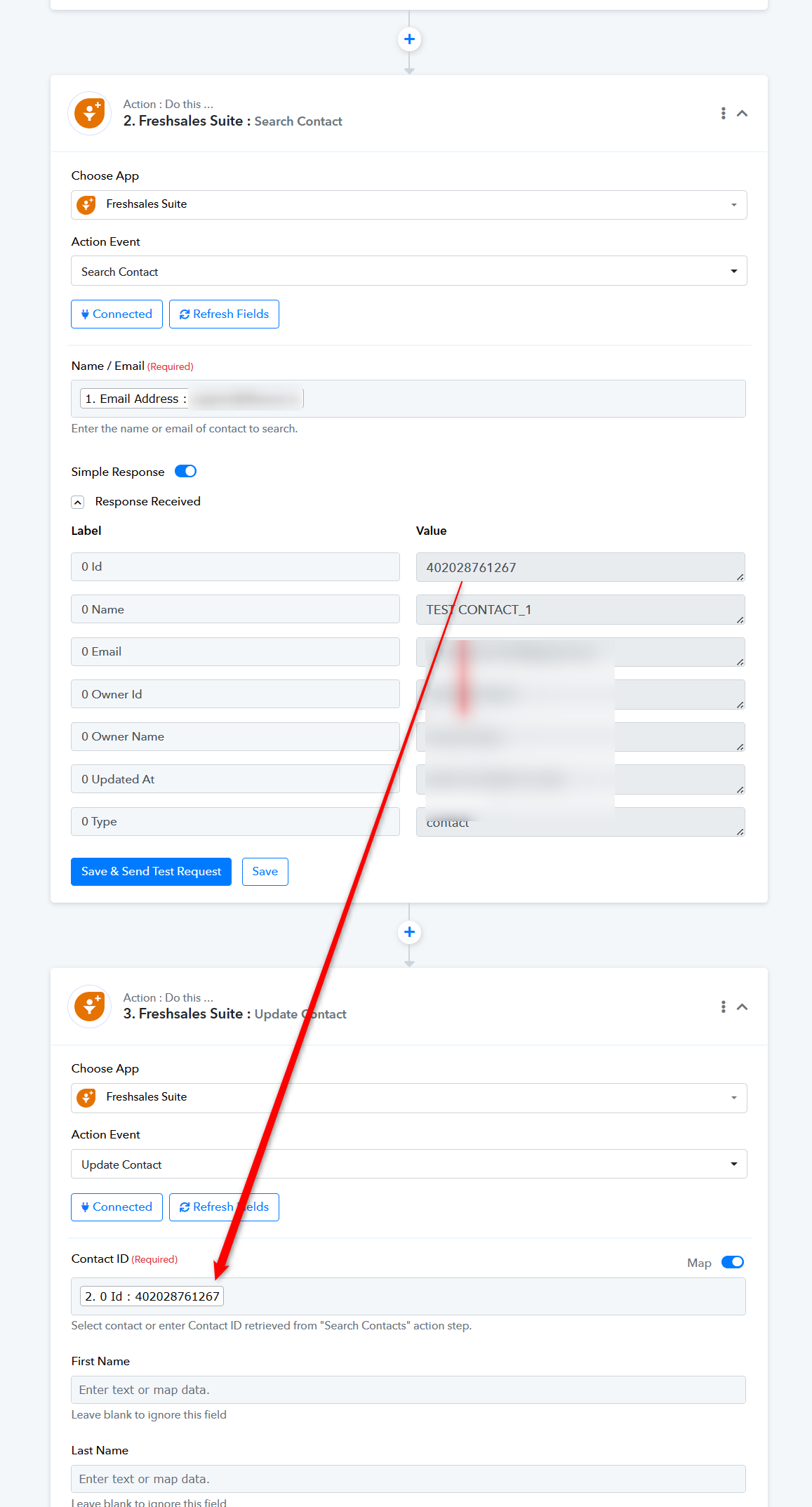

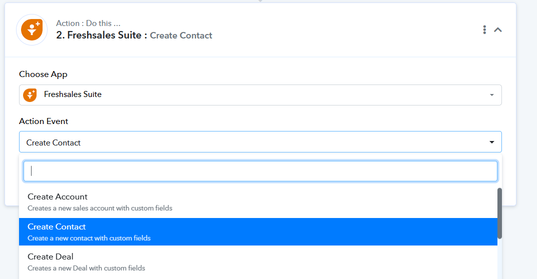

As mentioned above you need to map the contact ID by first searching it with the help of the "Search Contact" action step.
Make sure that the contact that you are trying to add exists in your Freshsales account or not, if not then you need to create the contact first with the help of the "Create Contact " action step.

We have remap the contact ID in the update contact action step correctly and it should work accordingly now.
Please try this in automation and do not change the value in the "Search Contact" action step.
