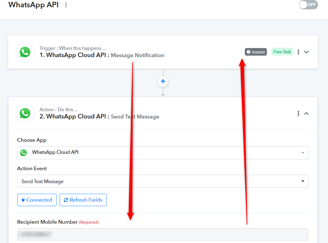

Could you please assist this same problem occurred with a WhatsApp Workflow I'm setting up during testing and it consumed all my tasks.
Can you please share the workflow URL in which you have tried the same so that we can look into it and help you accordingly?
Please see workflow URL;
https://connect.pabbly.com/workflow/sendwebhookdata/IjU3NjUwNTZmMDYzNjA0MzA1MjZhNTUzMTUxMzAi_pc

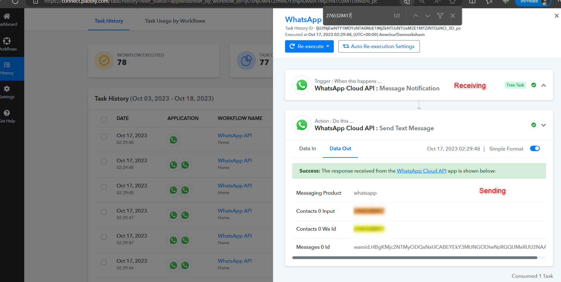

I was testing it this morning and it fired up all my remaining tasks.
Please can you have a look and let me know.
It seems that within your workflow using the WhatsApp Cloud API, you've established a loop where the response you're receiving is the same as what you're sending.
Moreover, we've gone ahead and reset all your tasks temporarily. Please refrain from utilizing a loop-based workflow that could result in depleting your task resources.
