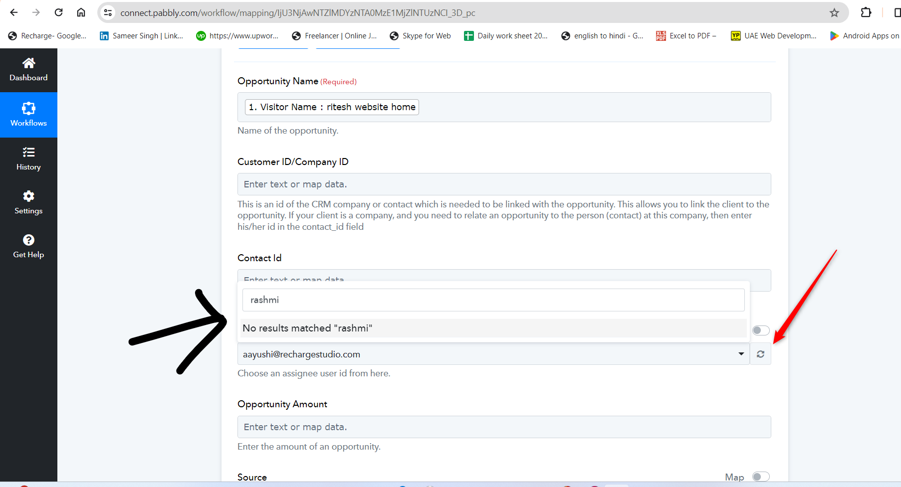

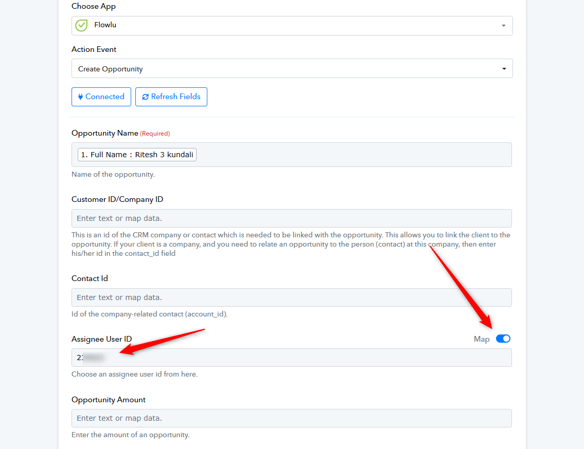

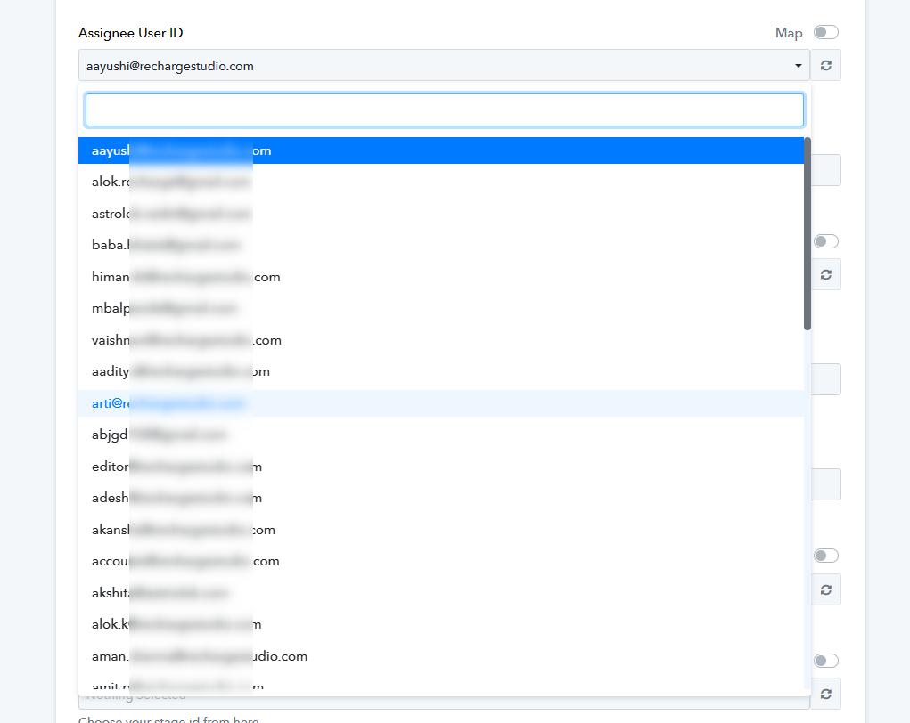

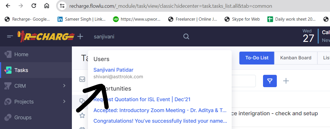

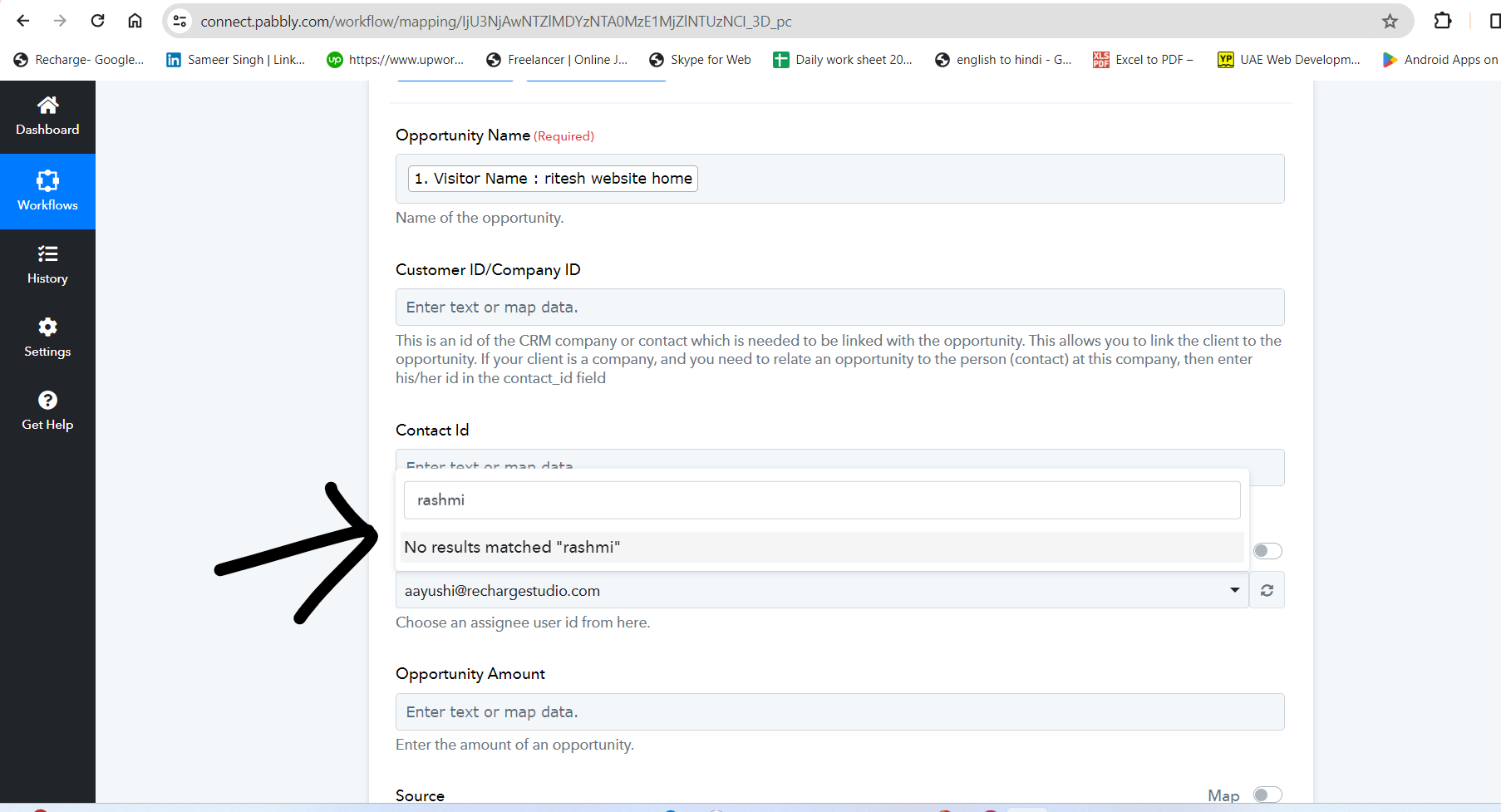

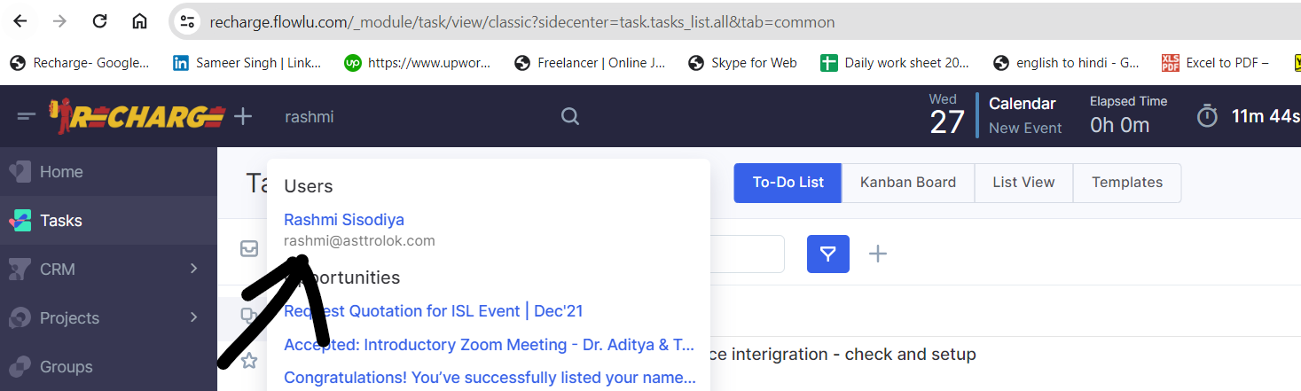

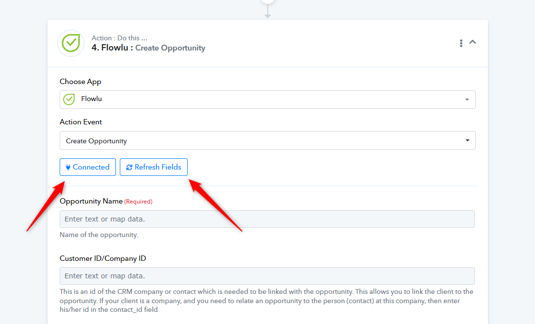

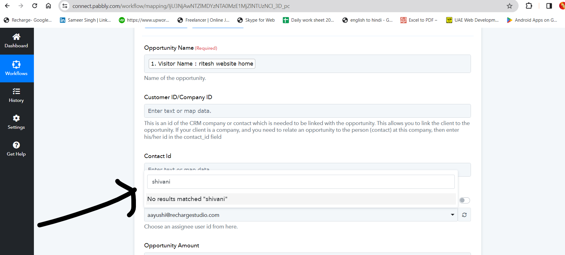

User is active on flowlu but when I want to create an automation and create a lead in this user account then this user is not shown in pabbly and there is almost 10 to 15 user id not show in pabbly and active in flowlu.

I am facing this problem with many id's. id is active on my flowlu account and I am not getting that id shown in Pubbly for automation I user trigger create opportunity. Earlier I used to see all these id shows in Pabbly but now these id's not shown in pabbly.
I have tried all this but it is not solving my problem.
Please look at the screen shots I have sent you once more and read my complaint, then you will be able to understand my problem better.

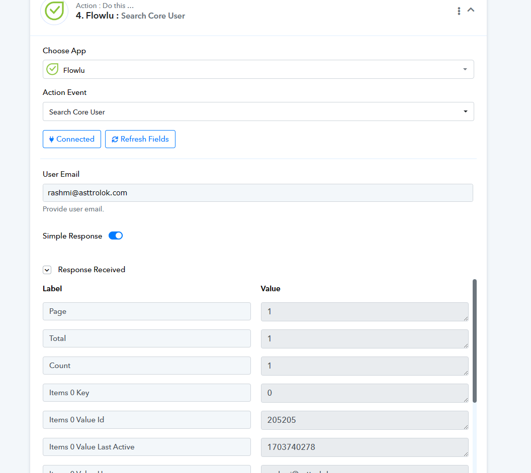

Flowlu's dropdown list for assigning users has a limit of 100 characters. To overcome this restriction, you should utilize the "Search Core User" action step to find the user you want. This search will provide you with the user's ID, which you'll then need to pass into the "Create Opportunity" action step.
