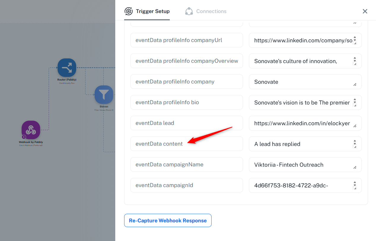

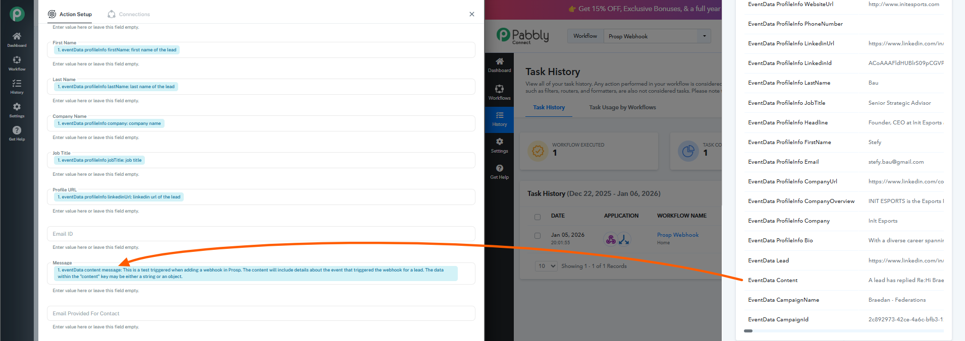

Upon checking, we noticed that the key used for mapping in the workflow is EventData Content Message, whereas the key currently being captured in the task history is EventData Content. This mismatch is causing the issue.
Solution:
Please capture the latest response under the workflow trigger and then remap the fields using the correct key. This should resolve the issue.
i feared that could the case, but when i test the webhook thats the only fields I see. in the task history theres no evendata content message and in test webhook data there is no evendata content

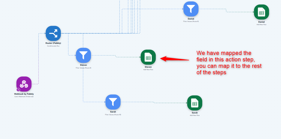

We have captured the latest data on your behalf and mapped it to one of your Google Sheets action steps. You can map it to the rest of your Google Sheets action steps and save them.
