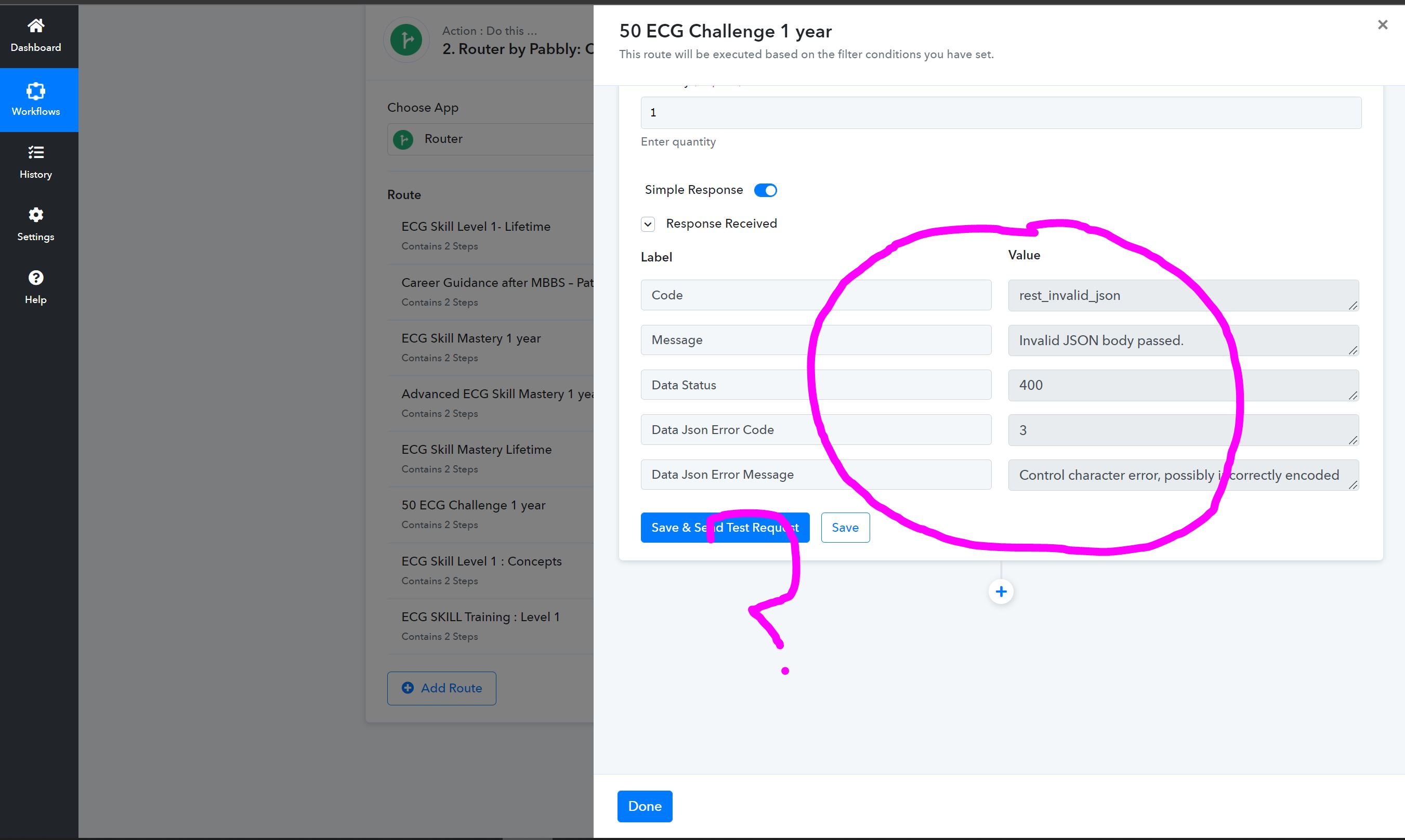

Issue with the response
Group Name: Graphy/ Spayee Aut... (6
Work Flow name: #06 Elementor To WooCommerce
the response is getting an error please refer to the attachment you will get to know about the error.
once is it's done please let guides

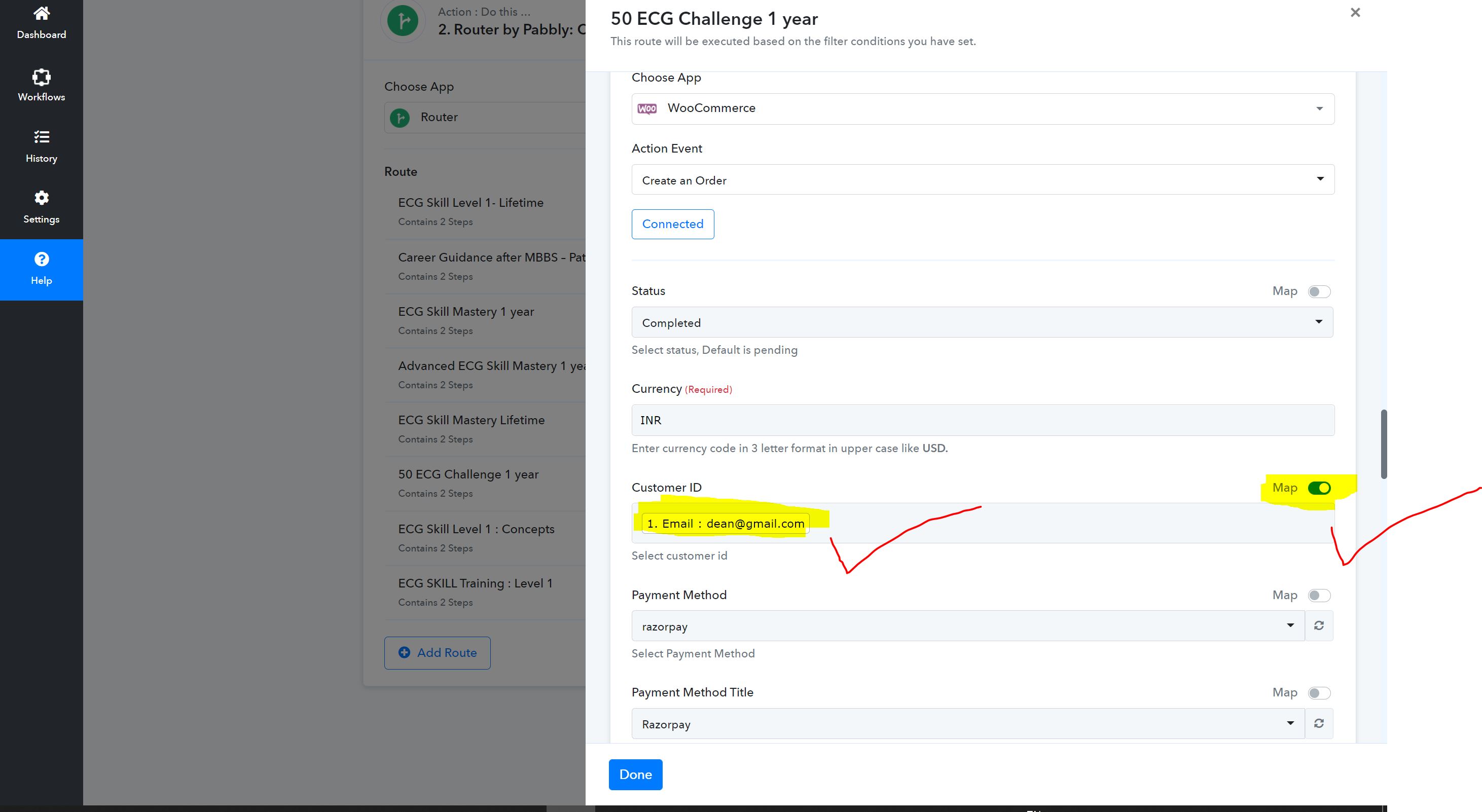

Fagun Shah
I think error is happening bcoz yo are passing email address as Customer ID. Both are different things.
To pass customer ID you might need to use woo-commerce action called Retrieve Customer by Email before your current WC action.

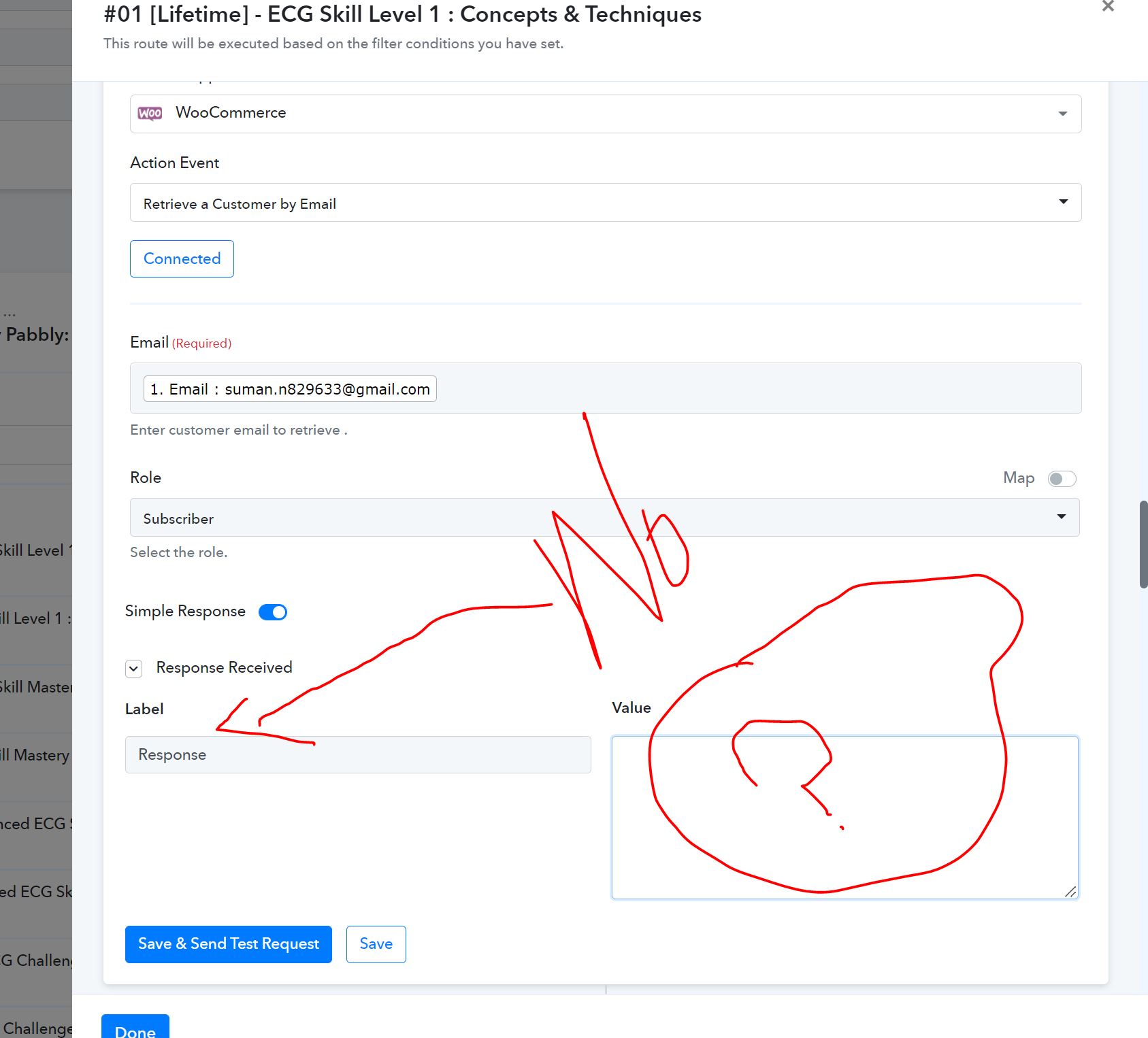

Could you please guide us on how to do that because we haven't received any of the response.

Supreme
Hey @quepreonpay
Pelase check out the following screenshot for a better understanding of your concern.
