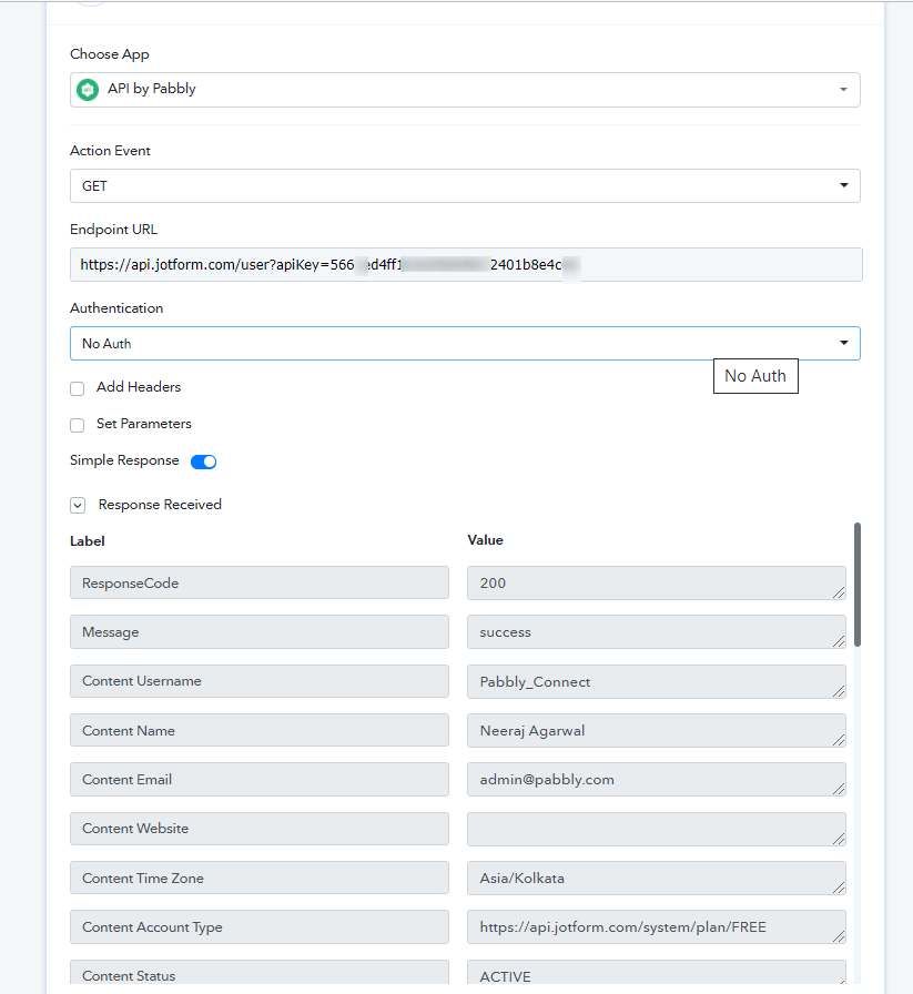

We have looked into your API action step of Jotform and the endpoint URL you have used in the 2nd step doesn't seem correct as we couldn't find it in their API.
Although we have tried the same at our end with their given endpoint URL and it is working fine. Kindly try the following URL with a new action event to make an API call of Get.

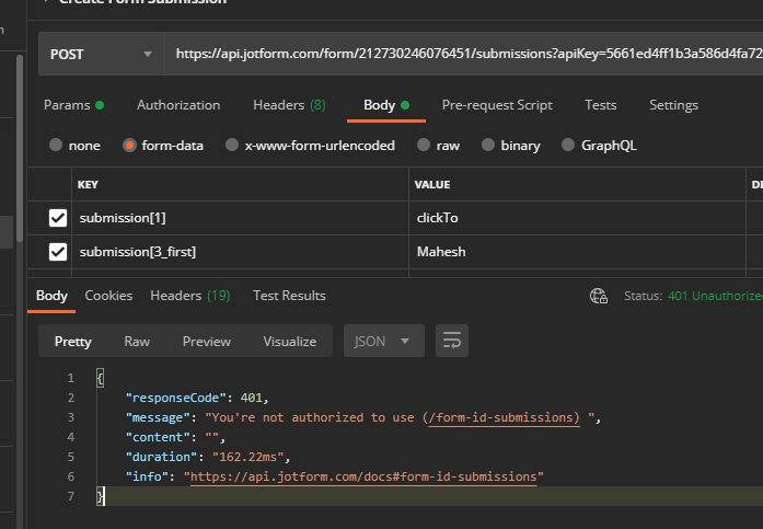

Referred API - https://api.jotform.com/docs/#post-form-id-submissions
Checked API call to post a submission on Postman-

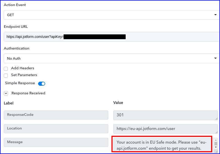

FYI, here's the reason about the 2nd endpoint URL I use to authenticate :

Kindly allow us some time to look over the reason. Seems it's associated with data server or GDPR restrictions.
