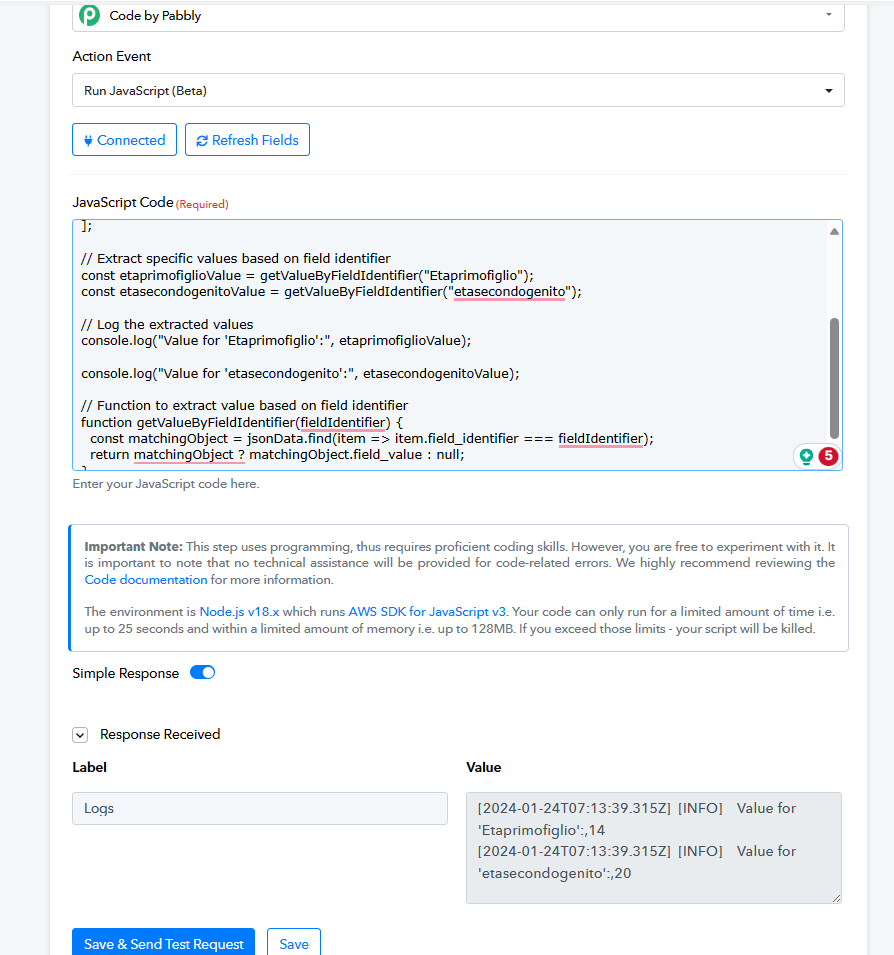

Sure, I understand your concern. To address this, you can leverage the "Code By Pabbly" action step. This step is designed to generate the desired response from the provided JSON to the specified numbers. It's an effective solution to achieve the outcome you're looking for.
const jsonData = [ {"field_id":"14","field_identifier":"Anno_nascita_tuo_figlio","field_type":"input_field","field_value":""}, {"field_id":"25","field_identifier":"Annonascitasecondofiglio","field_type":"input_field","field_value":""}, {"field_id":"23","field_identifier":"Cognomealtrogenitorepartecipa","field_type":"input_field","field_value":""}, {"field_id":"5","field_identifier":"EdizioneMICAP","field_type":"radio_button","field_value":[]}, {"field_id":"18","field_identifier":"Eta","field_type":"input_field","field_value":""}, {"field_id":"19","field_identifier":"Etaprimofiglio","field_type":"input_field","field_value":"14"}, {"field_id":"20","field_identifier":"etasecondogenito","field_type":"input_field","field_value":"20"}, // ... (other objects in the array) ]; // Extract specific values based on field identifier const etaprimofiglioValue = getValueByFieldIdentifier("Etaprimofiglio"); const etasecondogenitoValue = getValueByFieldIdentifier("etasecondogenito"); // Log the extracted values console.log("Value for 'Etaprimofiglio':", etaprimofiglioValue); console.log("Value for 'etasecondogenito':", etasecondogenitoValue); // Function to extract value based on field identifier function getValueByFieldIdentifier(fieldIdentifier) { const matchingObject = jsonData.find(item => item.field_identifier === fieldIdentifier); return matchingObject ? matchingObject.field_value : null; }
