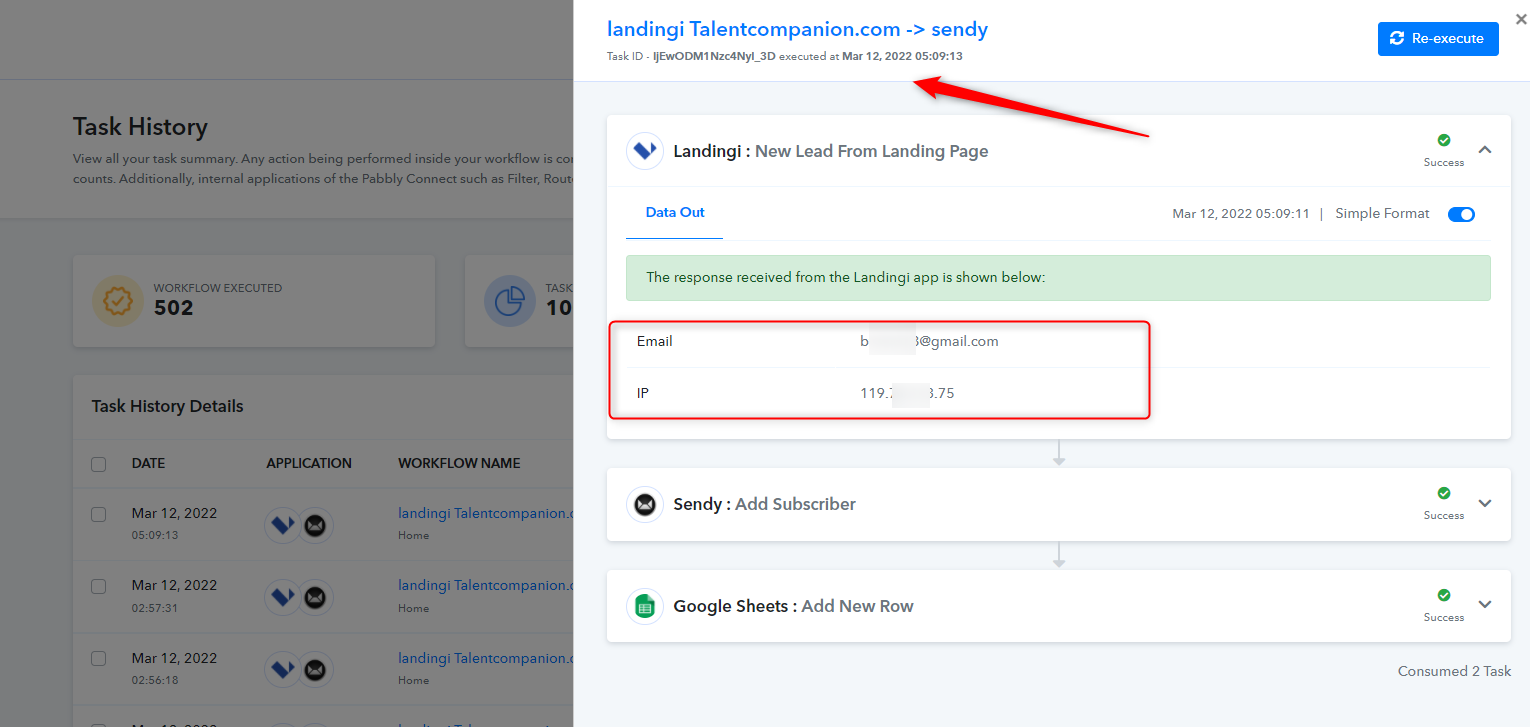

Hey @Dominic
As we can see in your workflow's history logs, your workflow is working accordingly and receiving the data properly from Landingi. Kindly check again and let us know if you get stuck at any sep.

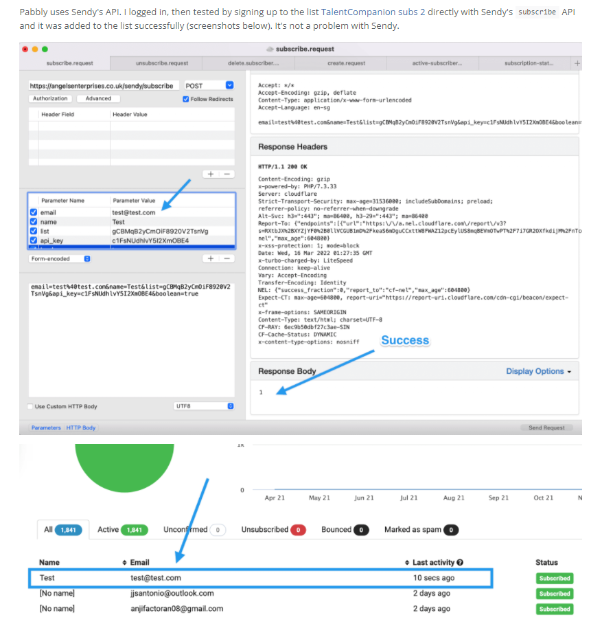

Update: I've contacted Sendy support and I've received such a response:
Therefore I believe the issue is on Pabbly side, the webhook still fails to add new subscribers, I have no clue what can be causing this.

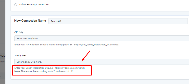

When checking upon your connection setup with Sendy inside the workflow, it seems that you have added the Installation URL with trailing slash.
Because of which you were getting the error.
Kindly add a new connection without trailing slash as mentioned in the helpdesk below the field-
Hope, this works for you now.
