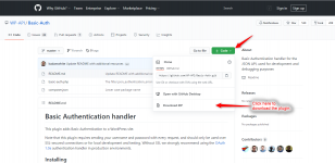

Step 1.
Download Basic Authentication handler plugin from here https://github.com/WP-API/Basic-Auth

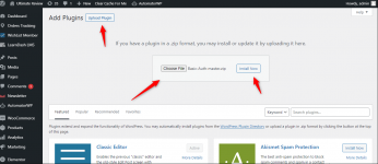

Step 2.
Upload Basic-Auth-master.zip in the WordPress site where you have installed LearnDash.
Step 3
Activate the plugin, and then click on re-authenticate the LearnDash integration In Pabbly Connect. It should work fine.

Step 1.
Step 2.
Step 3
