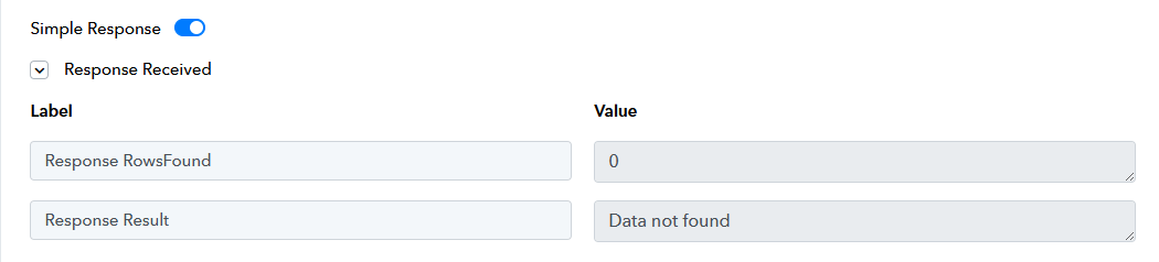

Now, I have the same product offered as a bump and upsell. I'm creating a new workflow but Trigger will be: Thrivecart - Bump Purchase. In the first Action: Google Sheets - Lookup Spreadsheet Rows V2 → I'm getting Data not Found
How do I resolve this? Here's the workflow which has the issue: https://connect.pabbly.com/workflow/mapping/IjU3NjYwNTZhMDYzMzA0MzI1MjY0NTUzMzUxMzAi_pc
I just tried with Trigger: Thrivecart - Upsell Purchase and I'm experiencing the same thing as well.

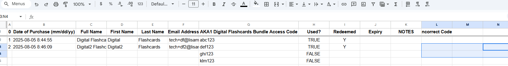

Upon checking the workflow, it appears that we’re receiving a “data not found” response. To help us investigate this further, could you please share a screenshot of your Google Sheet, specifically showing whether Column H contains the value “false”
This will help us better understand the issue and assist you accordingly.
lmotech — Reply ·
Column H has FALSE listed. So for the action, it will lookup the value "FALSE" then updates that row with Date, Name, Email, TRUE for USED. Then we would be passing the access code to GHL.

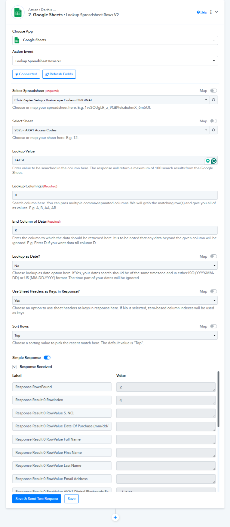

Hello @lmotech,
It appears that the issue was due to an extra space in the value "False" being added to the cells. I’ve removed the space, and the action is now retrieving the data correctly.
I recommend ensuring that the value "False" in Column H does not contain any leading or trailing spaces. This should resolve the issue moving forward.
Please refer to the attached image for better understanding. Let us know if you need further assistance.
