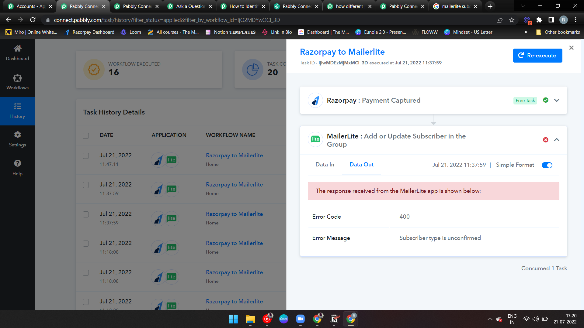

Hi, i am getting an error - workflow partially failed
Please help

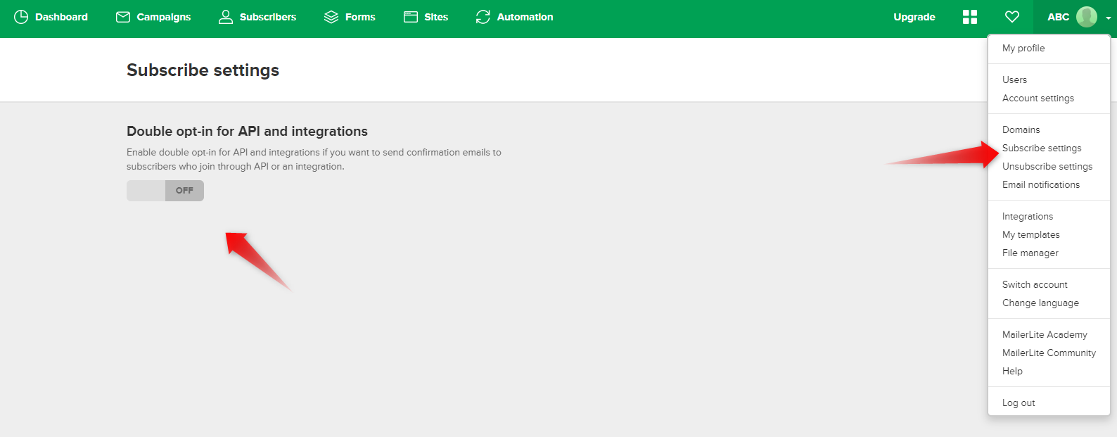

Can you confirm if you disabled the double optin for API and integrations , and then try adding contact from the workflow?

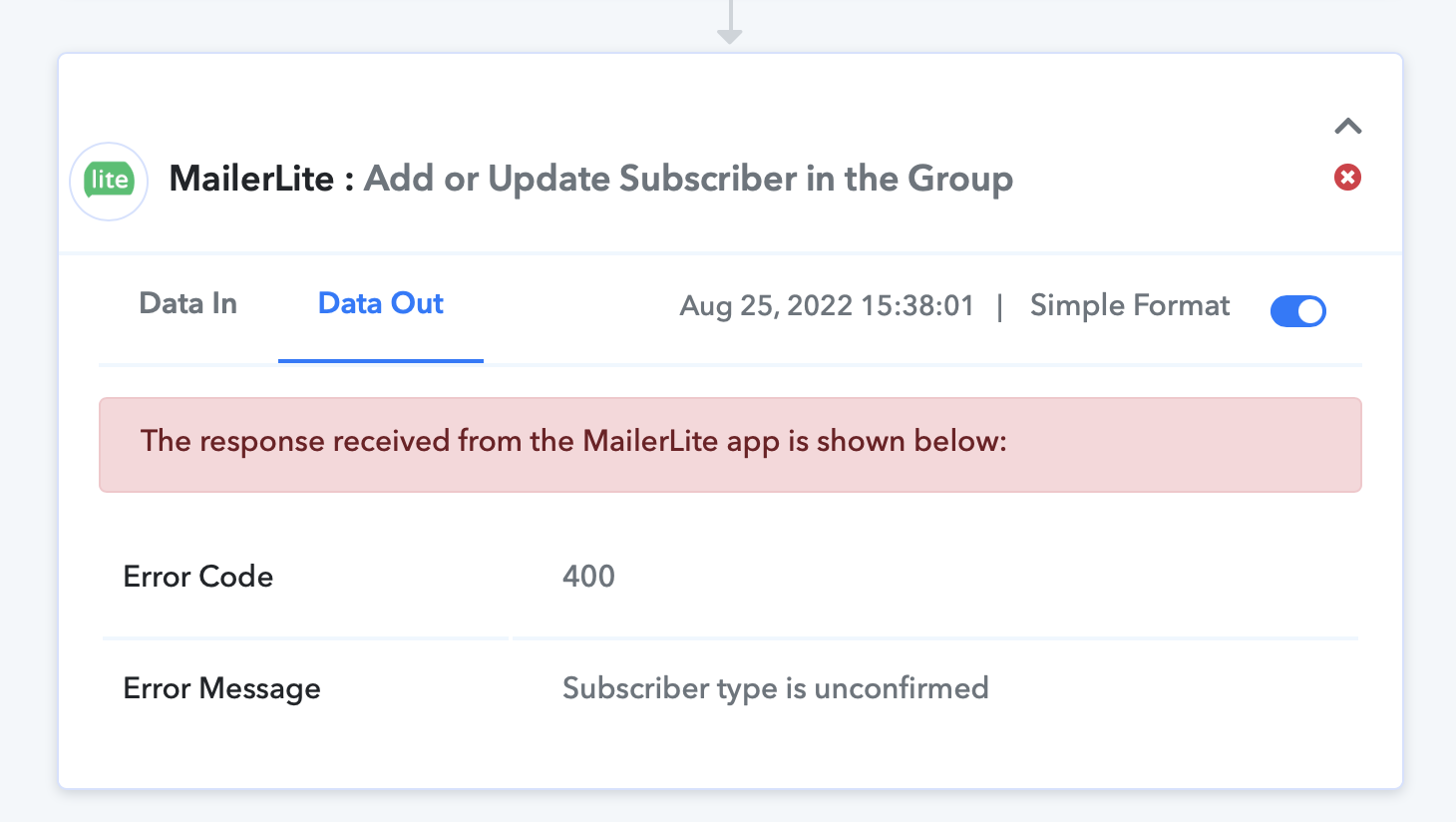

I'm seeing the same error with Mailerlite and the 'Double opt-in for API and integrations' was off before I created the workflow.
Re-executing the task results in the same error.
Do you have any recommendations?
Thanks,
Benjamin

Hey @Benjamin
Kindly check whether have you opted the for the Double Opt-in option or not. Seems like after disabling the option, the subscribers are getting into the list.
