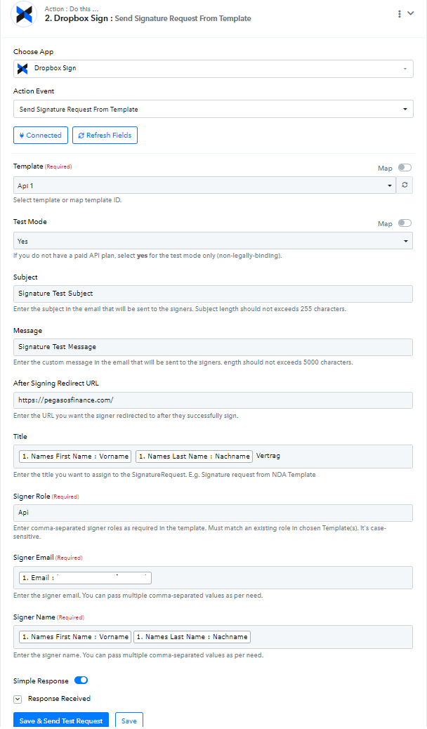

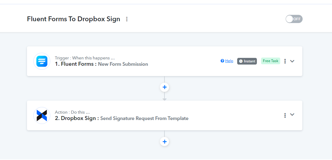

My pabbly integration:

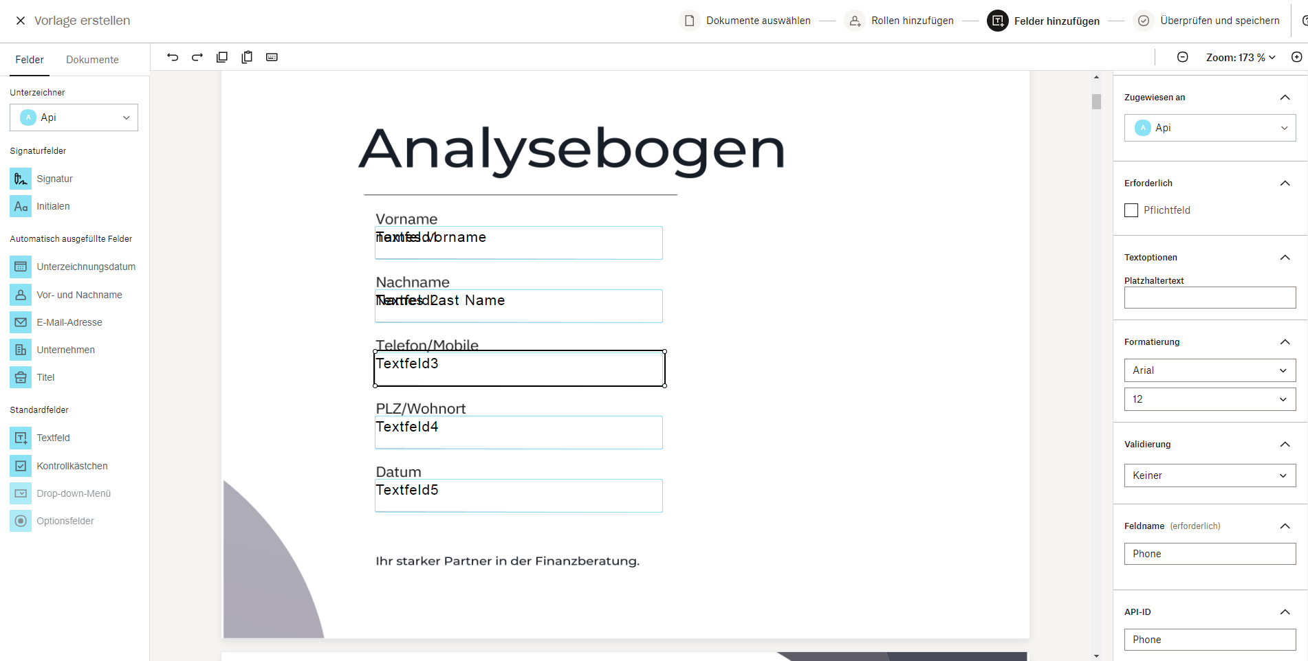

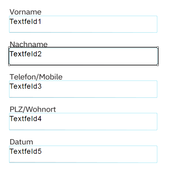

And here is my PDF template on Dropbox sign:
I have made the ID's the same for example for the phone everywhere, but it will be empty, once it sends out the PDF for signature.

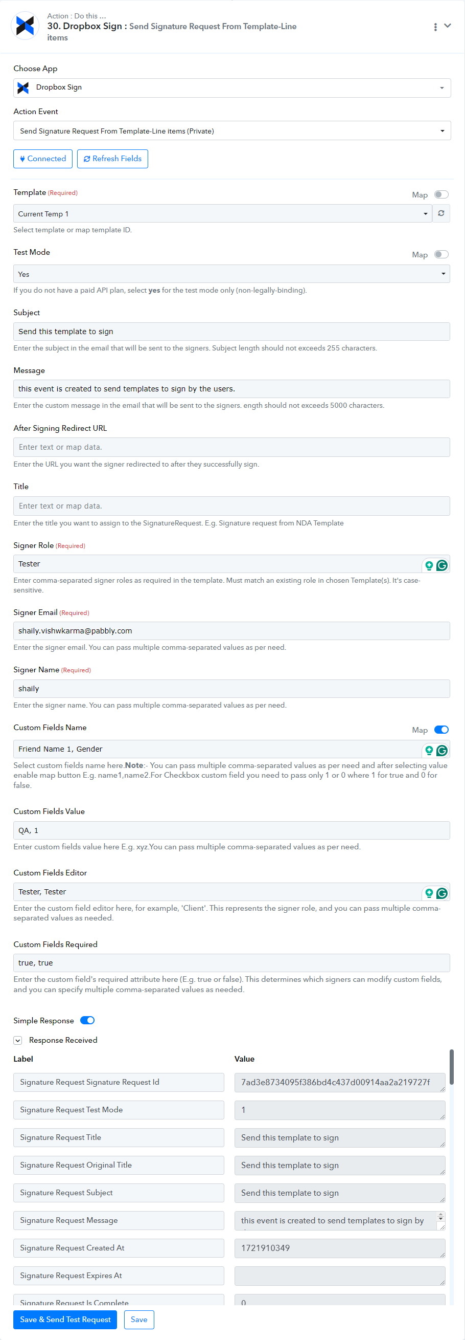

Hey @l.rozner
Our integration team has updated the 'Send Signature Request From Template-Line Items' action step, and the fields are now populating accordingly.
Please give it a try and let us know if it works for you.
