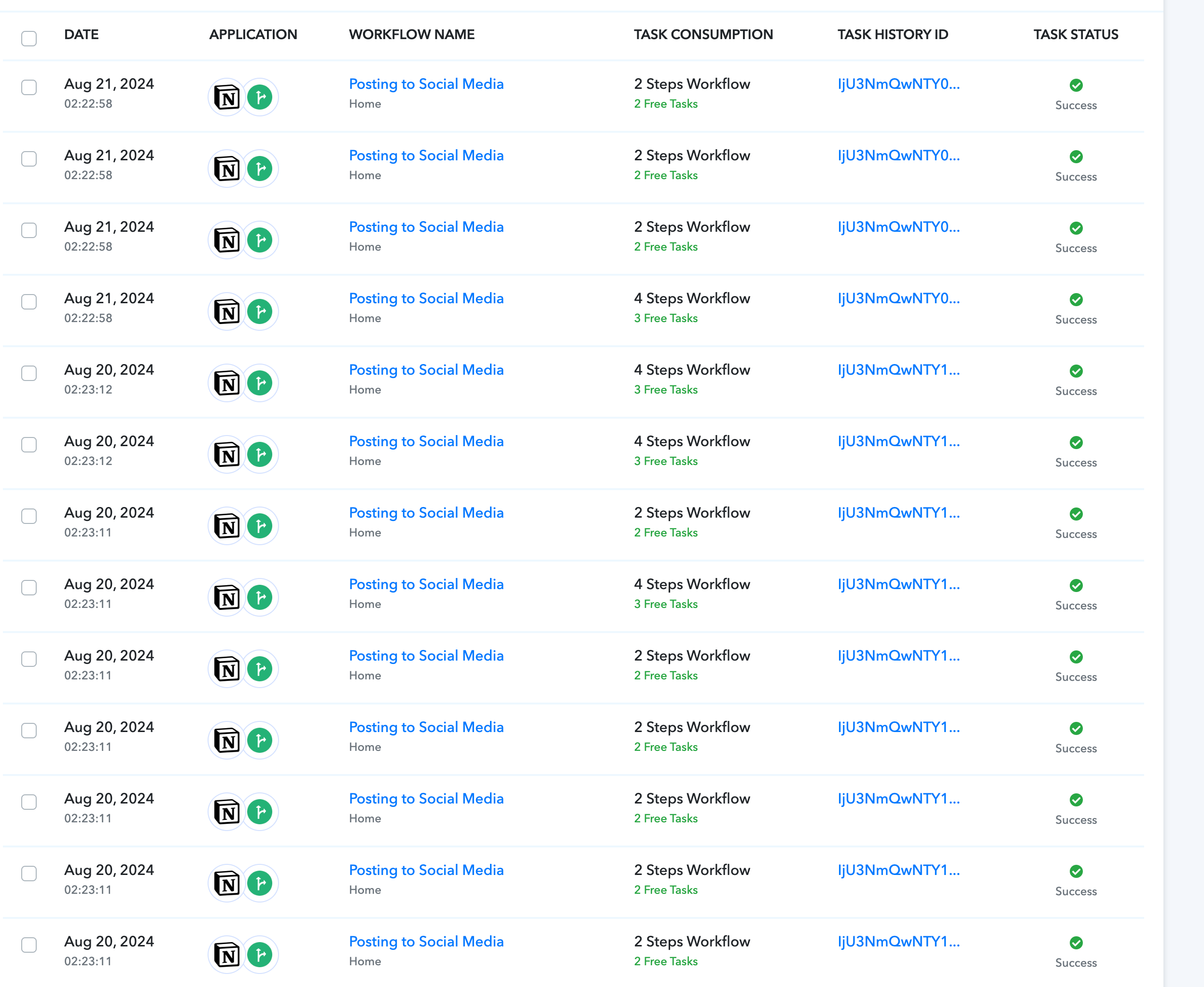

At least, something is happening since Aug 20. Please see screenshot. I do not know which task history you would need to check, but I'd be grateful for any help to get this running.

Hey @Rea Dreamlandpaper
Can you please share the workflow URL once in which you have tried it?
Hey @Rea DreamlandpaperCan you please share the workflow URL once in which you have tried it?
Hey @Supreme
This is the last one - the one on top of my screenshot in first posting.
This includes only 2 steps
IjU3NmQwNTY0MDYzNzA0Mzc1MjZhNTUzNTUxMzQ1MTYxNTQzMiI_3D_pc
(Executed at Aug 21, 2024 02:22:58, (UTC+02:00) Europe/Zurich)

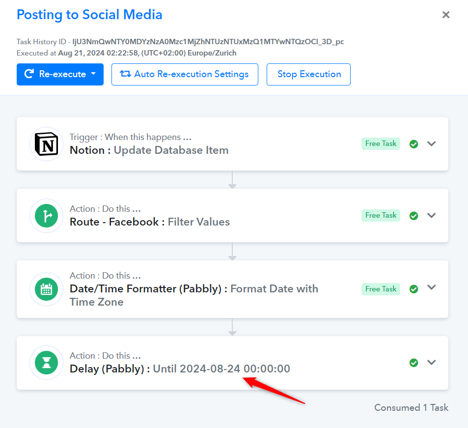

and this is the forth down the list and includes 4 steps
IjU3NmQwNTY0MDYzNzA0Mzc1MjZhNTUzNTUxMzQ1MTYwNTQzOCI_3D_pc

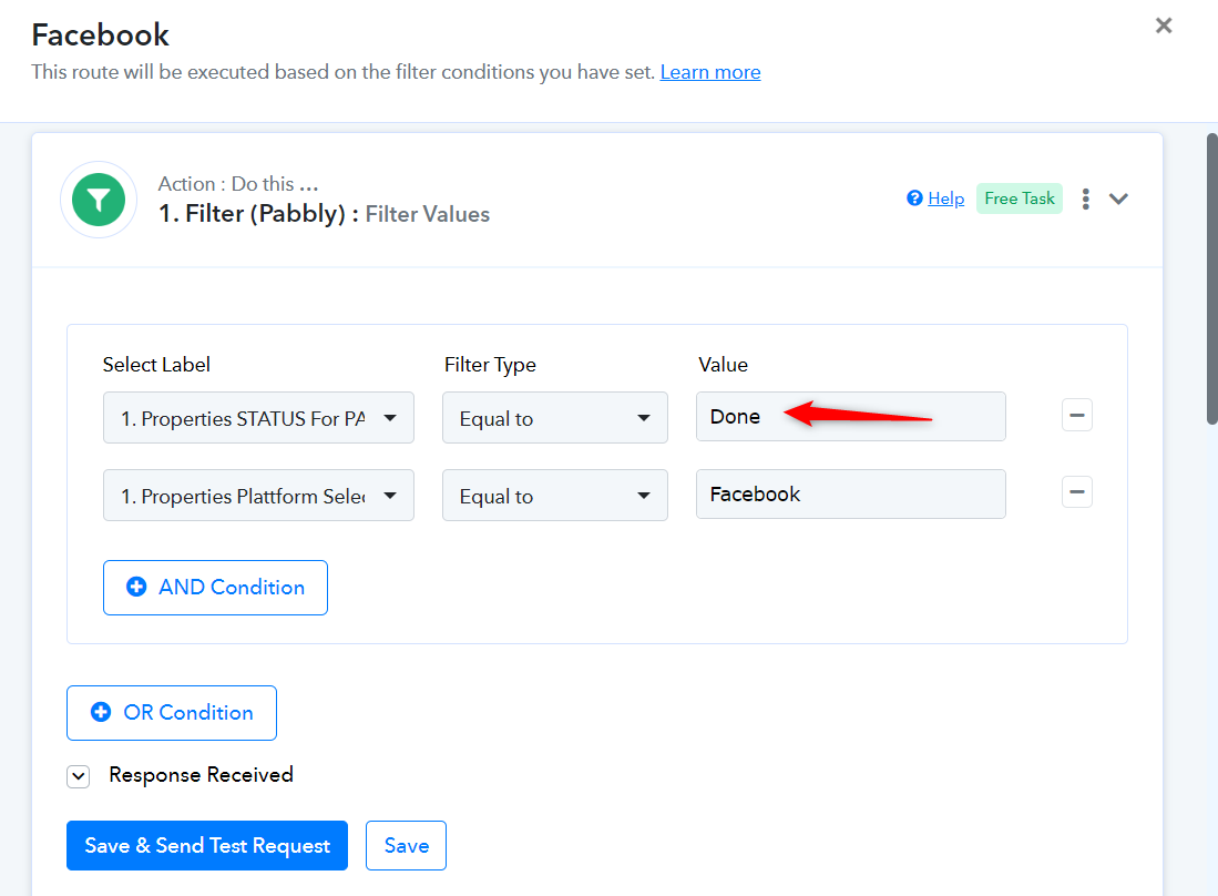

Hey @Supreme
This is the last one - the one on top of my screenshot in first posting.This includes only 2 steps

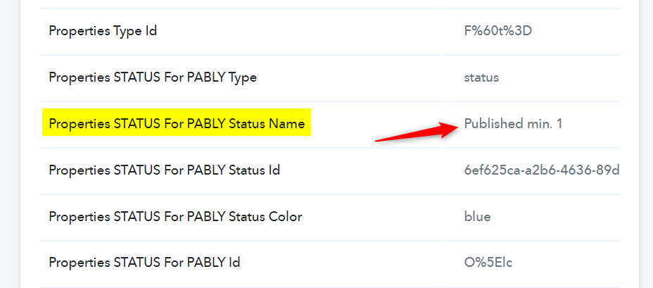

You have set up a filter condition in your router to execute the next steps only if the 'Properties STATUS for Pabbly Status Name' is equal to 'Done'.
Based on your task history, we can see that the response captured from Notion had a different status, which did not meet the filter conditions and therefore the next steps didn't get executed.
You have a Delay step in your workflow that will prevent this post from being made on Facebook until August 24th, 2024, at 12:00 AM UTC.

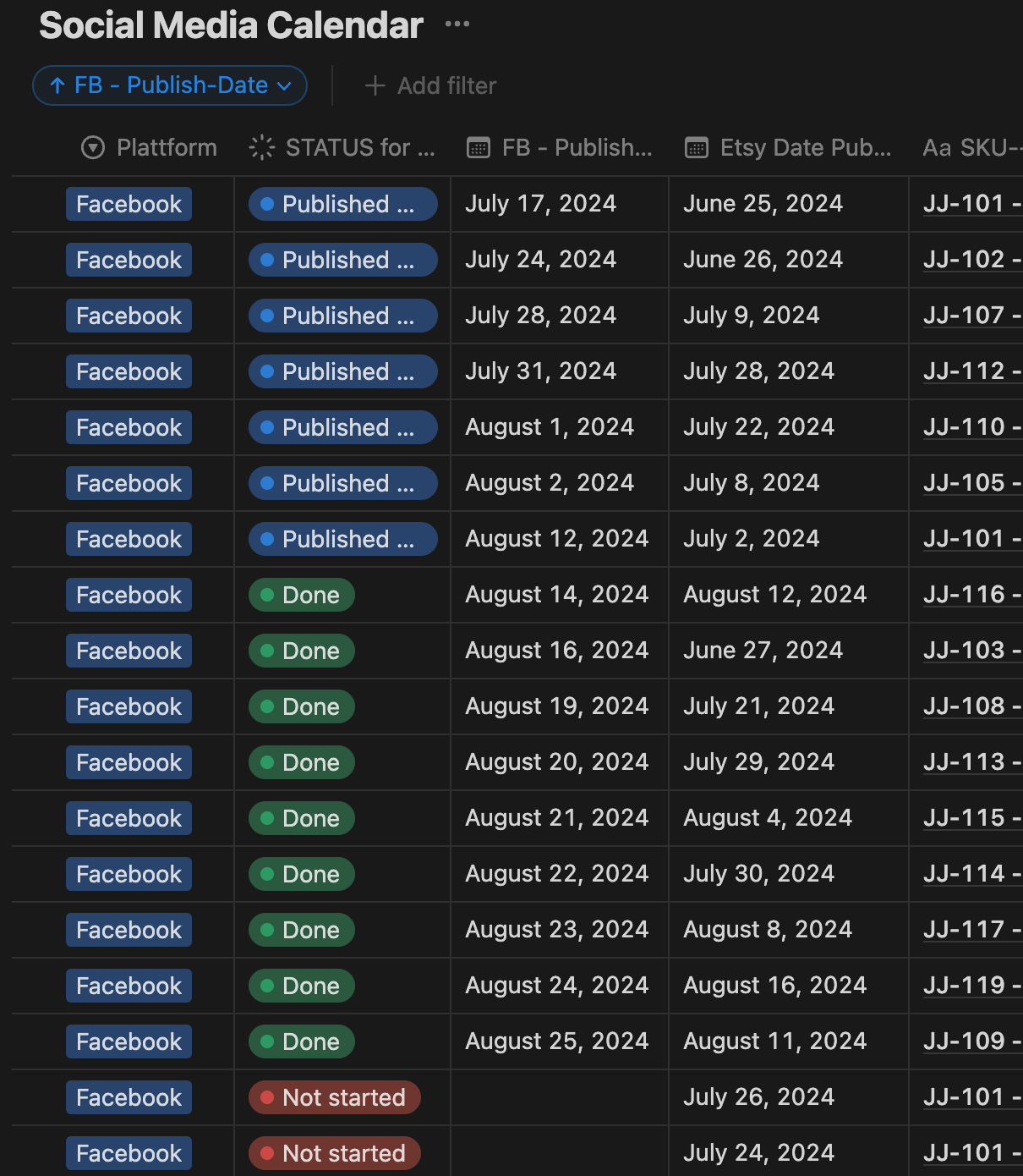

Thank you. The delay is not the problem. It is ok and is set according to the video.
Yes, the status captured from Notion is different than the set to done in the filter. BUT if the time moves forward it should have captured the ones marked with done. See for the dates of 19 and 20 August.
No, that's not how it works. When you change the status to 'Done,' a separate task will be created that will pass the filter step. An already executed task will not change over time.

I reference the field where the status is shown. In the screenshot it did not show done, but reference the correct field.
