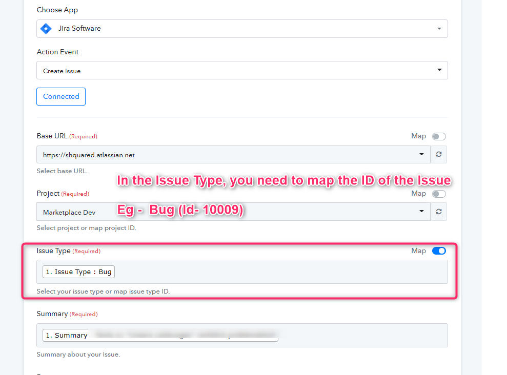

Hey @FraSHQ
While looking into the Jira's action step, you have mapped the name of the Issue Type where you need to map the Id of the Issue instead, and because of that JSON of action breaks.
Kindly pass the Id of the Issue type in the action event.
