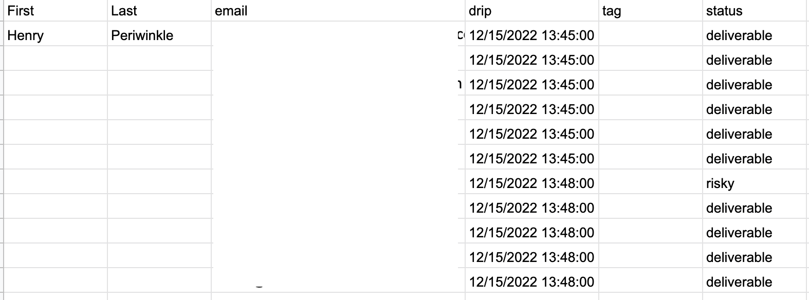

Date format in Drip column in GSheets:

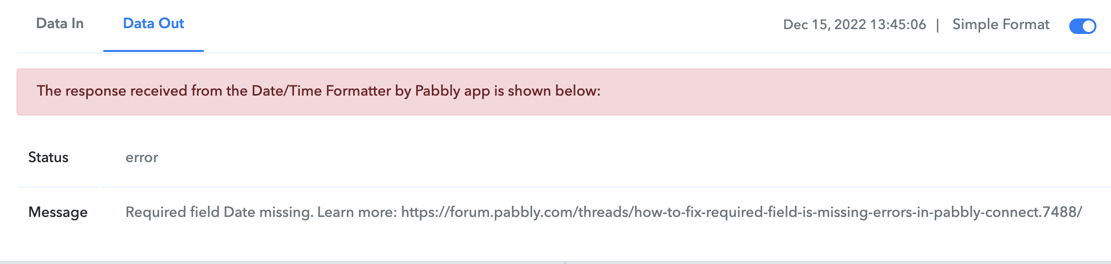

Error message #1 on execution of Date/Time formatter task:

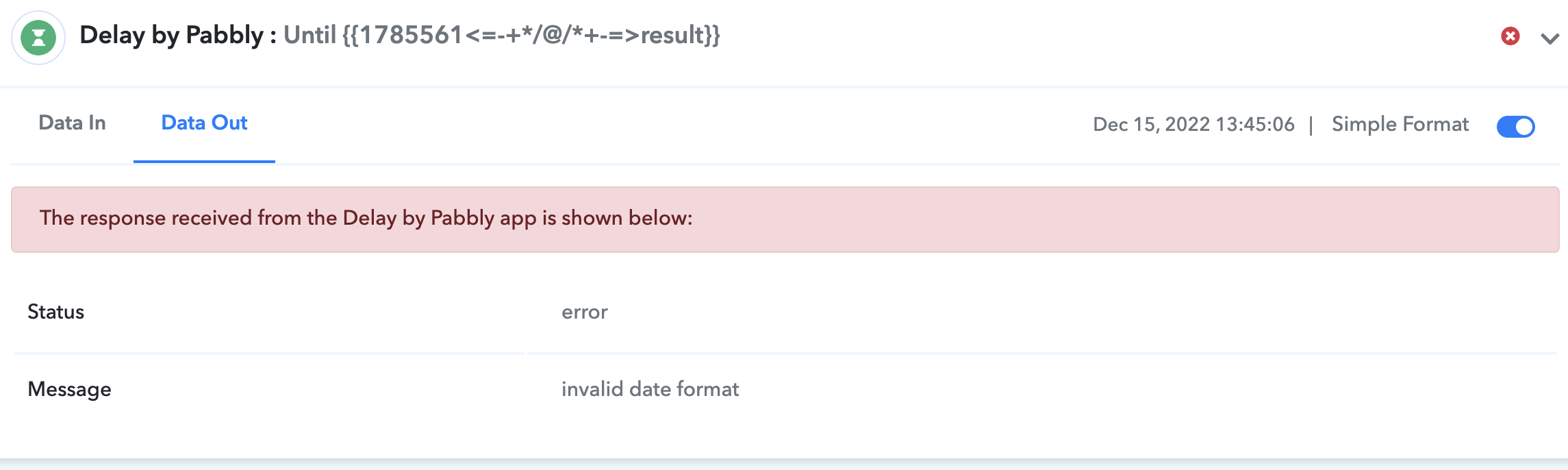

Error Message #2 when executing "Delay Until" right after:

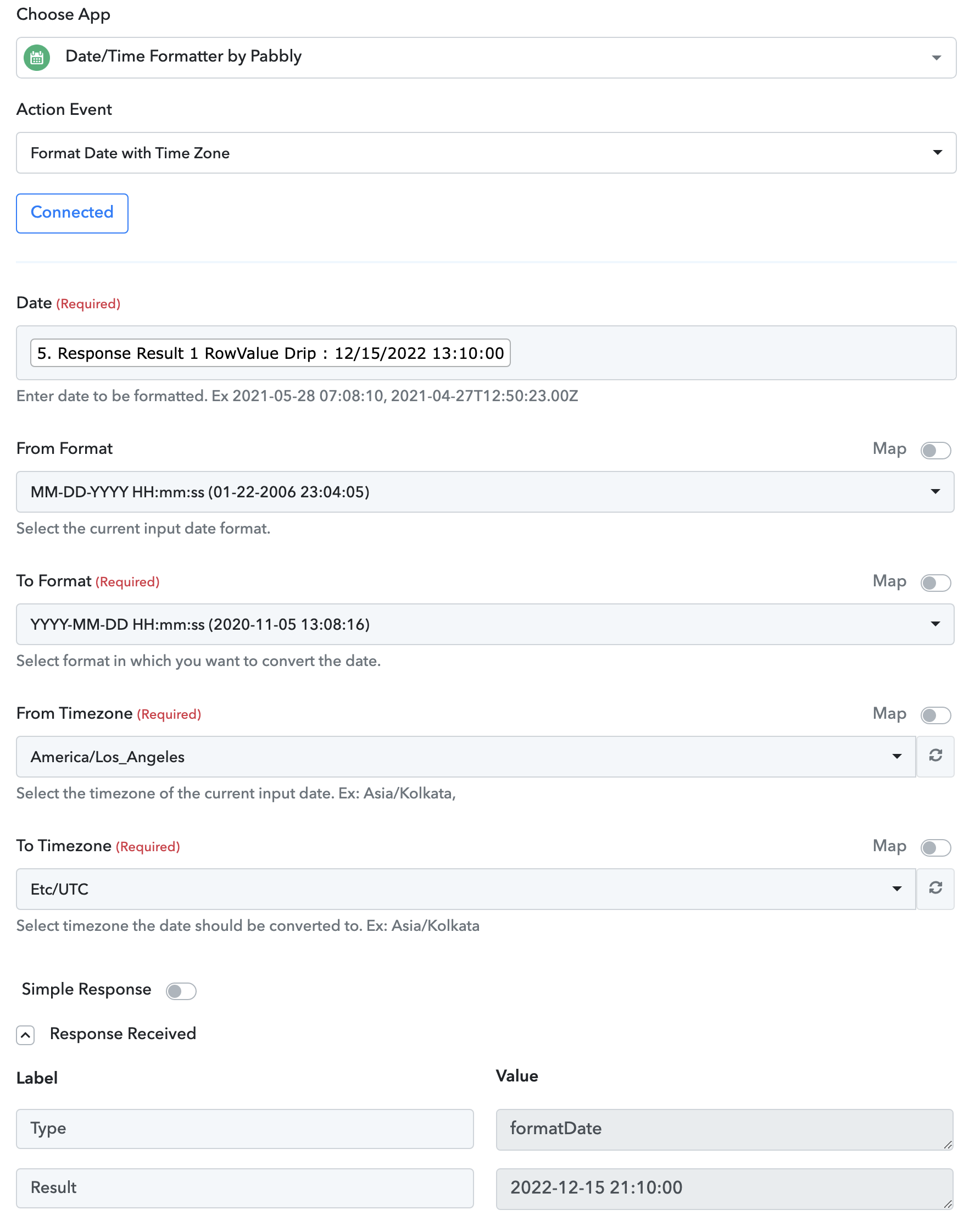

Workflow Setup - Date Formatter success:

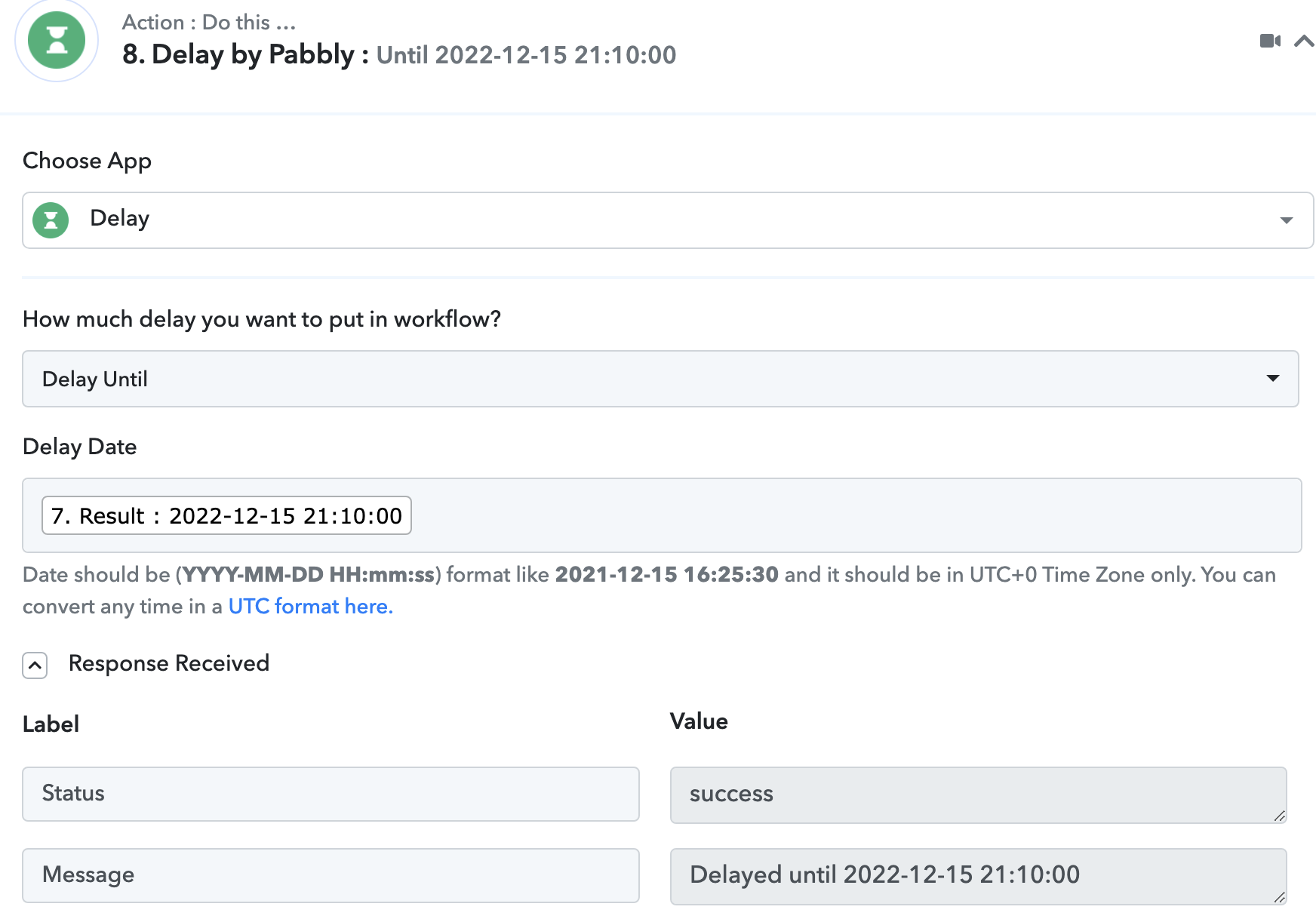

Pabbly "Delay Until" time with formatted date success:

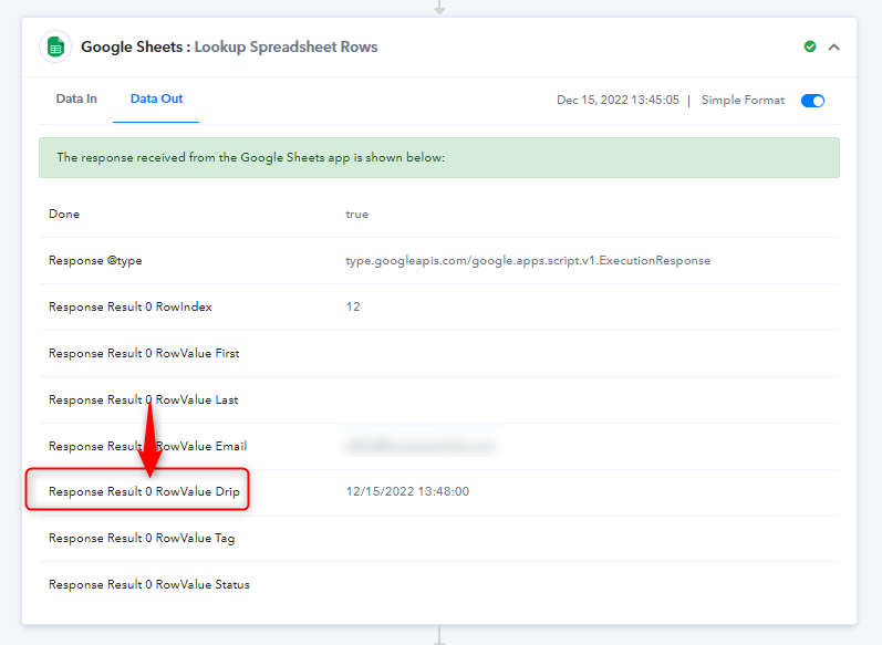

Hey @Birchstone Advisors
As we can see from your workflow, the Date Label which you have mapped and the Date Label which actually contains the Date to process the data further are different.
Though we have corrected the mapping for you accordingly, so now kindly give it a try.
