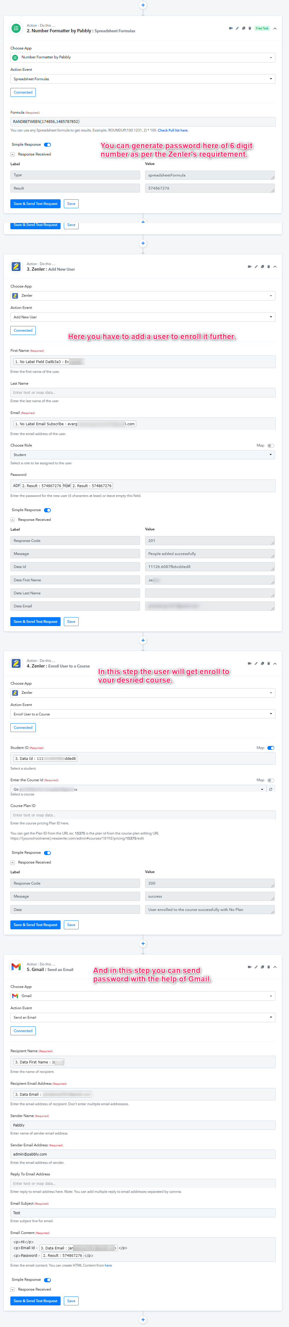

Hey @larrys
First - DO I have to first make an action to make the person a "USER" with a "STUDENT" role in Zenler, as in the ThriveCart video? Is this so I can give them a password?
To enroll a user in a particular course you might need to add a user in your Zenler then only you can add it later.
How do I send them the login info / temporary password so they can immediately access the course when they make the payment in ClickFunnels?
The teacher in the video said there is a way to email the person right from inside Pabbly, but he did not show how to do it. How do I do this?
For this, you can check out the following screenshot and also shared a workflow with you so that you can copy the steps from there, for better understanding -
Kindly try this at your end and let us know if that works for you.
Workflow - https://connect.pabbly.com/workflow/share/CEBQYlYRAypUHwdDDk1UNwAXAwBVHwdRVDMHFQ##
